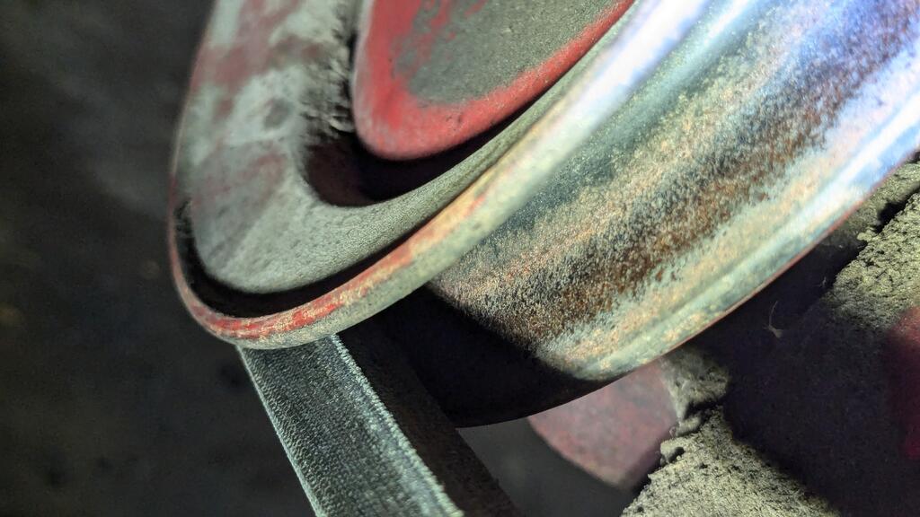

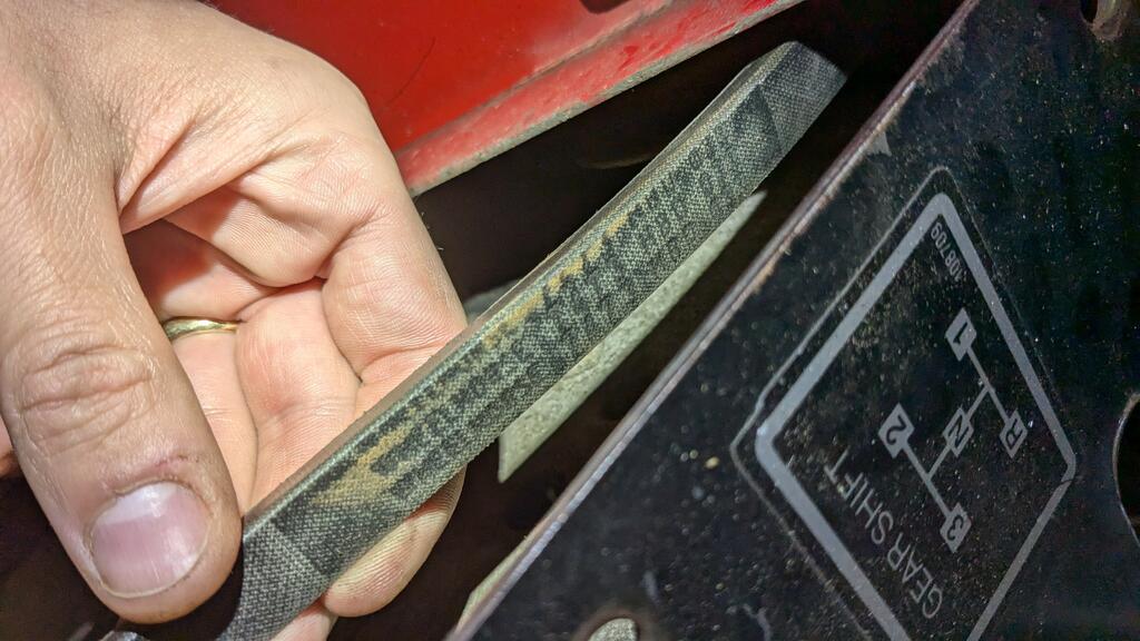

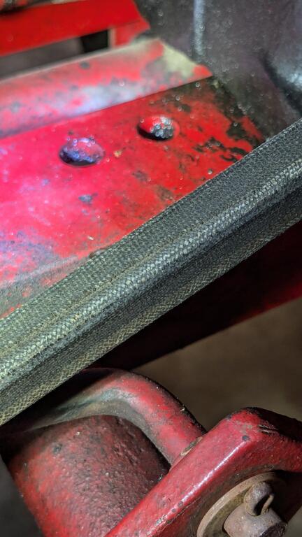

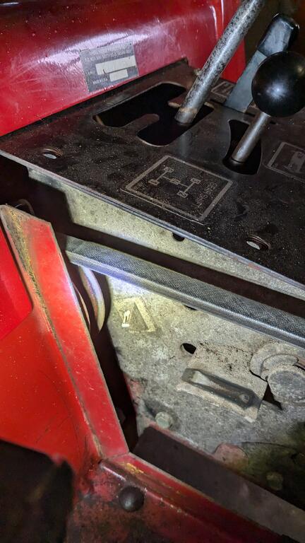

Alrashid2 476 #6 Posted November 22, 2024 (edited) Pictures as promised. Maybe the pulley surfaces are a bit too rusty? I'm thinking maybe I can get in there, remove the belt one pulley at a time, take some Scotch Brite and "sand' the pulley surfaces down, then clean them with brake cleaner? I thought I saw a post here about wiping mineral spirits on the belt too... Does this belt look appropriate? I have read there are different versions but no idea how to decipher. No more lettering/part# on this one. Edited November 22, 2024 by Alrashid2 Belt photos Share this post Link to post Share on other sites

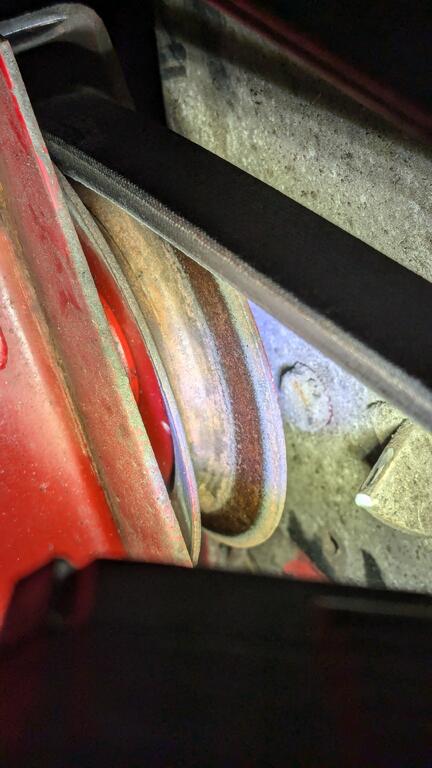

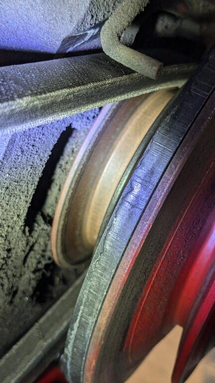

Alrashid2 476 #7 Posted November 22, 2024 (edited) Needed another post due to image size limit Sorry I don't know the exact nominclature - let me know what these pulleys are actually called! Pic 1: crankshaft pulley Pic 2: clutch pulley Pic 3: transmission pulley Edited November 22, 2024 by Alrashid2 Share this post Link to post Share on other sites
ebinmaine 80,408 #8 Posted November 22, 2024 Your nomenclature is doing just fine. There are ways to reduce the size of the images but I don't know what they are. You can also solve that by becoming a supporter. Best 20 bucks you'll spend this year. Those pulleys could be cleaner but I've seen much worse. Couple things come to mind. When you let the clutch out what is your engine RPM? Is there perhaps some sort of worn out component like a gas cylinder or idler bearing? 1 1 Share this post Link to post Share on other sites

stevasaurus 23,808 #10 Posted November 22, 2024 Remove belt guard. Push in clutch and remove belt. Sand, Scotchbrite, clean all rust in pulleys and then wipe with mineral spirits. Do not soak the belt, but use mineral spirits to clean belt. It's hard to tell, but it looks like you may have the cloth covered belt. If not, get one...I hear they have them at Tractor Supply. @gwest_ca can help you with the correct size. Replace belt and guard. The guard is your clutch and must be mounted to funnel slack in the belt toward the drive pulley. To minimize wheelies, start out in as low RPMs as possible. You can clean the pulleys in place. DO NOT USE BRAKE CLEANER ON ANYTHING EXCEPT BRAKE PARTS AND PADS. 1 Share this post Link to post Share on other sites

ebinmaine 80,408 #12 Posted November 22, 2024 The belt you have doesn't look too bad and it's an original Wheel Horse belt. Remove that and verify condition before you spend money on a new aftermarket. Might be perfectly fine. 2 Share this post Link to post Share on other sites
stevasaurus 23,808 #13 Posted November 22, 2024 To actually remove the belt...you can bend that guide enough to get your belt off the idler pulley, just bend it back into position when you put the belt back on. The input pulley on the trans is held on by an Allen Head Set Screw with a Woodruff key in the input shaft. You have to open the PTO linkage ot get the belt off the drive pulley. I would leave the drive pulley alone and on the engine, they come off, but not easily and you can damage that pulley. Just clean it good and mineral spirit it. 1 Share this post Link to post Share on other sites
