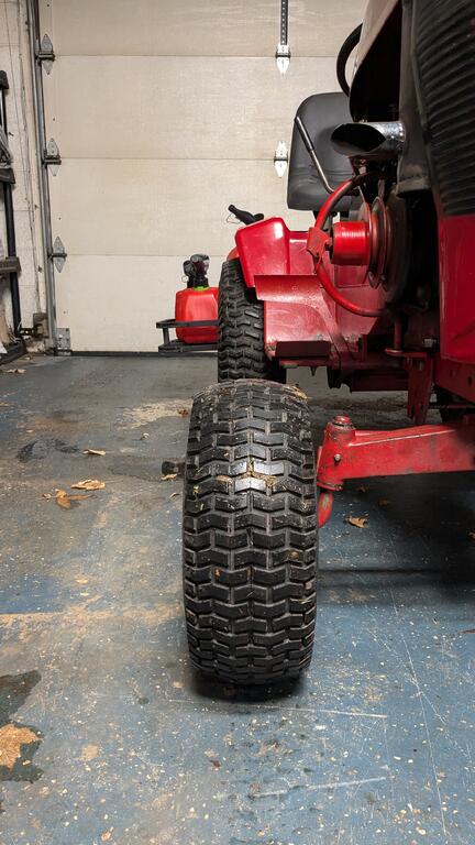

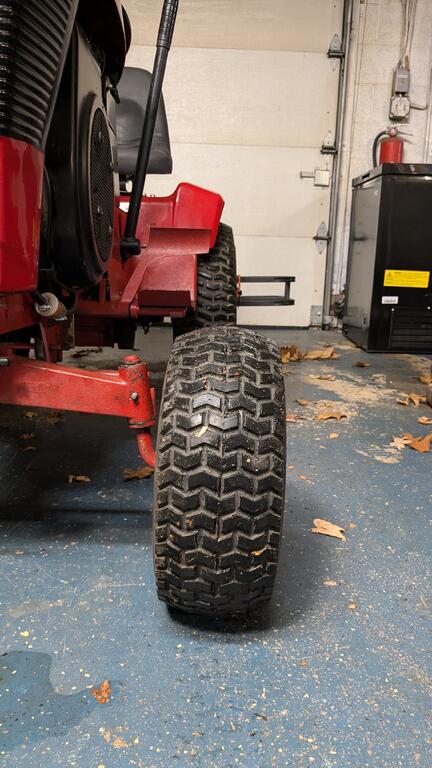

Alrashid2 382 #1 Posted November 22, 2024 Hey guys. Noticed today that the front left wheel has some pretty bad camber. Top is angled outward, bottom angled inward. Right tire looks fine. Hard to capture in a picture but I got two photos here showing the right wheel lines up square with the rear wheel while the left tire is obviously canted. I know toe is adjustable on these. But is camber? Only thing I could see would be somehow removing that piece of the front axle and bending it in a vise with a hammer, but that makes me nervous... Lot of trial and error too. What do you guys think? Thanks! Share this post Link to post Share on other sites

kpinnc 13,702 #4 Posted November 22, 2024 I would check your wheel bearings. Other than that, you probably have a slightly bent steering knuckle. Pretty easy to source another one. …But if you’re tough enough to bend it in a vise- even with a hammer, I never want to meet you on the street! 3 1 Share this post Link to post Share on other sites

ri702bill 8,951 #6 Posted November 22, 2024 Do raise the front axle & remove both wheel assemblies. Look for worn out bearings and worn thru spindles - rather common. 2 Share this post Link to post Share on other sites
Lee1977 7,028 #7 Posted November 23, 2024 If the wheel bearings haven't been changed it needs some new ones. As said above worn spindles are common if it hasn't been greased regularly. While you are there even with good bearings and spindles it need shim washers to the the wheel doesn't move on the spindle. 1 Share this post Link to post Share on other sites
Pullstart 64,463 #8 Posted November 23, 2024 That is surely some positive camber. Unless gravity has changed, I can’t see worn components working the wheel that direction. I’m with @pfrederi. Ignore it. I’m also for making sure the rest of the front axle parts are tight, but I just can’t see wheel bearings or a worn spindle making it head positive. 1 Share this post Link to post Share on other sites

ri702bill 8,951 #10 Posted November 24, 2024 On 11/23/2024 at 9:42 AM, Pullstart said: but I just can’t see wheel bearings or a worn spindle making it head positive. Kev - my 854 had a bent RF spindle when I got it - must have spanked a curb - positive camber!! The "Parts Department" coughed up a suitable replacement. There was a visable difference in angle between the two... Share this post Link to post Share on other sites
Pullstart 64,463 #11 Posted November 24, 2024 1 minute ago, ri702bill said: Kev - my 854 had a bent RF spindle when I got it - must have spanked a curb - positive camber!! The "Parts Department" coughed up a suitable replacement. There was a visable difference in angle between the two... I agree. Bent part vs. worn part. Gravity always wins, and the wheel and tire would have a negative camber ALWAYS with worn components. 1 Share this post Link to post Share on other sites

Alrashid2 382 #15 Posted November 25, 2024 All makes sense to me. I wonder if that spot in my garage might be a bit sloped too. I noticed when I parked it in the shed, the camber issue wasn't nearly as evident. I also drove through some mud and when I drove over a bit of dry concrete, the tread marks left from both front wheels looked even... so makes me think the tire is sitting squarely. Will keep an eye on her! Share this post Link to post Share on other sites
kpinnc 13,702 #16 Posted November 26, 2024 10 hours ago, Alrashid2 said: All makes sense to me. I wonder if that spot in my garage might be a bit sloped too. I noticed when I parked it in the shed, the camber issue wasn't nearly as evident. I also drove through some mud and when I drove over a bit of dry concrete, the tread marks left from both front wheels looked even... so makes me think the tire is sitting squarely. Will keep an eye on her! I would pull that wheel and make sure you don’t have a groove worn into the underside of the spindle. It can be welded up and ground back round. 1 1 Share this post Link to post Share on other sites
