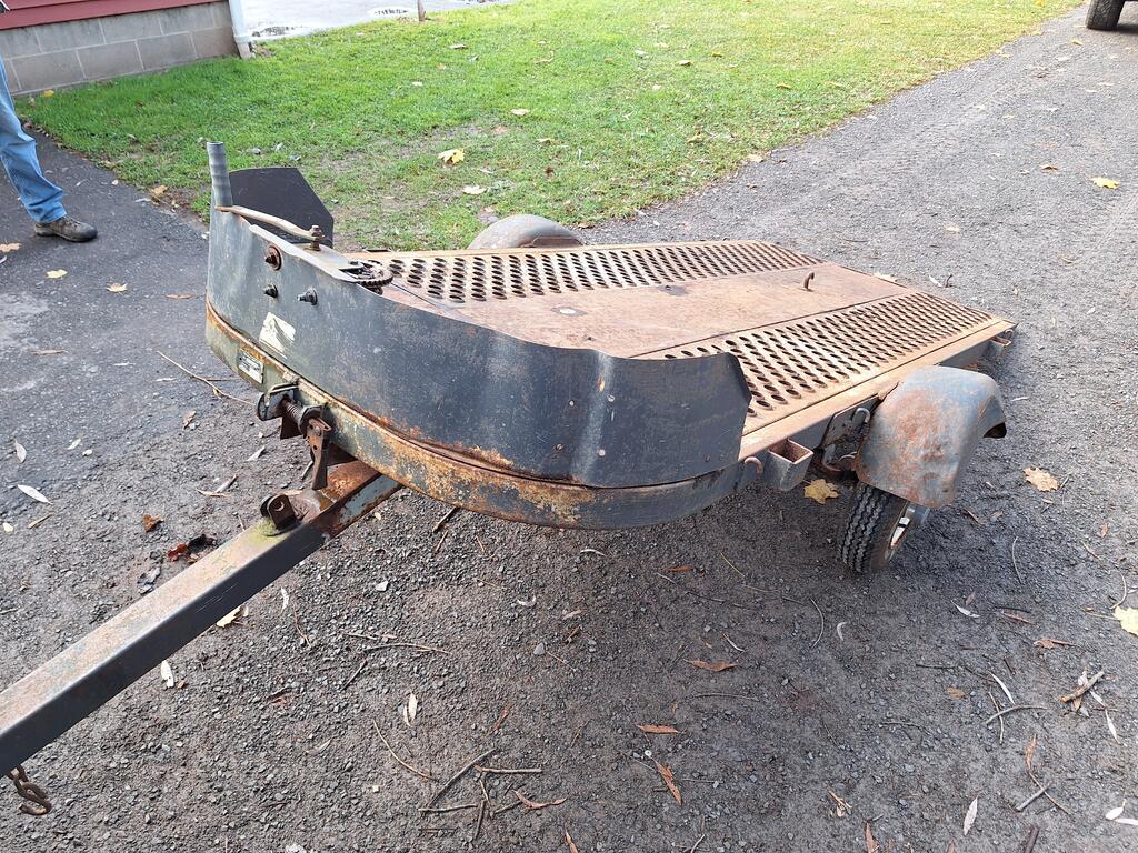

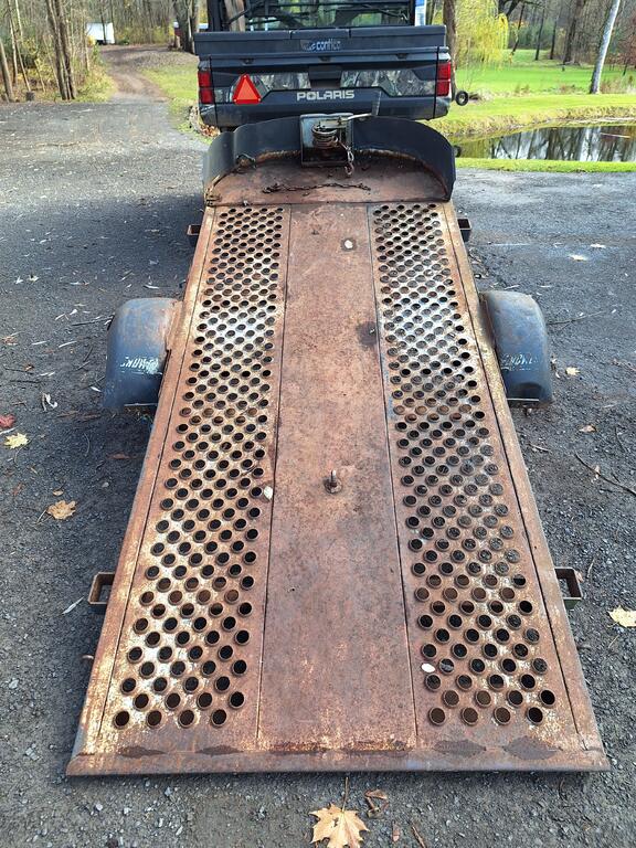

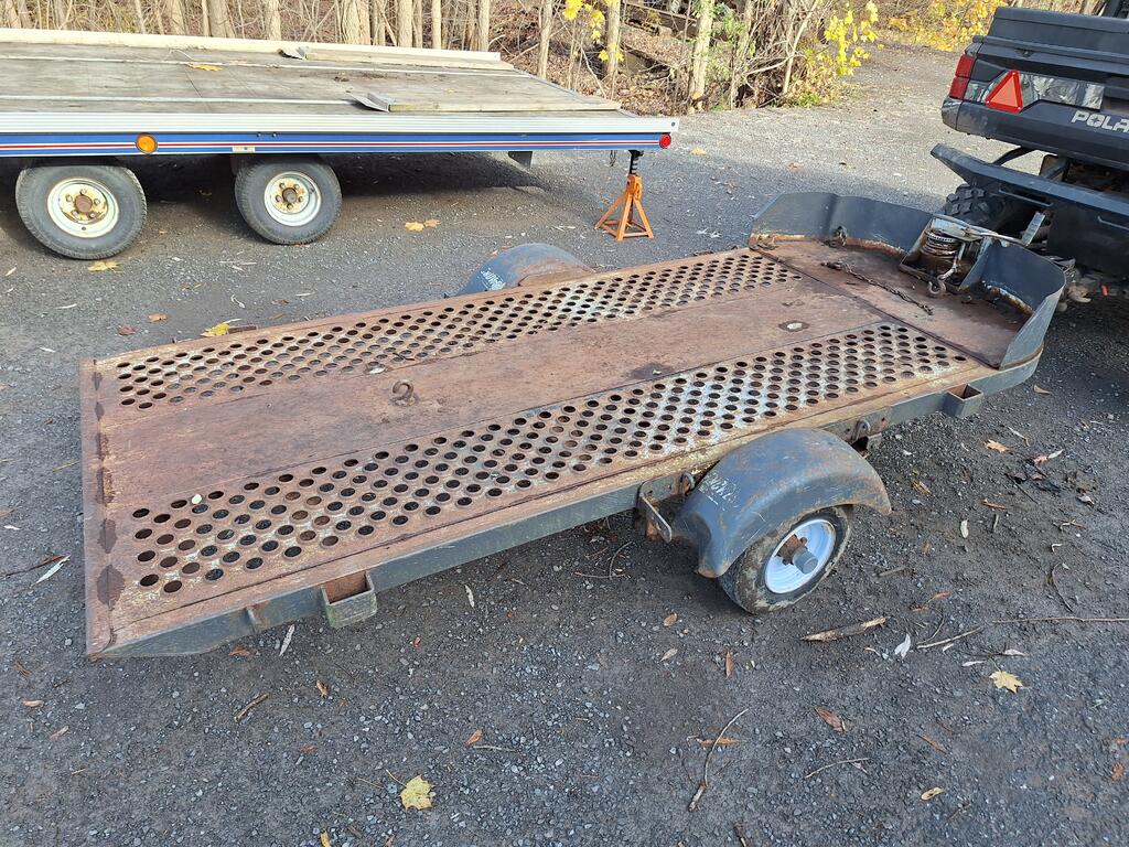

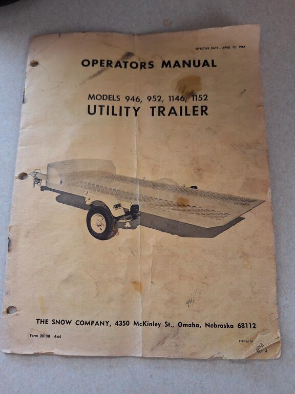

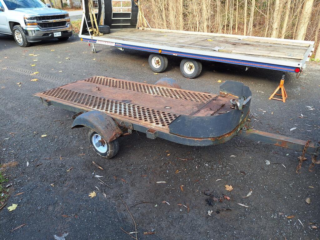

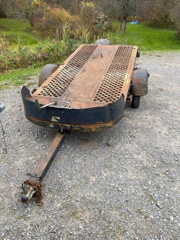

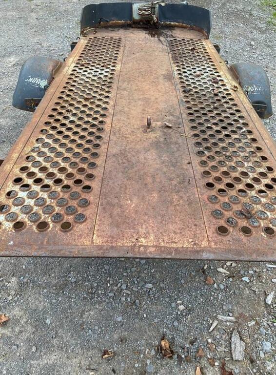

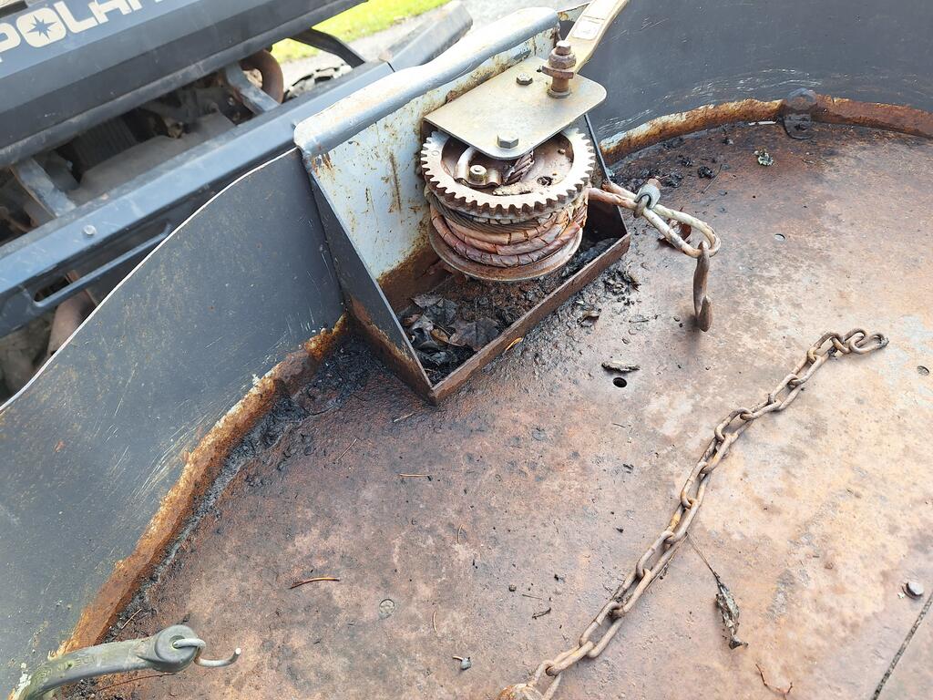

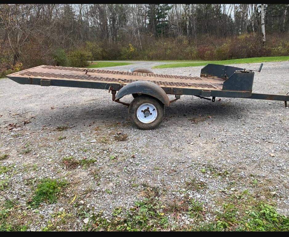

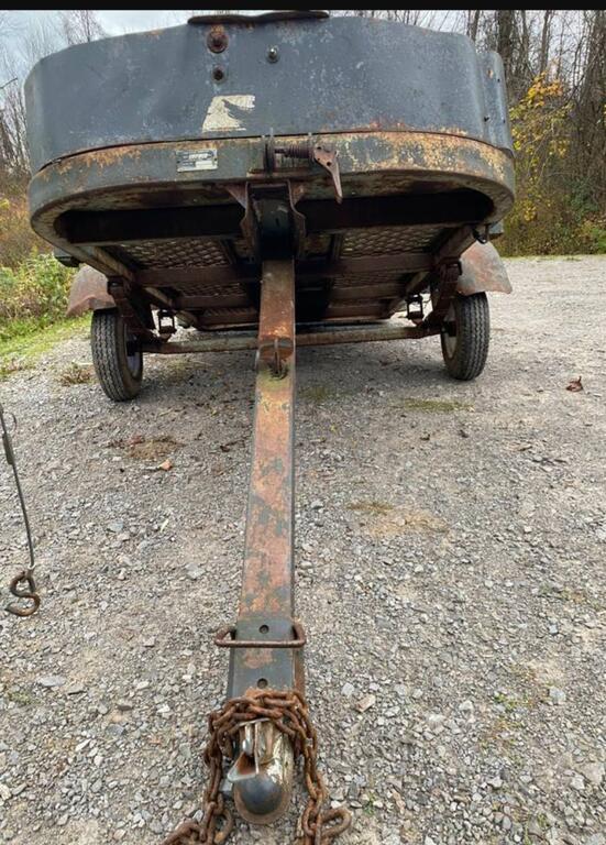

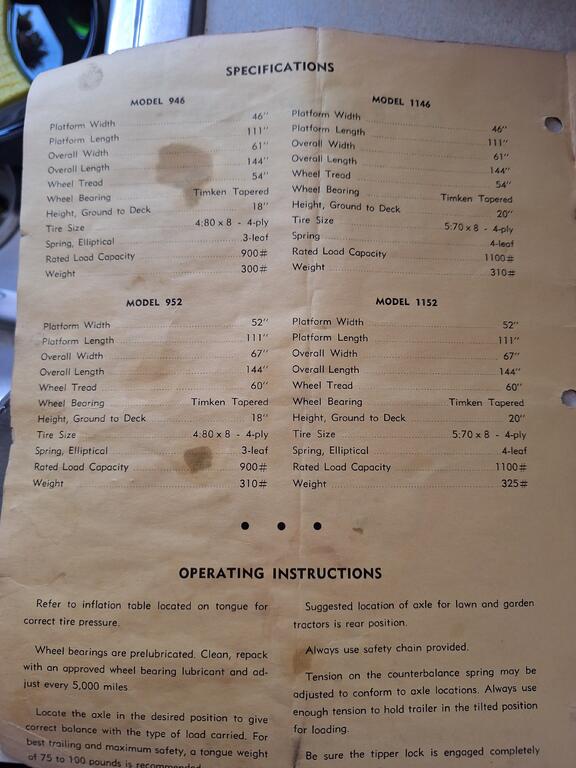

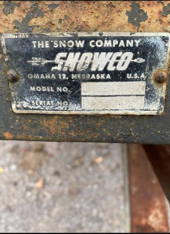

D_Mac 9,041 #1 Posted November 21, 2024 (edited) Soooooo..... picked this up this morning. Kinda excited about it but also asking myself if I really need it. I need to learn to ask if I need it and not ask do I want it. It is a one owner 946 Snowco with original operators manual. Little rusty but not rotted. Fenders are the worst part of it. They are dented up pretty good. Has a hand winch up front, splash or gravel guard, non-skid decking all original. The previous owners purchased it new in 1965 when they bought a JD garden tractor from a dealer. Thank God it wasn't painted green and yellow. The cool factor on these little trailers are off the chart. Tilt bed just drive right up. So after buying it I have no way of getting home. My truck has no hitch. Call a friend who is a little leary of hooking it up because of the whole there's no lights or plate on it. We wind up taking it to a friend of his that was like a mile away. Him and I worked out a deal where as he is going to rewire it, install new LED lights and replace the cable on the winch for a reasonable price. I will get it from his place next week. Not sure what my plans for it will be. If I lean towards keeping it I would have to put a hitch on my truck. It sits pretty low so I'm not sure if just putting a ball on my bumper would do the trick. May just pass it on, I dunno. I could picture it painted up to match your favorite tractor color scheme. That's what these things were built for. Be a hit at the Big Show ! Edited November 21, 2024 by D_Mac 6 6 Share this post Link to post Share on other sites

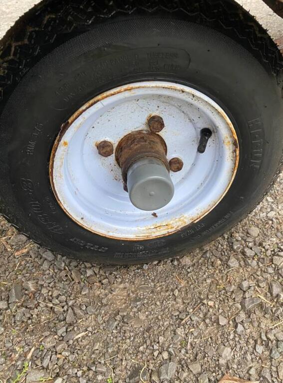

D_Mac 9,041 #6 Posted November 21, 2024 (edited) On 11/21/2024 at 10:17 PM, c-series don said: I believe this is one of them in the brochure? Sure looks like one ! I am not sure about the hubcap. There are bearing buddies on now that stick out some. Seems like you need one Don. Edited November 21, 2024 by D_Mac 1 Share this post Link to post Share on other sites

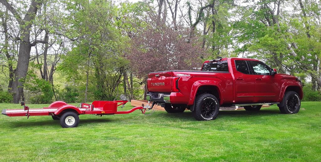

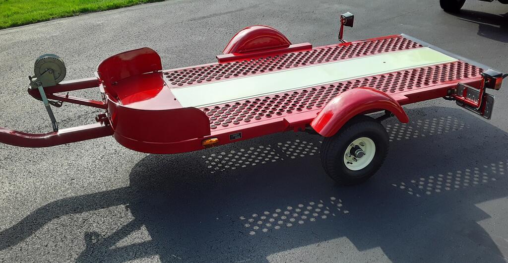

76c12091520h 3,750 #7 Posted November 22, 2024 Maybe some photos will provide a little inspiration for you. Served my father well for over 40 years , and it's mine now and not going anywhere anytime soon. This trailer hauled every Wheel Horse that we sold or serviced. He bought it used and always said it was the best $100 bucks he ever spent 3 9 2 Share this post Link to post Share on other sites
D_Mac 9,041 #8 Posted November 22, 2024 (edited) @76c12091520h Looks beautiful. Like I said not sure what my plans for it are yet. I just knew I had to get it. I also paid more then 100 for mine ! As of right now I can't even hook it up to my truck. What is that piece that runs across the width of the bed to stop the tractor from rolling ? Is that custom or an original piece ? Edited November 22, 2024 by D_Mac Share this post Link to post Share on other sites
Achto 28,613 #9 Posted November 23, 2024 On 11/21/2024 at 10:21 PM, D_Mac said: There are bearing buddies on now that stick out some. Great looking trailer !!! My general belief in Bearing Buddies on a used trailer. These tell me that the last time a bearing service was done was never. I have trailers with Bearing Buddies, but I still like to pull the bearings out every other year & do a compete inspection / service. 3 2 1 Share this post Link to post Share on other sites
Marv 963 #11 Posted November 24, 2024 On 11/22/2024 at 2:57 AM, 76c12091520h said: Maybe some photos will provide a little inspiration for you. Served my father well for over 40 years , and it's mine now and not going anywhere anytime soon. This trailer hauled every Wheel Horse that we sold or serviced. He bought it used and always said it was the best $100 bucks he ever spent Nice. Mine didn't look that good when it was new. Marv 2 Share this post Link to post Share on other sites

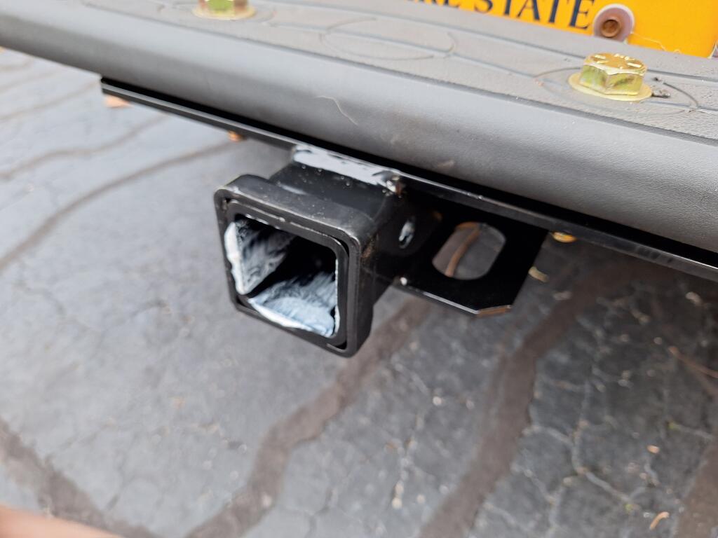

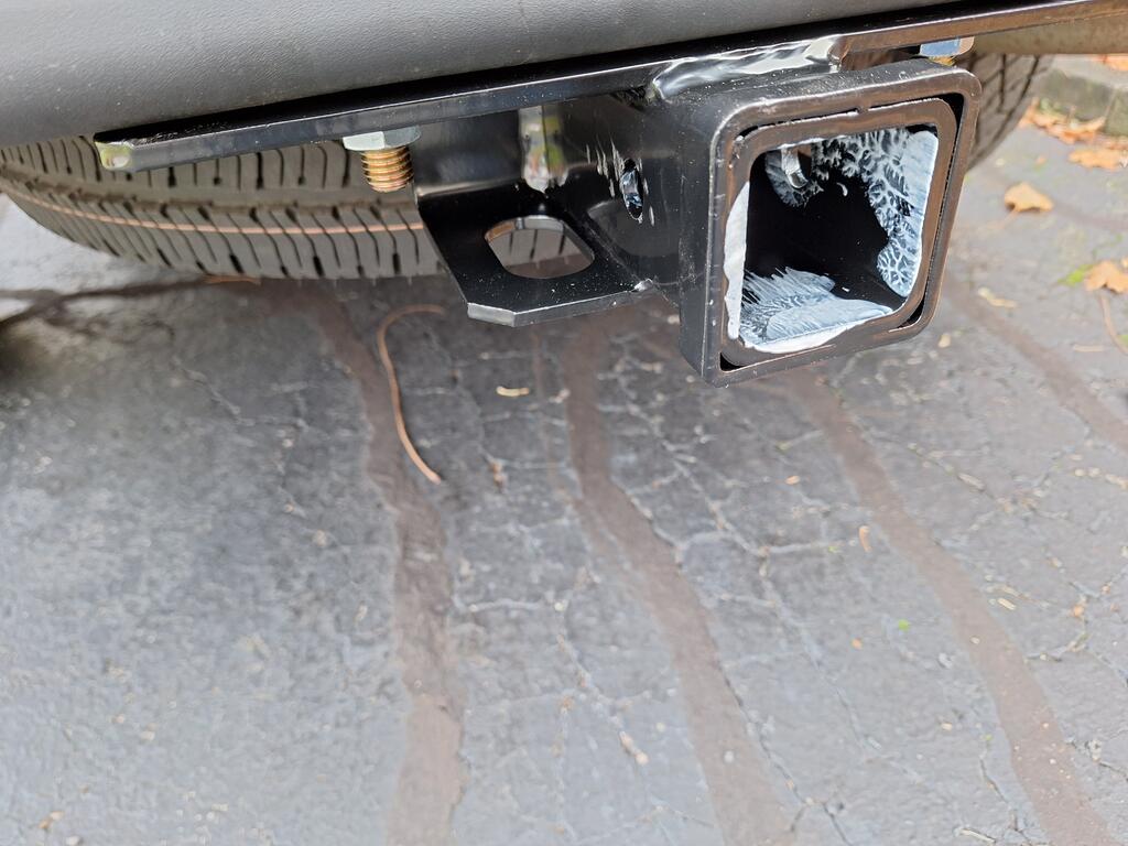

D_Mac 9,041 #18 Posted November 25, 2024 Well put the hitch on the bumper of my truck. Should be ok. Don't plan on loading that trailer to the limit. I used grade 8 bolts. Waiting on the wiring kit to come in the mail then I will be ready to bring it home when it's done. I will register it after the new year. 2 Share this post Link to post Share on other sites
SylvanLakeWH 27,243 #19 Posted November 25, 2024 Curious: Is that hitch spec for that type of bumper application? Hard to tell from the pictures but the bolts look a lot lighter than mine...? Are there only two bolts? Share this post Link to post Share on other sites
D_Mac 9,041 #20 Posted November 25, 2024 No it's universal. Mounts under the bumper where a ball would go. 2 bolts. 5/8 × 3 inch. Like I said it should be good enough for what I will need. 1 Share this post Link to post Share on other sites

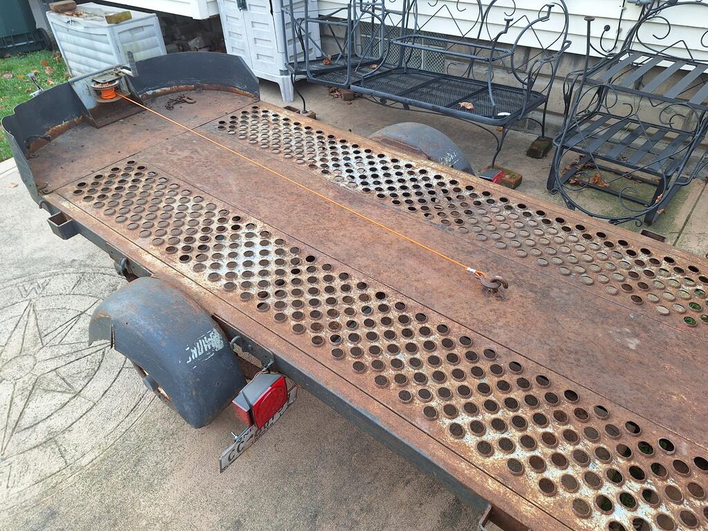

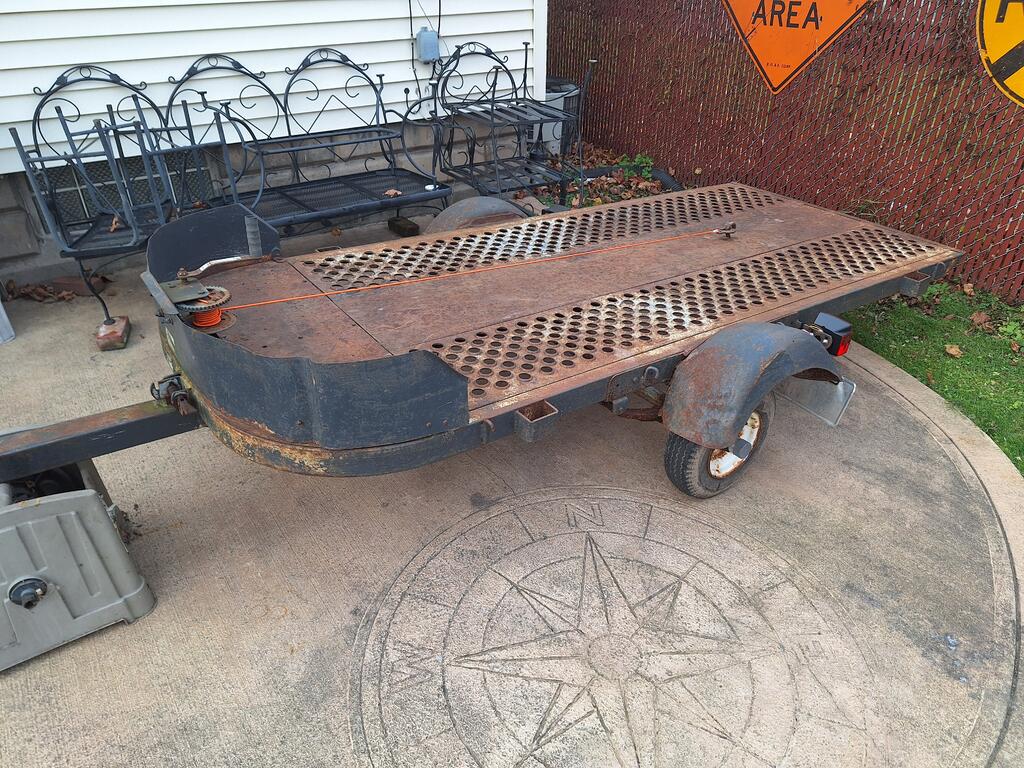

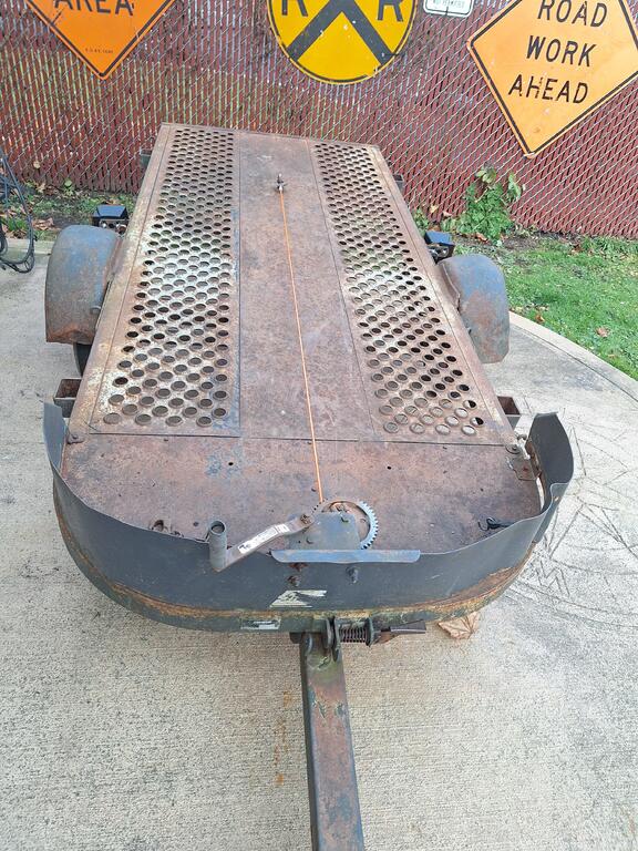

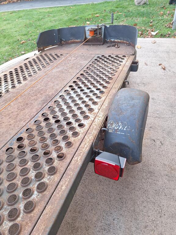

D_Mac 9,041 #21 Posted November 27, 2024 (edited) Trailer might be ready today for pick up. Keep you all posted. Well it's home. Lights are installed and it has a new cable for the winch. First time I got a chance to take a good look at it. Needs some loving but the main thing is that it's complete and sold. Going to have my cousin come take a look. He is a jack of all trades. Not sure if the fenders can be saved or need replacing. Other then that, toss some paint on it and say it's finished. Edited November 27, 2024 by D_Mac 3 Share this post Link to post Share on other sites

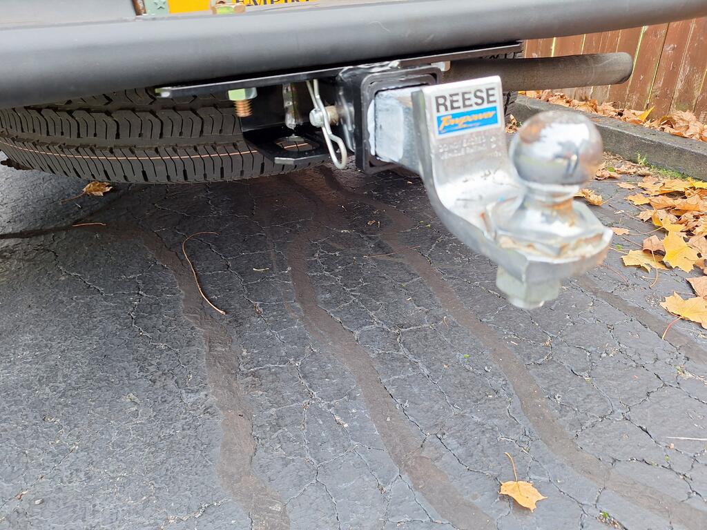

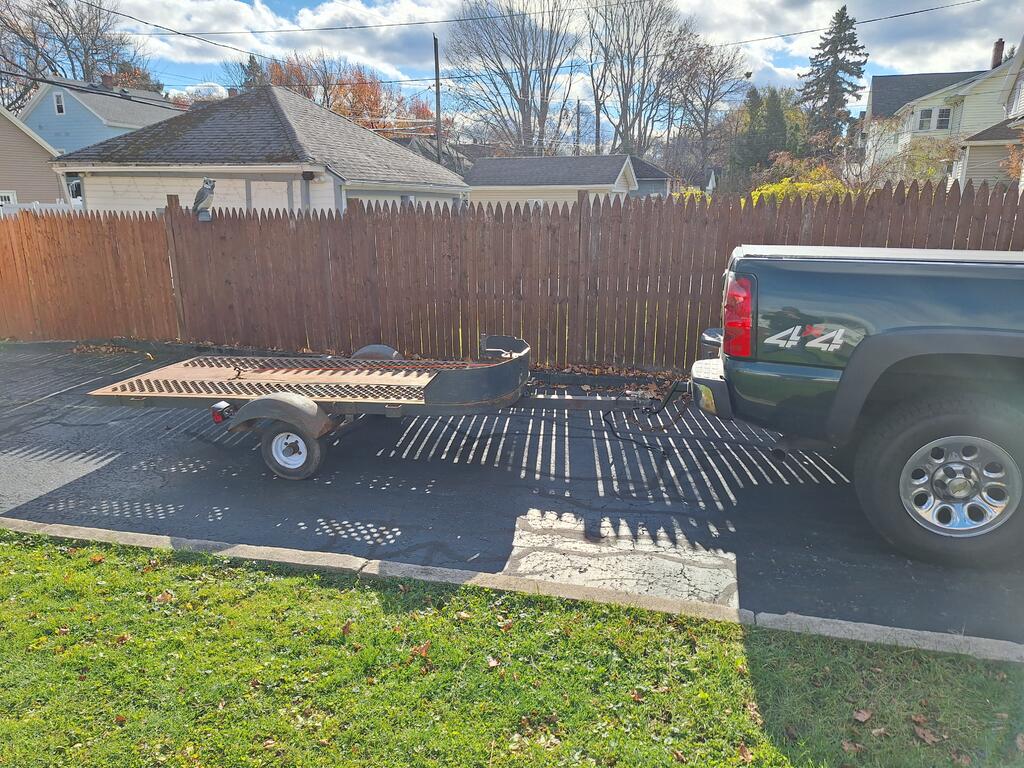

D_Mac 9,041 #22 Posted November 29, 2024 Just waiting on the wiring kit for my truck. The hitch is all set to go. Sits pretty level. I well register it in January then start looking for tractors to go get ! 2 1 Share this post Link to post Share on other sites

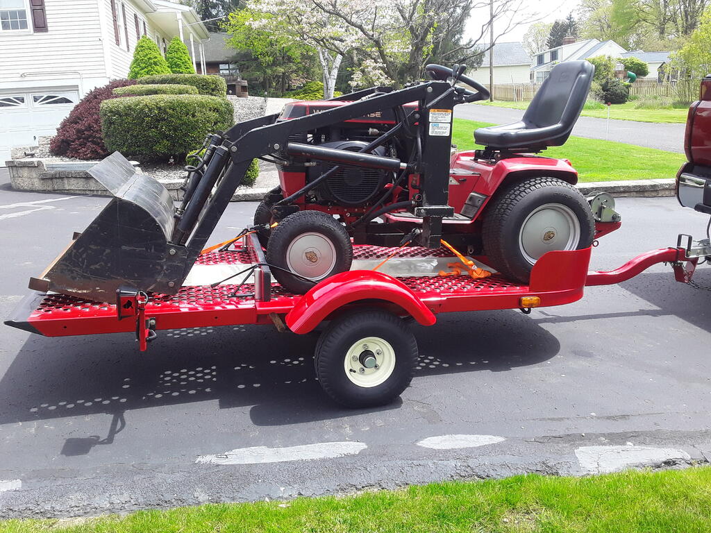

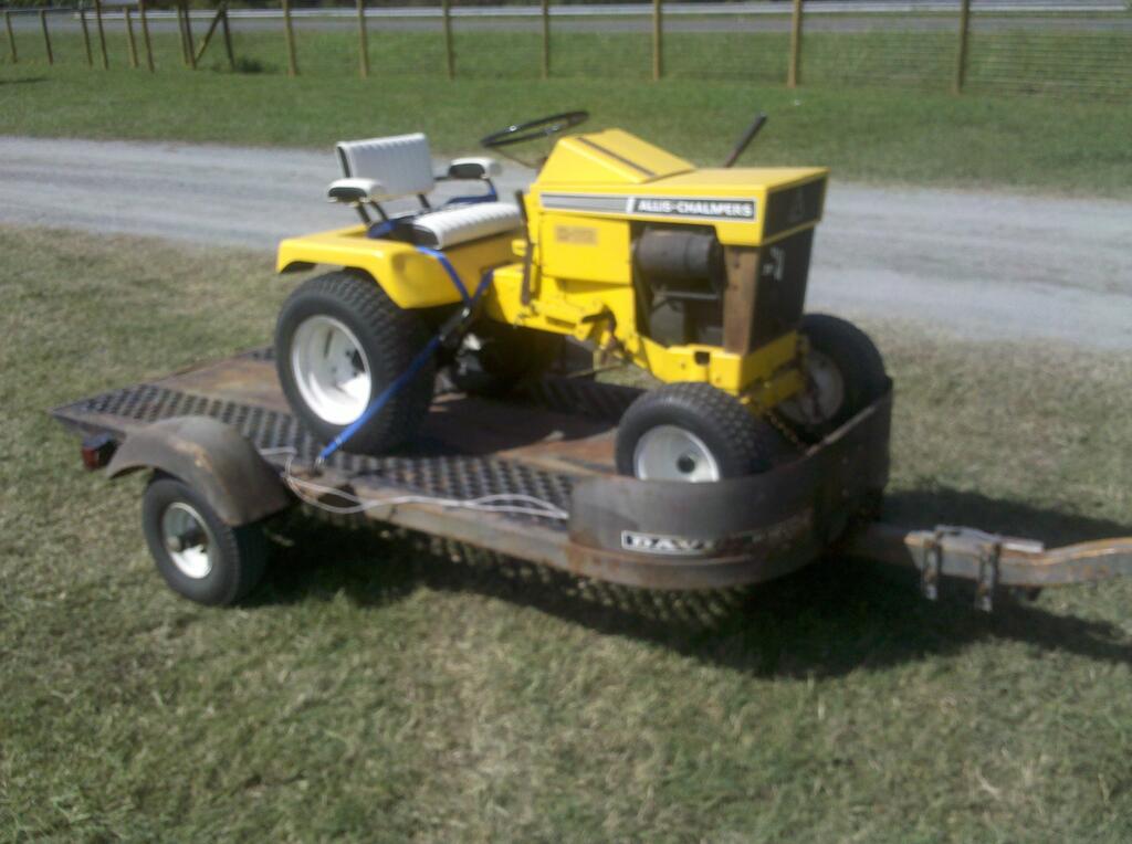

chip61 664 #23 Posted December 4, 2024 I have one (rebadged as a Hustler) that our neighbor bought new some time in the 60's. That was his Allis too. They are nice heavy duty trailers. When I first got this one, my son took it to haul his 4-wheeler. Yours looks good, you will get a lot of use out of it. 1 1 1 Share this post Link to post Share on other sites
D_Mac 9,041 #24 Posted December 4, 2024 (edited) On 12/4/2024 at 3:48 AM, chip61 said: Quote Sweet combination there. Even if they are the wrong colors. I notice the wheels are set back a little further on that trailer. I believe they are adjustable. Edited December 4, 2024 by D_Mac Share this post Link to post Share on other sites
chip61 664 #25 Posted December 5, 2024 LOL I know!! I used to borrow that Allis from our neighbor when I was a teenager to cut our grass and I would cut his for him sometimes. When the family had the estate sale I knew I had to have it. It had three flat tires and a lamp cord spliced in as a spark plug wire. I put gas in and jumped it and it fired right up!! 2 Share this post Link to post Share on other sites
