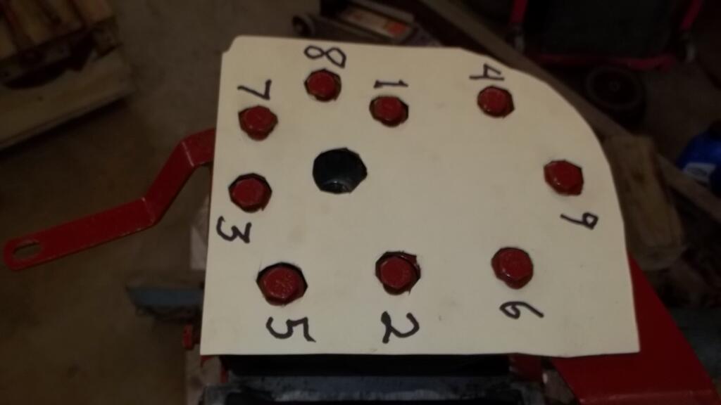

953 nut 57,490 #15 Posted November 22, 2024 7 hours ago, pfrederi said: That was really my point. I do not think they test ran them and they are new head gaskets which might compress some... just puzzled Just out of curiosity I checked the head bolt torque on a Kohler Magnum 10 engine. The manual calls for 25 to 30 foot pounds, I started at 25, no movement, went to 30, still ne movement, change to 40, nothing. At 45 foot pounds a couple of the head bolts did move a bit, most didn't. My guess is the factory torques them to 45 knowing they are using new bolts and no owner is going to retorque them. When torqueing head bolts I lay this little memory aid on top of the head so I don't have to look up the sequence. 8 5 Share this post Link to post Share on other sites
WHX?? 50,506 #16 Posted November 22, 2024 14 hours ago, 953 nut said: When torqueing head bolts I lay this little memory aid on top of the head so I don't have to look up the sequence Really good idea! 1 Share this post Link to post Share on other sites
pfrederi 18,279 #17 Posted November 22, 2024 15 hours ago, 953 nut said: Just out of curiosity I checked the head bolt torque on a Kohler Magnum 10 engine. The manual calls for 25 to 30 foot pounds, I started at 25, no movement, went to 30, still ne movement, change to 40, nothing. At 45 foot pounds a couple of the head bolts did move a bit, most didn't. My guess is the factory torques them to 45 knowing they are using new bolts and no owner is going to retorque them. When torqueing head bolts I lay this little memory aid on top of the head so I don't have to look up the sequence. I was thinking that might be the case 1 Share this post Link to post Share on other sites
Wheelhorse#1 1,758 #18 Posted November 27, 2024 On 11/22/2024 at 10:29 AM, WHX?? said: Really good idea! Great idea. I have been numbering the head bolts but wear off after a wile. Share this post Link to post Share on other sites
