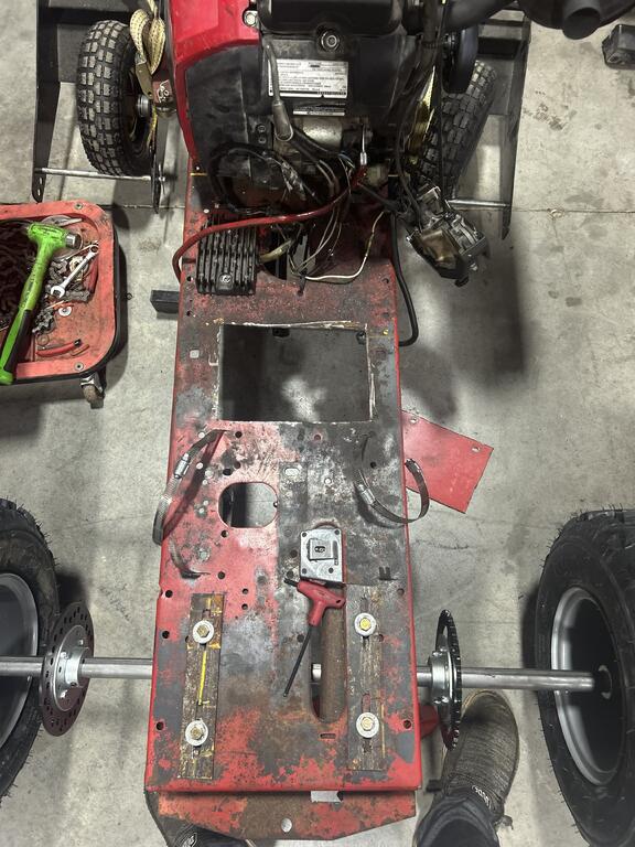

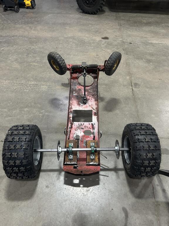

ive been working more, I got my axle and got it in, I pushed it around the shop and my steering broke, big surprise. I knew it would happen  sometime, good thing it happened then. I put my battery on then and its too tall, so I cut a battery size hole in the frame and put a 1 3/4 wide pice of steel around it and welded the bottom on, now my battery should work, I hope to drive it today or tommrow, then take it all back apart and do it right. weld all holes and stuff, it's coming together, hope y'all had a merry Christmas.

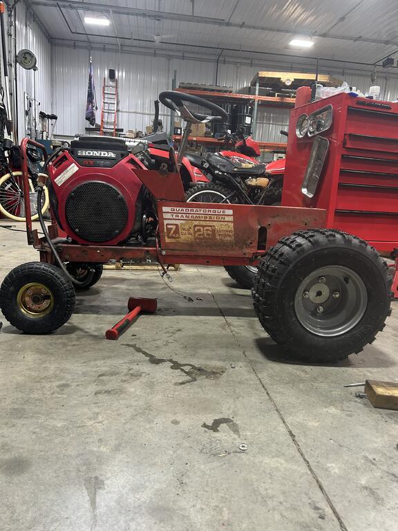

there's it with the v-twin, I got a new axle in it now

That Honda is going to rip that thing to shreds:lol:

Kudos to the person who came up with the name, "QUADRATORQUE TRANSMISSION"! :bow-yellow:
NEVER remove that decal!!!

will do, I don't plan to but I do plan to clear coat it.
hopefully not, I need to brace the frame next,  that Honda is a more torquey engine and lot a lot of rpm, it should do for a bit

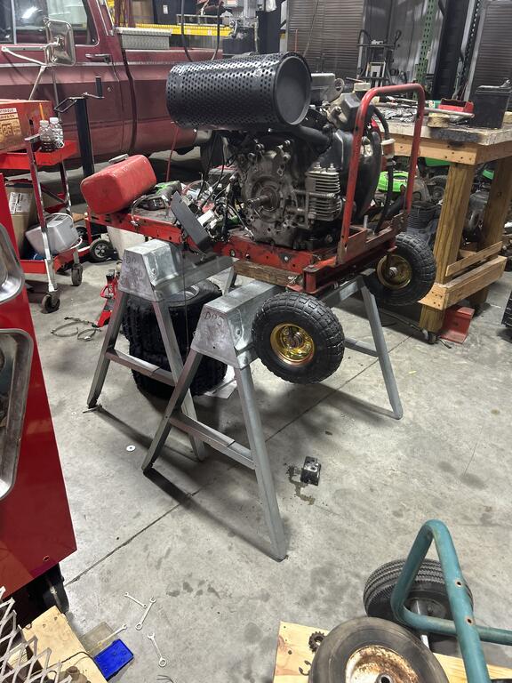

here's some more recent pictures , the big hole in the frame is now welded up, and it was a good idea to put it on saw horses you can also see the axle, and my chain tensioner, I need different front tires

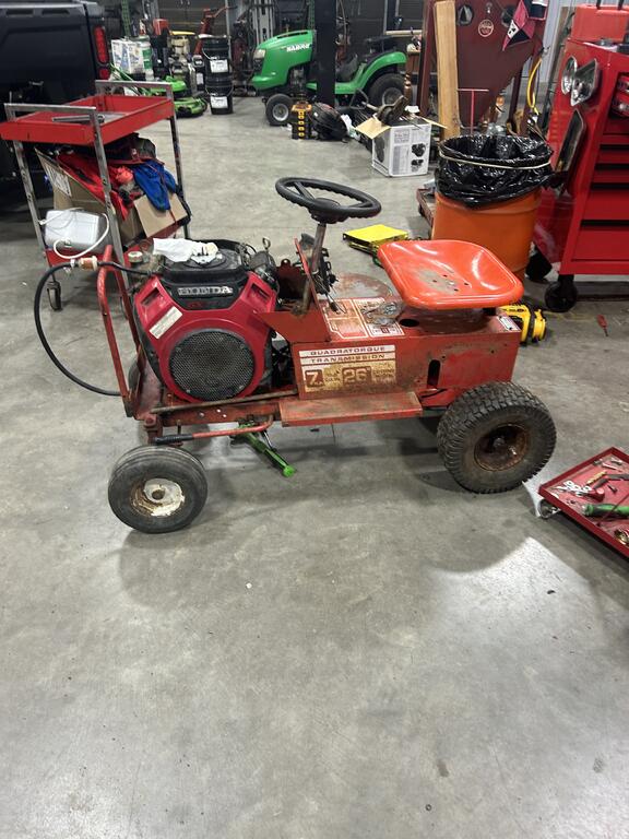

I just found a tractor with a 750 engine, I think I'm going to get it, 4 cylinder Honda
