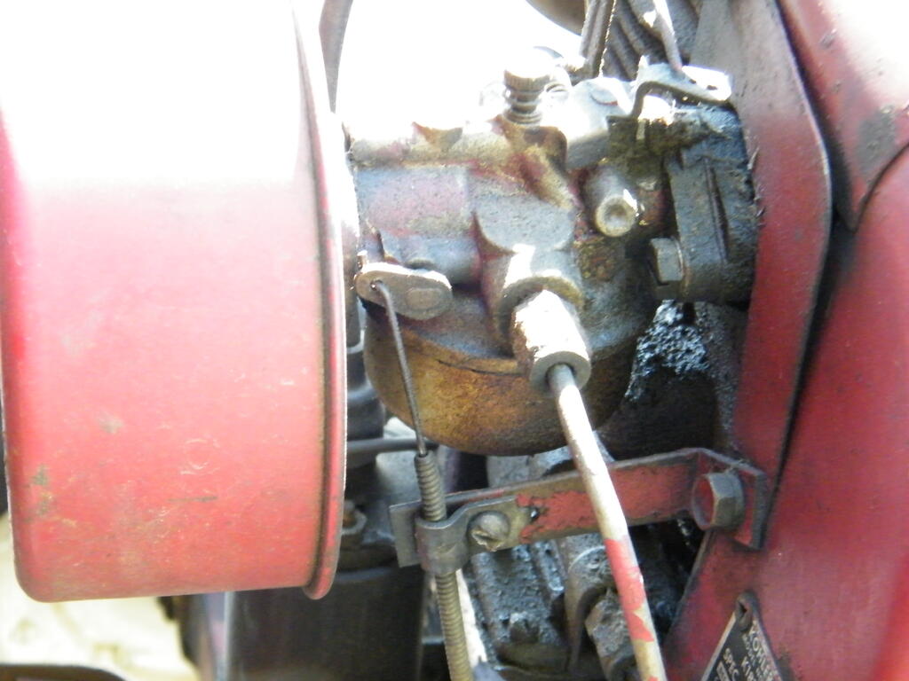

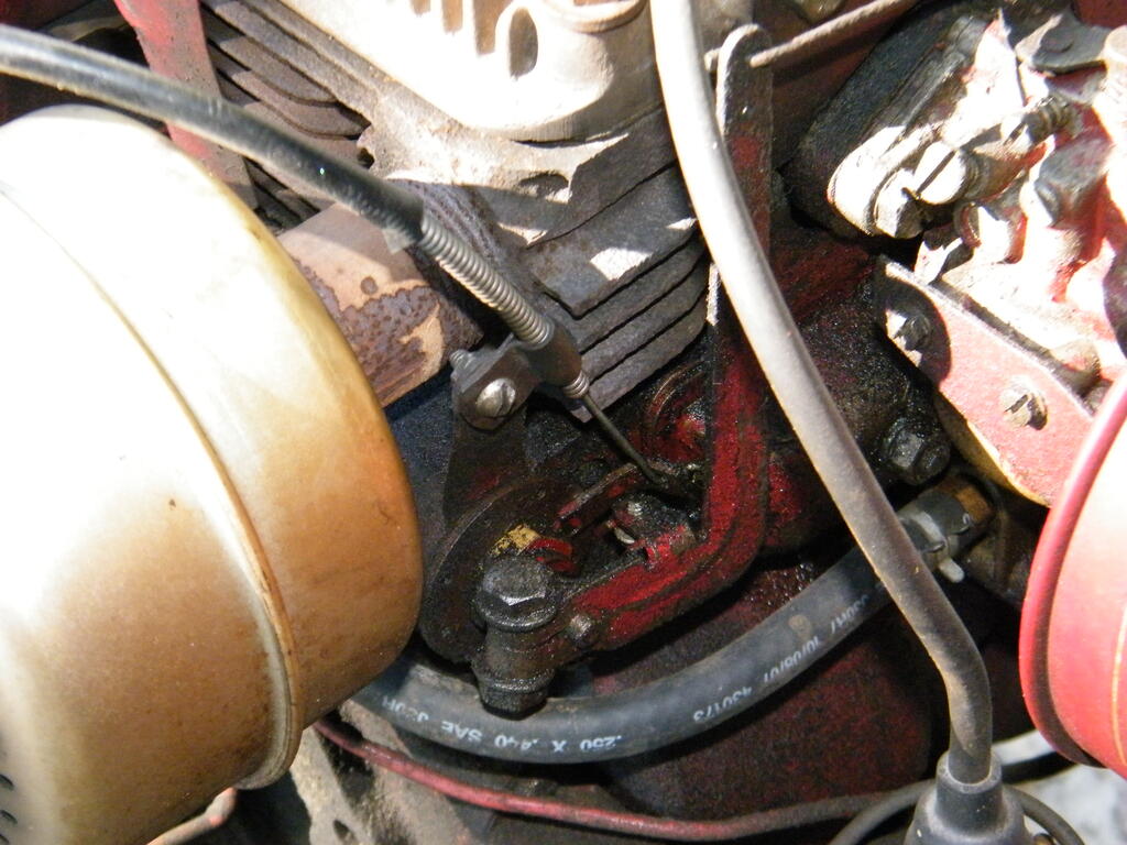

stevasaurus 23,627 #2 Posted November 13, 2024 This could be a if it works, don't fix it. However, if you want to play with it just remember what you moved and how far so you can put it back. Your tractor may not look like this, but it works the same way. The 1st pic shows the screw that holds the housing for the throttle cable. You might be able to pull some of that back toward the front of the horse, but the part that matters is conected to your governor stuff. The second pic shows 3 positions you can try after playing with the 1st pic. Look at top of the carb. Hopefully, someone with the same engine will come in here and be better informed. Share this post Link to post Share on other sites

Alrashid2 473 #4 Posted November 14, 2024 @stevasaurus thanks for the advice! Maybe I'll try putting the cable into another hole and seeing what happens... after taking photos before, of course! @RED-Z06 that is really great to know... sounds like this might just be a K series thing then! That's exactly how mine is. Share this post Link to post Share on other sites
