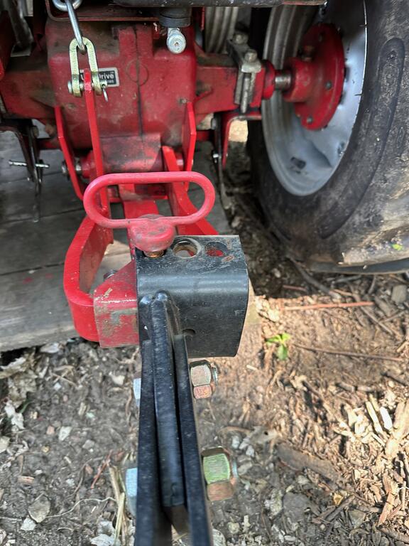

Andy N. 2,271 #4 Posted November 13, 2024 You need to see if your 312 has a rock shaft kit installed under the seat pan. And then you need a sleeve hitch. Sometimes you can find them used for sale online or you can buy from @wheelhorseman. Links are below https://wheelhorsepartsandmore.com/product/toro-wheel-horse-rock-shaft-kit-manual-transmission-with-tube-and-bracket-short-clevis-read-description/ https://wheelhorsepartsandmore.com/product/toro-wheel-horse-brinly-clevis-hitch-sleeve-hitch-with-adjustment-plate-and-pin/ Then you'll be able to attach Brinly sleeve hitch attachments and raise and lower them using the tractors lift arm. 2 Share this post Link to post Share on other sites

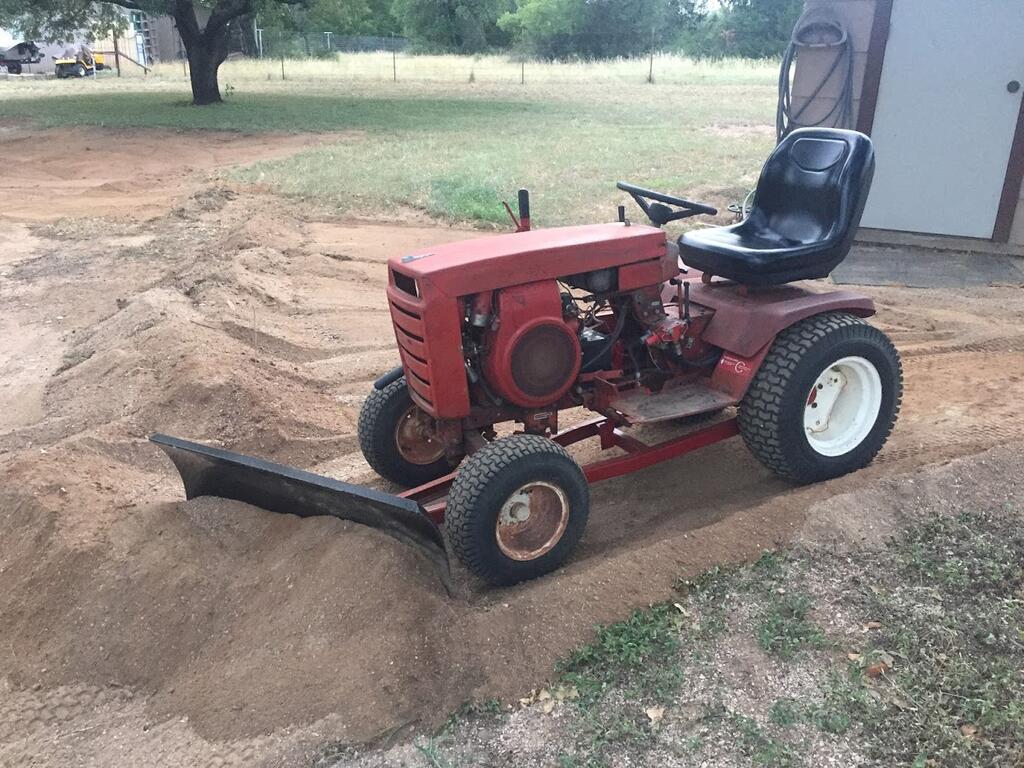

oliver2-44 10,353 #6 Posted November 13, 2024 Part of rear "Ground Engaging" attachment working is the tractor having the traction to pull them. I've done a fair amount of landscape dirt moving at my 3 sons houses with my C160 Auto. Used a front dozer blade, center grader blade, and a rear Gannon box blade. Each rear wheel is filled with Windshield washer fluid, has 66lb steel weight and tire chains. I can still spin the tire and dig a hole if I try to take to big a bite. Many attachments WH sold were made by Allied or Brinly and are of good quality. Google "Allied Garden Tractor Attachments" and the same for Brinly. 2 Share this post Link to post Share on other sites
Pullstart 64,471 #7 Posted November 13, 2024 There are various lift methods. Manual, electric and hydraulic are all standard among Wheel Horse’s line. 2 1 Share this post Link to post Share on other sites

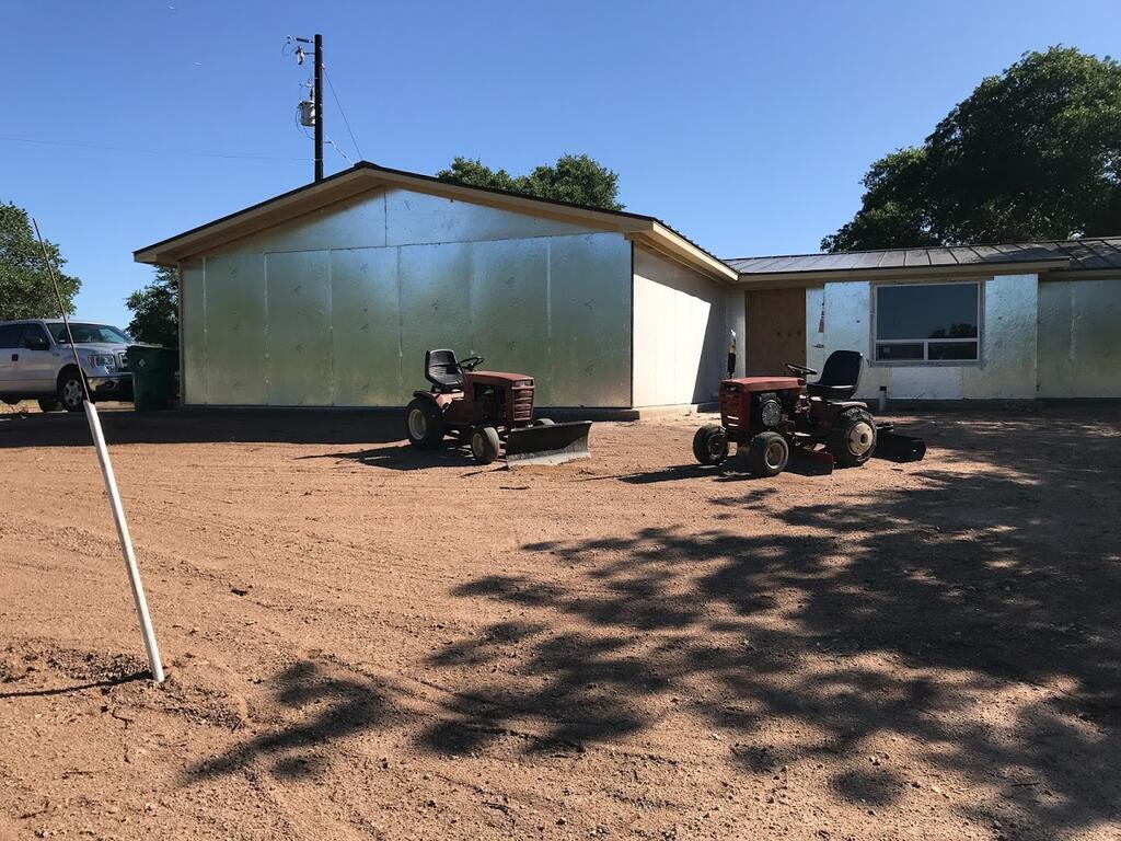

Lee1977 7,034 #14 Posted November 17, 2024 (edited) My lawn spiker , 5-75# 12" blocks. Grader Blade. Pulverizer - original use was to work lawns to plant grass. It works well on driveways too. There all home made. We just use what we have on hand. Edited November 17, 2024 by Lee1977 2 1 Share this post Link to post Share on other sites
