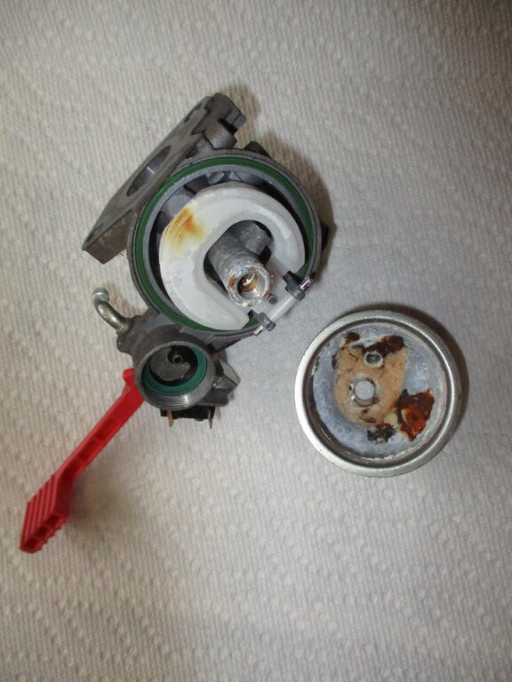

pfrederi 19,262 #1 Posted November 11, 2024 From my friends Kohler Command Pro on in his log splitter.....Uses regular gas.. Only a couple hours a year on the splitter. Bad news it is OHV so the stuck float dumped gas into the cylinder so now have to change oil also. Their is a station with ethanol free about 6 miles away a dollar more per gallon. Since it only burns a couple gallons a year save 2 bucks .... but carb kit is $18 4 5 Share this post Link to post Share on other sites
peter lena 9,556 #3 Posted November 11, 2024 @pfrederi add just an ounce or 2 , of STA BIL to all my fuels , fuel storage treatment , zero anything in my filters or carb bowls ,prior to doing that , changed out all related , hoses / filters , and cleaned , tank , just to verify that the additive , stops fuel debris . with clean fuel hold points , and regular STA BIL , use regular ethanol fuel , with consistent clog / break down free results . even my generator , and walk behind snow blower , sitting for months , have clean , fuel filters , and carb bowls, instant starts treat a lot of gas with that , and no fuel crud at all . pete Share this post Link to post Share on other sites

rmaynard 16,690 #7 Posted November 12, 2024 Unlike Pete, I do not use Sta-Bil. My only experience with Sta-Bil was a bowl full of gel in the spring, and a complete carb cleaning to get rid of it. Using straight ethanol-free gas ever since with zero problems. I know lots of guys like lots of different "snake oils", but removing the problem (ethanol) in the first place will eliminate the need to doctor your gasoline. Just my opinion, but I have been working with and maintaining small gasoline engines since 1964. Problems only began when ethanol was introduced. 3 Share this post Link to post Share on other sites
