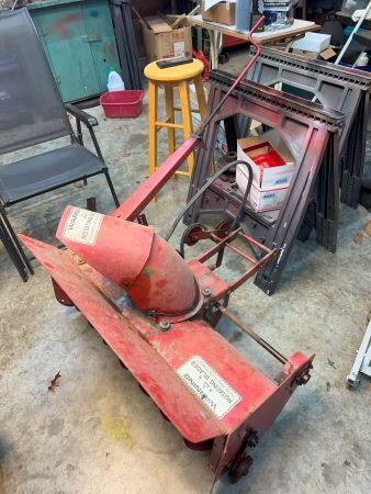

Bar Nuthin 1,810 #1 Posted November 11, 2024 A friend of mine saw a FB post of my tractor and offered up this snow blower for $50. I figured I couldn't go wrong at that price. Everything seems to be in working order after cleaning off some hardened grease, and I knew the history on it. Missing the side plates and the lift assist spring, if anyone has a lead. 2 Share this post Link to post Share on other sites
gwest_ca-(File Mod) 11,845 #2 Posted November 11, 2024 Could you post what you think the numbers are on the tag? 1 Share this post Link to post Share on other sites
Bar Nuthin 1,810 #3 Posted November 11, 2024 (edited) 3 minutes ago, gwest_ca said: Could you post what you think the numbers are on the tag? 96-42ST01 is correct - thanks! Edited November 11, 2024 by Bar Nuthin Share this post Link to post Share on other sites
JimSraj 560 #4 Posted November 11, 2024 The spring is available from A-Z Tractor, Wheelhorse Parts and More, and/or K&B. All vendors that can be found in the Classified drop down menu. I just got one last week from Lowell. 2 Share this post Link to post Share on other sites
peter lena 9,556 #5 Posted November 11, 2024 @Bar Nuthin done a couple of those , very easy to enhance , rotational saposed to be movement points , that IDLER PULLY FRAME , is often rust bound in mount holes , also the IDLER PULLEYS THEM SELVS , are rough and binding , the auger chain , requires a specific CHAIN AND CABLE LUBE , the base of the CHUTE ,could use a , snow slider gasket , for rotational ease. imagine engaging the pto lever without a screaming , clutch . just my experience , pete Share this post Link to post Share on other sites
Bar Nuthin 1,810 #6 Posted November 11, 2024 10 hours ago, gwest_ca said: Could you post what you think the numbers are on the tag? When I get back home in a few days, I will clean up the tag and provide a better photo. Share this post Link to post Share on other sites
Bar Nuthin 1,810 #7 Posted November 13, 2024 @gwest_ca better pictures Share this post Link to post Share on other sites
