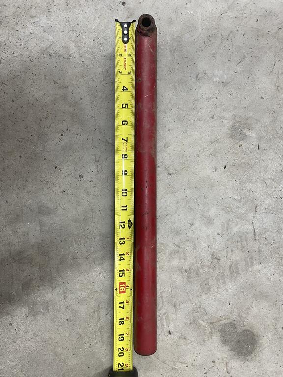

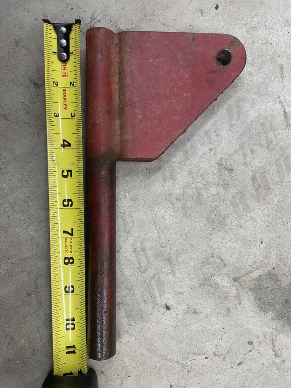

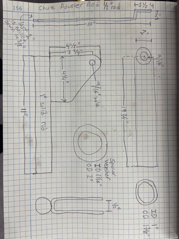

stevebo-(Moderator) 8,600 #1 Posted November 10, 2024 I purchased a 2 stager 2004 5xi two stage blower. It is missing a few parts like jack shaft and chute angle rod. If you have a 5xi two stager could you please provide me with some pics and measurements so I can fabricate these parts? Obviously if you have these parts and want to sell please let me know as well. I have an ad in want section as well. Parts are showing as no longer available on line. Thank you! Share this post Link to post Share on other sites

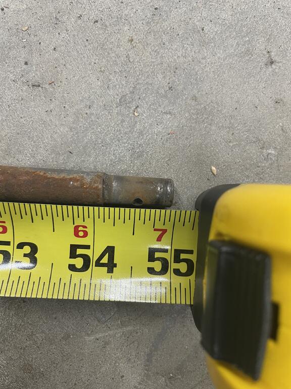

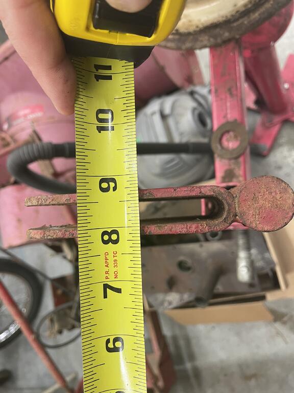

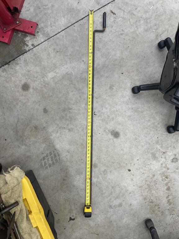

OoPEZoO 578 #5 Posted November 10, 2024 @stevebo.......Hopefully this will help. I just noticed you also asked for the tube crank support. I'll go back out and get some dimensions of that as well. If you need more pics or info, I'm glad to help where I can Not to scale, but I believe I got all the important measurements in there Jack shaft Flag Chute hand crank 1 Share this post Link to post Share on other sites

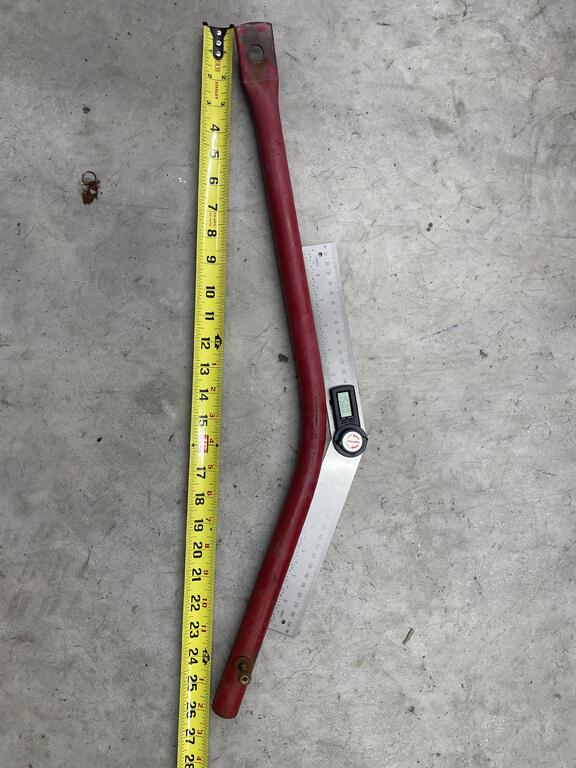

OoPEZoO 578 #6 Posted November 10, 2024 Here is the guide pipe for the hand crank You could be pretty sloppy with this and it would still work fine if you were making your own. Its a 1" thin walled pipe with the last 2" crushed flat with a 9/16" hole drilled for the crank shaft to pass through. The angle of the bend is 150 degrees, and the set screw at the bottom is 2" from the end of the pipe 1 1 Share this post Link to post Share on other sites
stevebo-(Moderator) 8,600 #7 Posted November 11, 2024 Thank you so much! This will help me fab if I cannot find oem. Share this post Link to post Share on other sites
Gravely Horse 19 #8 Posted November 12, 2024 I’m glad I saw this post. For the single stage blower, it apparently uses a flag with 3/4” rod instead of 1”. Are the dimensions of the flag the same aside from that? Share this post Link to post Share on other sites

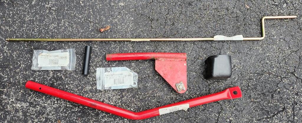

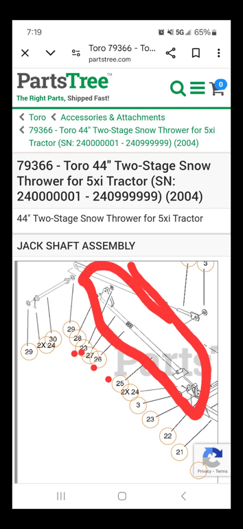

Brockport Bill 2,122 #9 Posted December 14, 2024 On 11/10/2024 at 9:08 PM, stevebo said: Thank you so much! This will help me fab if I cannot find oem. if you have the Xi 2 stage blower and you think these pieces are what you need, please let me know? do you need the "tube-crank support " - I think might be piece # 95-3864-01??? plus, what they call the "yoke" looks like a flag? Maybe #94-7671-01 ?? see photo ................. Share this post Link to post Share on other sites
