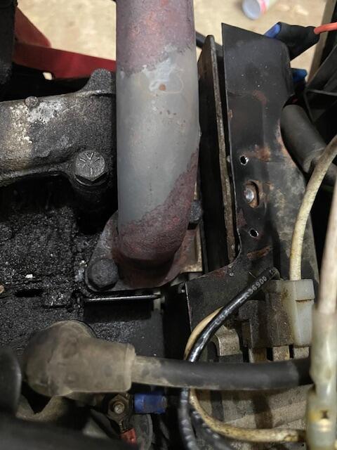

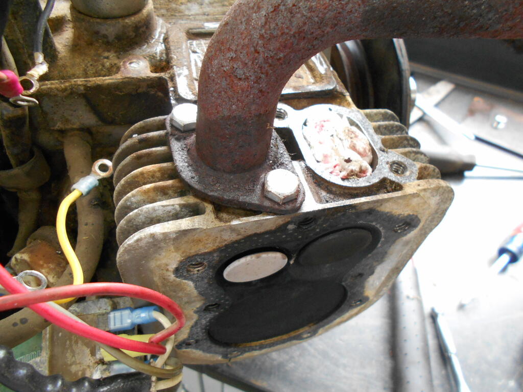

AHS 1,491 #15 Posted December 4, 2024 Ok! Enough is enough… I am doing this! Taking off the intake- sealing that up. Taking off the exhaust- I already broke one bolt! Taking off the carb and cleaning it. This is. An 88-89 with the straight axle. Please, if you could give me the serial #s off the motor? Mine are all wiped off! The Onan dealer wants serial/model #s so he can order the gaskets. I am going to get new bolts for the exhaust/intake? Also, I have an intake from an Onan 16, would that be the same as the 20HP? I want to be SURE that there are no intake leaks, no intake runner leak and the carb is 100% checked! Anything else I should do on a 1500 hr Onan 20hp? Your thoughts are welcome! Oh, the exhaust bolt I sorta broke (one more 1/8 of a turn and it will be broke!) is the bolt to the left of the exhaust. Share this post Link to post Share on other sites
AHS 1,491 #16 Posted December 4, 2024 I sprayed kroil on the exhaust bolts and let it warm up twice. What’s wrong with a 1/2” breaker bar trying to loosen up exhaust bolts!?!? I was being careful! No wonder i broke it! Share this post Link to post Share on other sites
lynnmor 7,553 #17 Posted December 4, 2024 You should have been spraying penetrating oil on all of the fasteners at least twice a day for the past 25 days for a total of 50 times. The exhaust should be glass beaded and painted with Rustoleum high temperature spray paint. You can test the intake for leaks, once it is off, by sealing off the carb mounting surface and filling it with gas or diesel fuel. I believe that most are not a problem. You buy the gaskets from onanparts.com and forget the local guy that has no clue, nearly all Onans of this size use the same gaskets. The 16HP intake might fit but will have no vacuum fitting if you need one. A 1500 hour engine needs the valves adjusted for the second time, I'm sure it missed the first. Be sure to bottom tap all of the intake and exhaust mounting holes and use bolts that are as long as possible without bottoming out, you may need to cut custom lengths. 2 1 Share this post Link to post Share on other sites

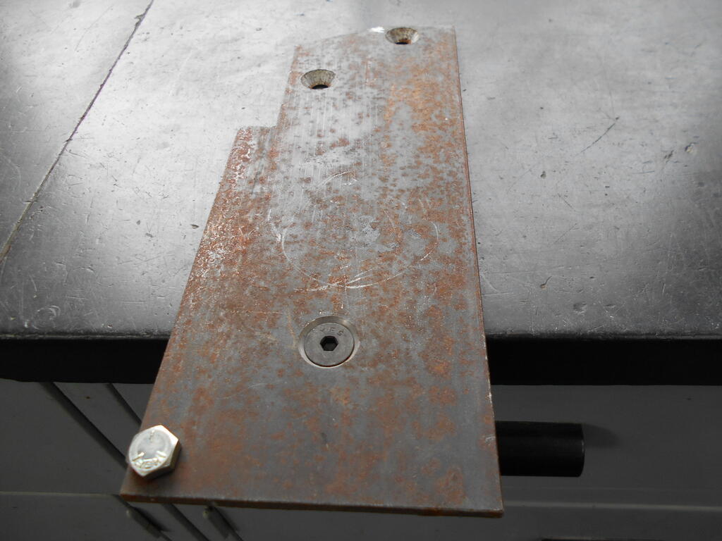

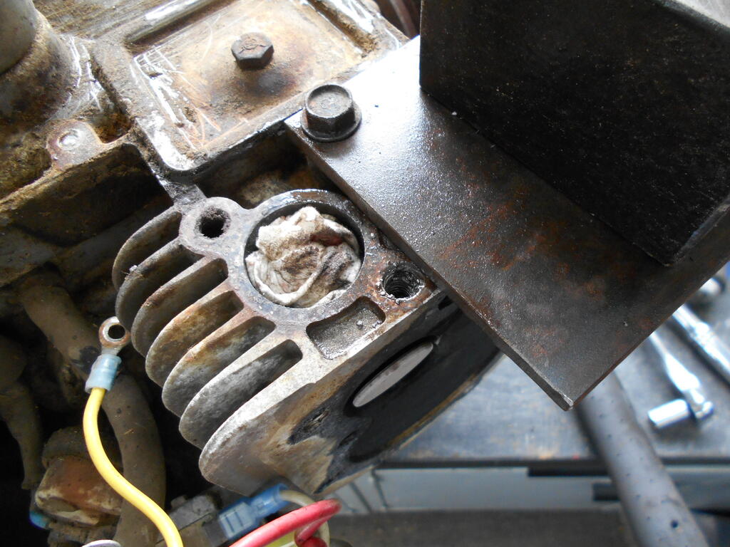

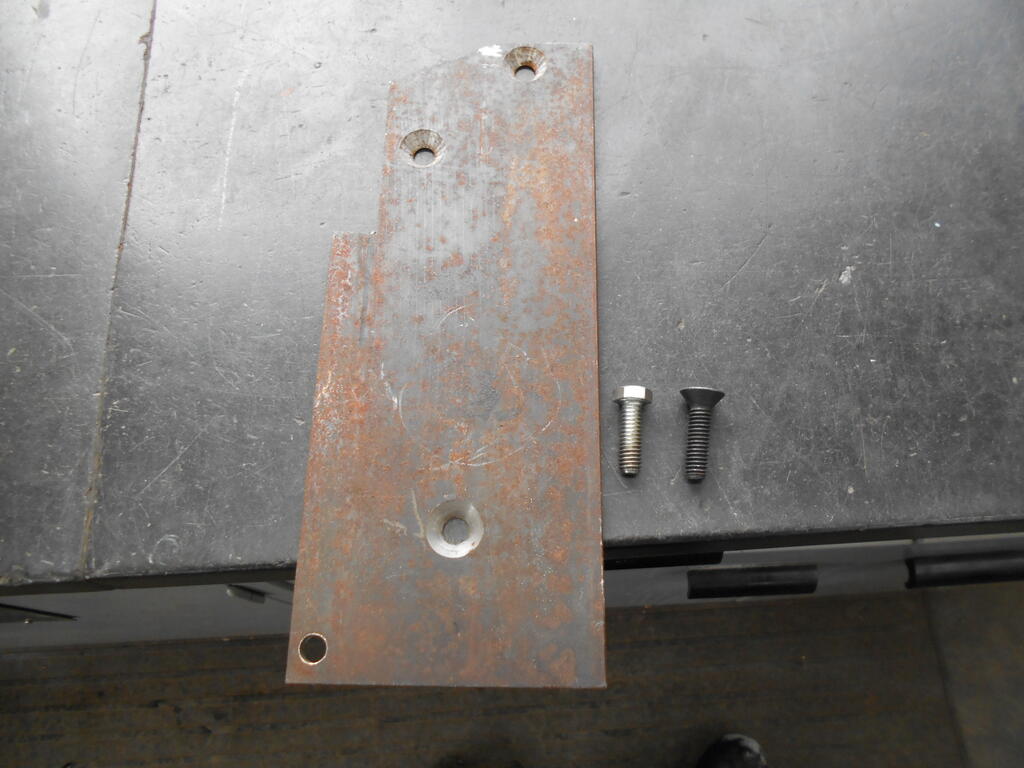

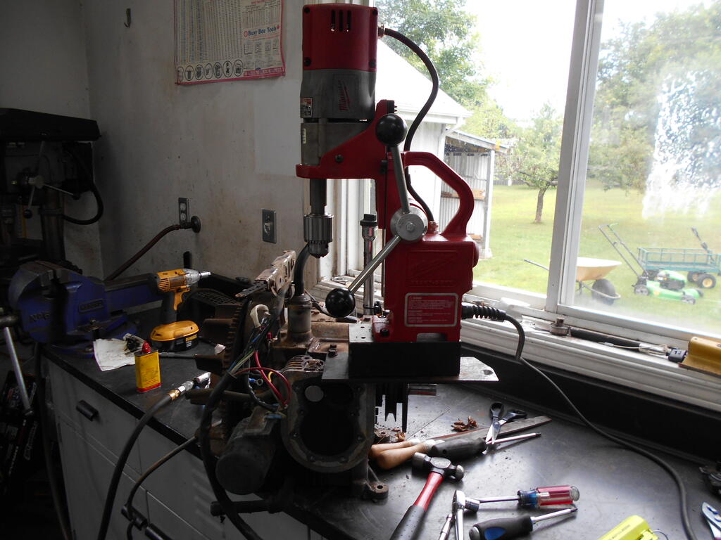

cleat 6,945 #18 Posted December 4, 2024 I have had muffler bolts break as well. I made up this plate that bolts to the intake boss and holds a magnetic drill. I can now drill the hole centered which is very difficult to do when drilling a steel bolt out of aluminum. Once drilled the hole can be properly tapped and as lynnmore said, use bolts as long as possible with never seize applied. 3 Share this post Link to post Share on other sites
