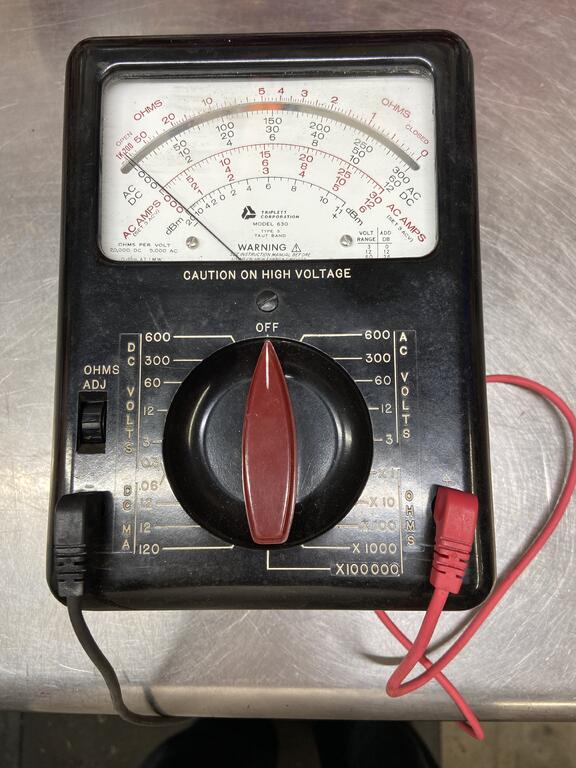

kpinnc 16,187 #9 Posted November 9, 2024 (edited) 5 minutes ago, Bar Nuthin said: I was just looking at that today, I found the timing mark (marked "S") but need to borrow or buy a meter. Probably ought to own a multimeter anyways. Any recommendations for a hobbyist entry level meter? Analog meters are becoming few and far between. Even more so with a decent quality. I was always impressed with the old school Simpson meters, but never got to keep one of the old ones issued back in the day from the phone company. I settled for a clone, but it’s been good for about a decade. I guess Craigslist and other auction sites might occasionally have these. Edited November 9, 2024 by kpinnc 2 Share this post Link to post Share on other sites

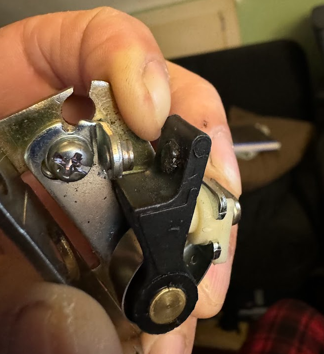

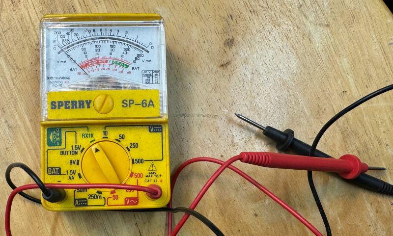

Bar Nuthin 1,810 #10 Posted November 10, 2024 (edited) @kpinnc Going through my toolbox and found this El Cheapo meter. Has to be at least 30 years old. Couple of fresh batteries and it seemed to work fine. My tractor ran noticeably smoother after adjusting the points gap to .018. Who'd have thought such a small change would produce such results? Bad news is the bottom contact on these points is almost fried already - so I'll repeat the process with a new set when I get them. I also ordered the little push rod that rides the camshaft. Edited November 10, 2024 by Bar Nuthin 1 Share this post Link to post Share on other sites
kpinnc 16,187 #11 Posted November 10, 2024 3 hours ago, Bar Nuthin said: Going through my toolbox and found this El Cheapo meter. Plenty good enough for testing your points break! 1 Share this post Link to post Share on other sites
lynnmor 8,254 #12 Posted November 10, 2024 13 hours ago, Bar Nuthin said: @kpinnc Bad news is the bottom contact on these points is almost fried already - so I'll repeat the process with a new set when I get them. I also ordered the little push rod that rides the camshaft. If the points have a significant uneven wear (buildup on one side and pitting on the other), replace the condenser. 3 Share this post Link to post Share on other sites
Bar Nuthin 1,810 #13 Posted November 19, 2024 (edited) On 11/10/2024 at 9:40 AM, lynnmor said: If the points have a significant uneven wear (buildup on one side and pitting on the other), replace the condenser. Turns out the tractor did not have the correct coil (no internal resistor). Most likely the reason for smoking the points so quickly. New coil, points (+ rod) and condenser installed! With the new cam push rod, the static timing set the points gap back to .020 Edited November 19, 2024 by Bar Nuthin 1 2 Share this post Link to post Share on other sites
