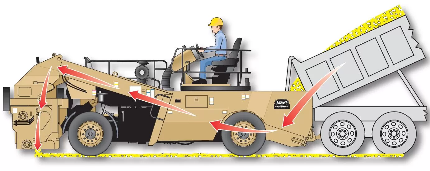

Pullstart 64,435 #5 Posted November 5, 2024 39 minutes ago, Horsingaround! said: miniature etnyre style chipspreader What is that? Sounds fun! Share this post Link to post Share on other sites

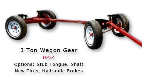

Achto 28,682 #6 Posted November 5, 2024 I'm with the rest of the gang, don't think that a 520 frame will handle that much weight. I also don't think that you can find 12" tires to handle that much weight either. A pic of a typical 3ton wagon running gear. One other note: I would not suggest pulling 3 ton with any . Ohhh, it will probably pull it !! It's the stopping it that can be an issue. 5 1 Share this post Link to post Share on other sites

953 nut 57,745 #8 Posted November 5, 2024 Heavy equipment is typically built using heavy plate steel sides as a starting point. If you build it we would love to seed a thread on the build and updates on your progress. Guess you could use the 520 hood though.. 6 minutes ago, Pullstart said: What is that? Sounds fun! Gravel spreader 1 Share this post Link to post Share on other sites
Ed Kennell 40,394 #9 Posted November 5, 2024 https://etnyre.com/chipspreaders/ 1 Share this post Link to post Share on other sites
