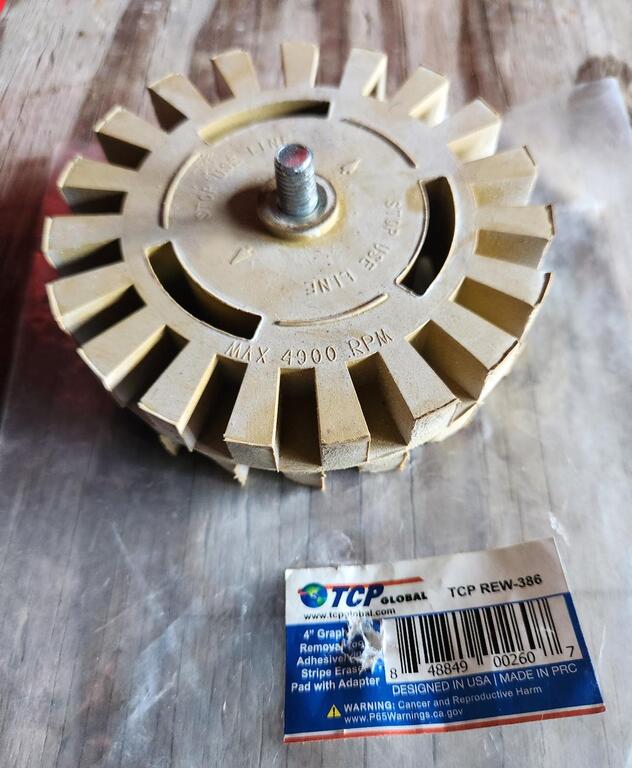

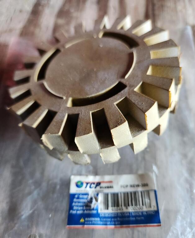

bought this tool used with drill motor on a video for auto decal removals -- i've used it a few times and works pretty well -- don't have the box or recall where i ordered?
  • Like 3

OoPEZoO
What Bill said......get an eraser wheel for your power drill or die grinder.  Autoparts store or jungle site should fix you up.  My buddy who owns a body shop let me borrow one once upon a time and it blew my mind how easy it was to remove decals/adhesive.  In that specific case, I was removing original pinstripes and decals from a junkyard replacement door for a 1988 Subaru.  It took everything off in a matter or seconds and didn't damage the paint.  I've had one in the tool box ever since.
For big decals, I would probably still start with the heat gun to get the sticker off, but the eraser should chew right through the adhesive that is left
  • Like 1
