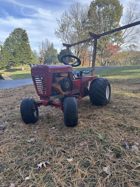

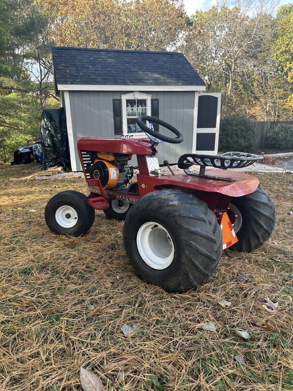

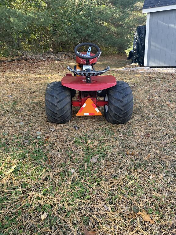

STLWheelHorse 20 #1 Posted November 1, 2024 I will start by saying I’m extremely green thumb with wheel horses. In fact, this is the first time I had even heard of them! But I saw this on the side of the road, decided to take a lick at getting it running. I can’t find any markings on it to help me with year or model. If I had to guess, 1940s-1950s for the year? Any help would be greatly appreciated! 3 1 Share this post Link to post Share on other sites
oliver2-44 10,264 #3 Posted November 1, 2024 That is a wheel Horse Lawn Ranger. 60's-70 vintage. Love the extra big tires and treadplate on that little rascal. I'm goin to guess the engine pulley is larger that original to speed it up. be careful they are light on the front end and might be easy to pop a wheelie. They usually have a serial number decal, which would be under that aluminum treadplate covering the dash area. If you can loosen that up to look under there it could help narrow down the year. Otherwise, some of the experts will be along to help narrow down the year by some small unique features. As your aware that is an aftermarket clone engine. WH uses the belt guard as parting of the clutching to slack the belt so you could shift gears with out it grinding the transmission gears. The transmission gears are not synchronized so the transmission pulley must be stopped to shift gears without grinding. Since your belt guard is missing you may be able to make a stiff wire finger at the motor pulley to help guide the slack belt. You could also get a used belt guard from one of our vendors A-Z Tractor listed here in the Vendor Section. you might have to modify it some to adapt to the clone engine. 3 1 Share this post Link to post Share on other sites
SylvanLakeWH 27,202 #4 Posted November 1, 2024 Cool Lawn Ranger!!! 1 1 Share this post Link to post Share on other sites

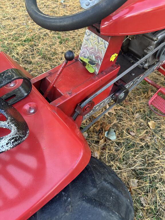

953 nut 57,527 #5 Posted November 1, 2024 One of the functions of the belt guard is to catch the slack in the drive belt when the clutch is depressed allowing you to shift gears. Looking at the pictures I wonder if the belt would work better being routed above the lower idler pulley. The looks of a Lawn Ranger didn't change much from 1963 to 1968 and with the extent of the modifications yours has had, who cares what year it is, it is cool. 2 1 Share this post Link to post Share on other sites

Ed Kennell 40,259 #7 Posted November 1, 2024 1 hour ago, 953 nut said: Looking at the pictures I wonder if the belt would work better being routed above the lower idler pulley. Agree with Richard. Another easy to get the belt to positively stop for gear changing is to add a belt brake tab as Wheel Horse did on the later models. 2 3 1 Share this post Link to post Share on other sites
STLWheelHorse 20 #8 Posted November 1, 2024 Thanks for all the helpful insight. As of now it took a couple weeks to get it running, but it drivers and shifts completely fine, which was a great shock to me, but I guess they just made things right back then. Plans for it are open, I got two acres of woods to play with, I definitely need two new tires but it looks like these Goodyear rawhides haven’t been available for like a decade. 21x11x8s are what they are, I love the wide stance as well! Most likely will continue to slowly clean it up without changing too much of the original look to it. Suggestions? 1 1 1 Share this post Link to post Share on other sites

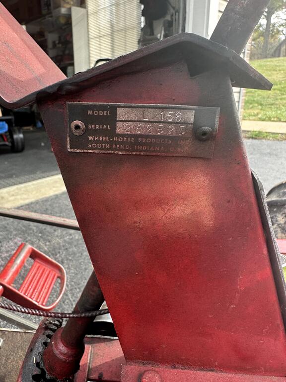

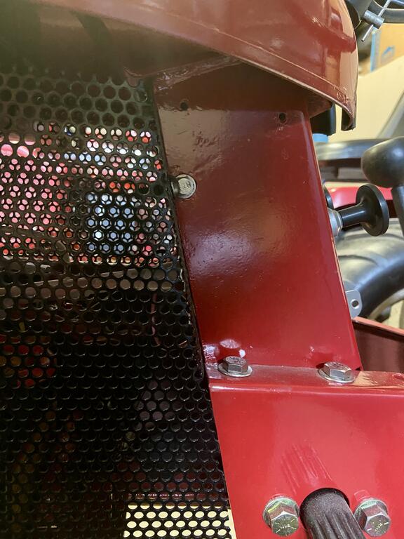

kpinnc 13,486 #11 Posted November 2, 2024 (edited) Awesome little Ranger! It’s a 65-68 model machine. The 62-64 models were completely different (as in the first pic). The ID tag is on the left side of the steering tower, not the area of tread plate. Mine is missing in the second pic, but you can see the mount holes all the way up under the top of the hood stand. Edited November 2, 2024 by kpinnc 1 Share this post Link to post Share on other sites

STLWheelHorse 20 #14 Posted November 3, 2024 23 hours ago, kpinnc said: Awesome little Ranger! It’s a 65-68 model machine. The 62-64 models were completely different (as in the first pic). The ID tag is on the left side of the steering tower, not the area of tread plate. Mine is missing in the second pic, but you can see the mount holes all the way up under the top of the hood stand. thank you! I just found mine 3 Share this post Link to post Share on other sites
kpinnc 13,486 #15 Posted November 3, 2024 2 minutes ago, STLWheelHorse said: thank you! I just found mine Glad to be of help! By that tag, you have a 1966 L-156. And BTW, the leaky axle seal is fairly common. They are easy to replace provided the hub comes off without issue. The transmission uses regular gear oil (any 90w or similar). That little plug on the left side of the transmission is the only way to check the oil level on that tractor. It should be right up to the top of the peep hole on level ground. 4 1 Share this post Link to post Share on other sites
stevasaurus 23,041 #16 Posted November 3, 2024 L 156 is a 1966 Lawn Ranger. Your trans, if original, is a #5053 and your axle seal is leaking. The seal is #SKF 9815 and can be changed out by removing the wheel and hub and dig out seal...easy if the axle bearing is OK. Jack up rear end and check for up down and side to side play in the axle...no play means axle bearing is good. kpinnc beat me to it... 4 1 Share this post Link to post Share on other sites
