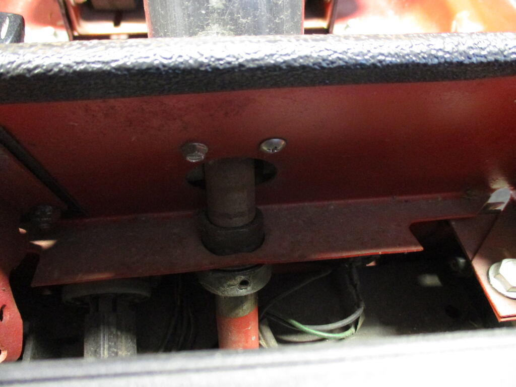

ANTPER 207 #1 Posted October 31, 2024 Have a 1990 312 with the plastic steering column collar that sits below the steering wheel. Trying to figure out What's missing to keep that collar fastened to the dash board. I don't have any holes that screws would be in to fasten or keep it in place. It moves around and doesn't stay in place. Thanks. Anthony 1 Share this post Link to post Share on other sites
Moparfanforever 874 #2 Posted November 1, 2024 There are plastic ribs inside the sleeve that fit tight to the column that wear down after years of use. The sleeve is supposed to fit close to the steering wheel to help keep it tight, all of mine has washers to help shim it. Not sure if it is still available from Toro. I read before someone used a piece of pvc pipe over the column, but it was small and didn't look right. I have some i need to fix, but haven't figured out a good way to do it. Anyone have a fix?? 2 Share this post Link to post Share on other sites

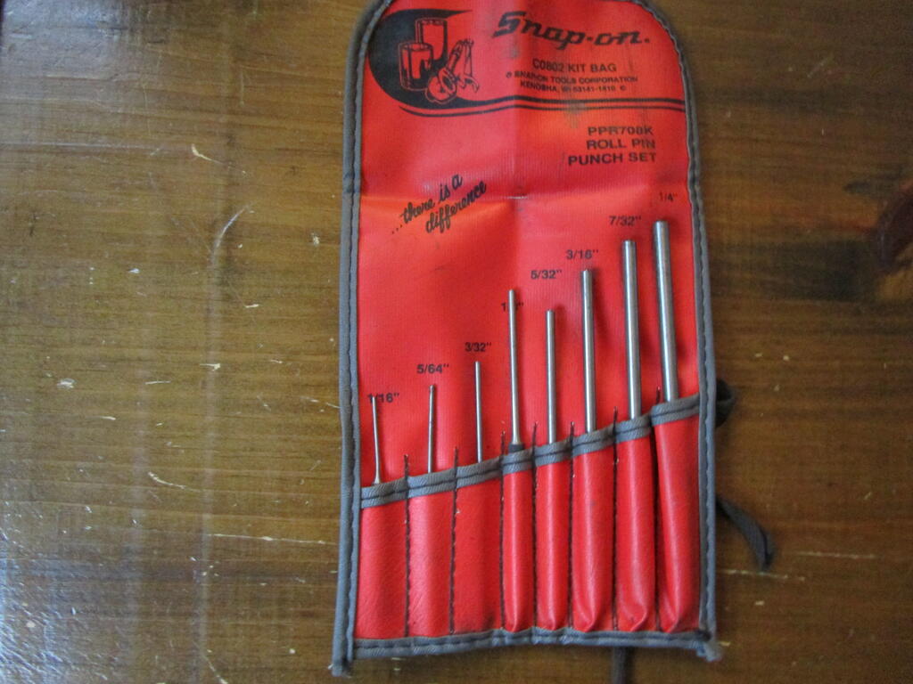

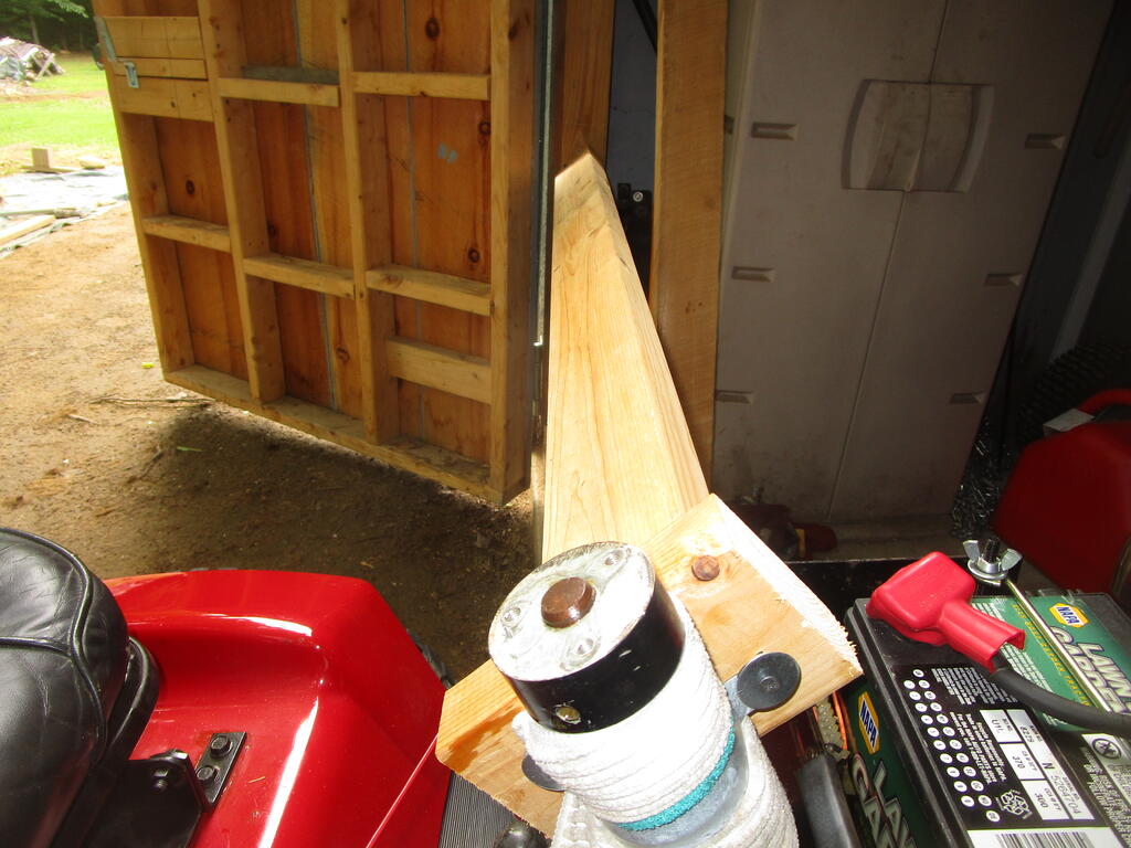

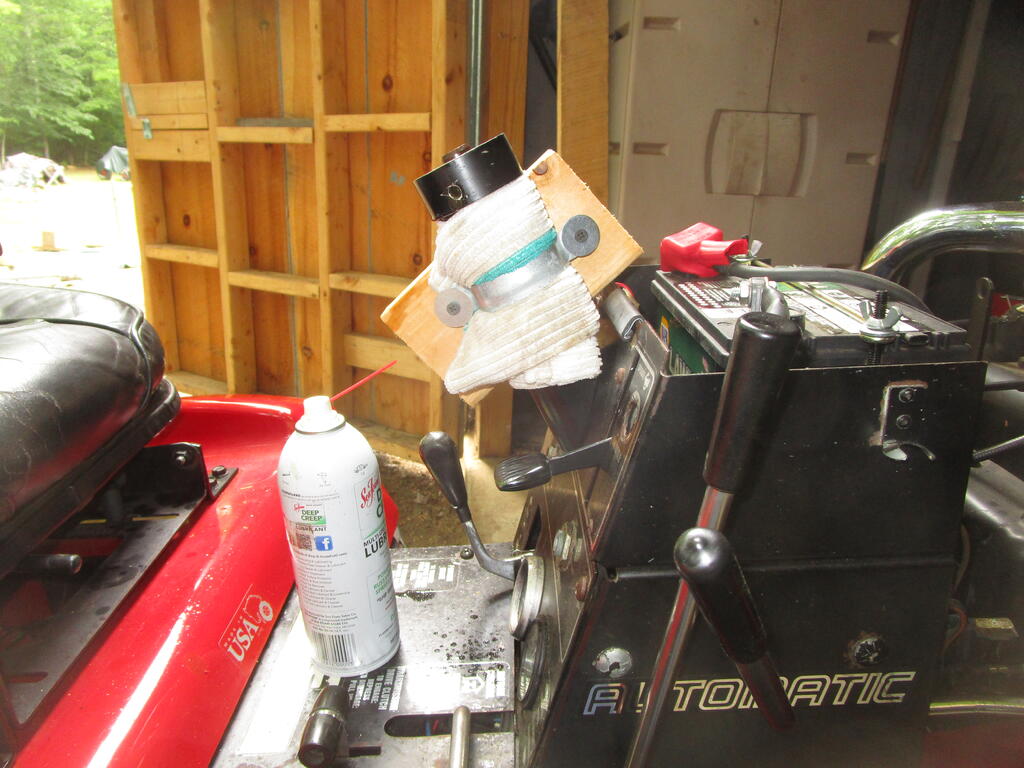

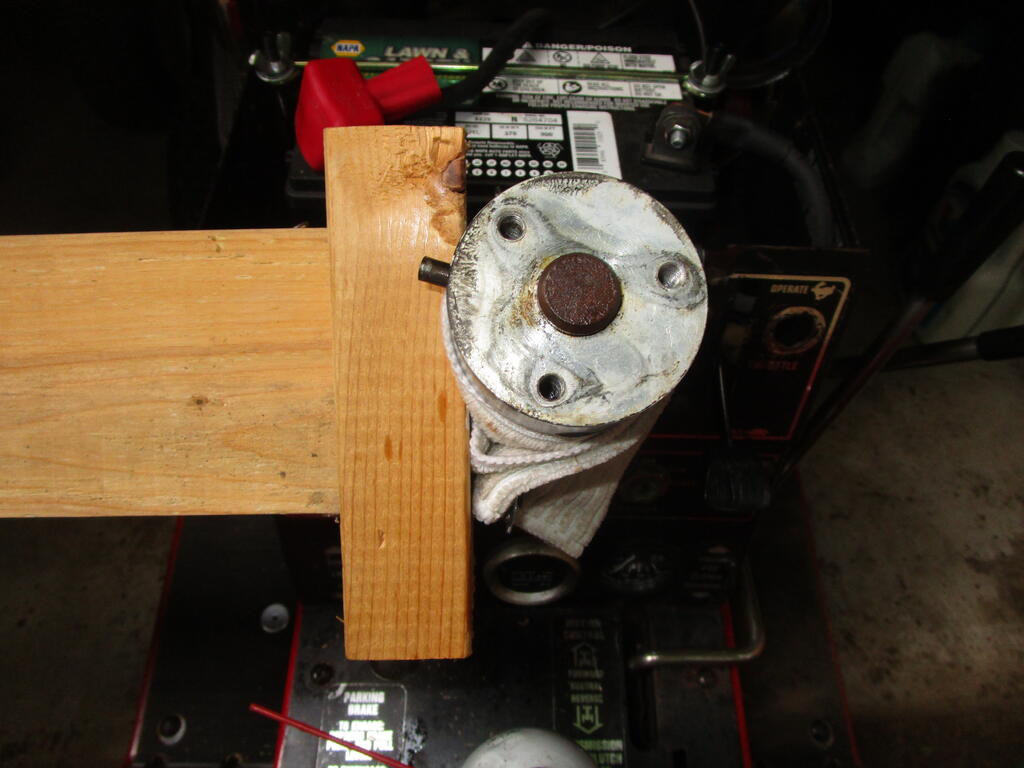

oliver2-44 10,371 #7 Posted November 1, 2024 (edited) 53 minutes ago, ANTPER said: Taking the wheel off involves knocking drift pin out? And I'll need a puller for steering wheel? Successfully removing a WH steering wheel is a badge of WH passage. Especially if you don’t go crazy doing it. To remove the roll pin soak it and the top center shaft multiple days, weeks with a good penetrant. Then brace the wheel with something solid to a solid wall or post. Use a quality roll pin punch towel to avoid flaring end of pin. Sometimes I’ve had better luck drilling the roll pin out with a carbide masonry drill. The plastic wheel hub is not strong enough to pull on with a puller and the p lower plastic collar prevents getting a bearing separator under the small steel collar. So your left with continuing to soak it with penetrant and hand pluming twisting the wheel. Some of us have decided that little rattling plastic collar isn’t that bad of a nuisance after all Edited November 1, 2024 by oliver2-44 1 Share this post Link to post Share on other sites
WHX?? 50,776 #8 Posted November 1, 2024 (edited) Yes and most likely yes. Steering wheel removal can involve a bit of french and is a rite of passage. Start soaking it in your favorite penetrant. Even the roll pin can cause great pains. If you get lucky with both go buy a lotto ticket. Ollie's got faster fingers ... Edited November 1, 2024 by WHX?? 1 1 Share this post Link to post Share on other sites

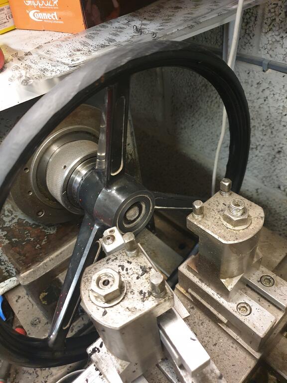

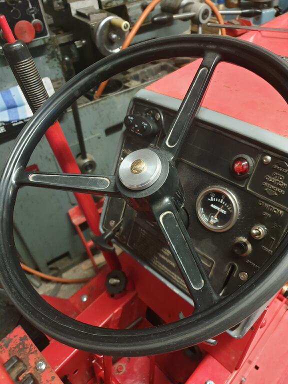

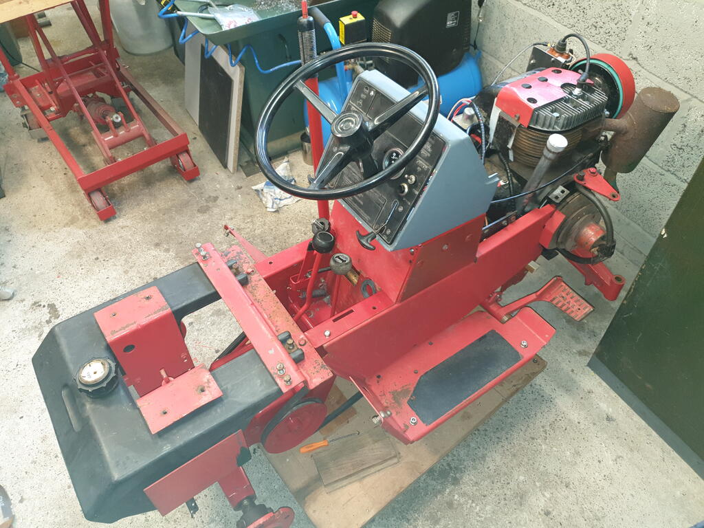

Mickwhitt 5,025 #9 Posted November 1, 2024 I don't recall how I got mine off now. But it was no picnic, wrestling with it because you can't use a puller. It had a hole drilled down through the centre boss so that penetrative oil could be pumped in and left to soak down into the steering shaft. I did have to turn the wheel in my largest lathe to true the rim and tidy up the boss. I then made an ornamental aluminium centre cap to keep the rain out. There was no collar into the dash, just a thick walled tube to cover the top portion of the steering shaft. 2 2 Share this post Link to post Share on other sites

pfrederi 18,337 #15 Posted November 1, 2024 Easier Fix Drill a couple holes just above the steering column hole. Hold the plastic sleeve in proper place run two sheet metal screws in to it. 4 Share this post Link to post Share on other sites
Lee1977 7,044 #16 Posted November 1, 2024 Is it just the plastic cover on the steering wheel are does the sterring wheel move back and forth? There is a problem built in to the 300 and 400 series the bushing wears a larger hole in the hood stand and then the wheel isn't fixed in place. This is what I did to my 312 I had a good used 6472 flang bearing that i bolted in place. Even if it is just the plastic sleeve I would fix this area while I had it appart. 1 Share this post Link to post Share on other sites
ANTPER 207 #17 Posted November 1, 2024 4 hours ago, Lee1977 said: Is it just the plastic cover on the steering wheel are does the sterring wheel move back and forth? There is a problem built in to the 300 and 400 series the bushing wears a larger hole in the hood stand and then the wheel isn't fixed in place. This is what I did to my 312 I had a good used 6472 flang bearing that i bolted in place. Even if it is just the plastic sleeve I would fix this area while I had it appart. It does move back and forth. But if that collar stayed in place it will greatly stop the excessive movement and the collar sliding down out of place. Share this post Link to post Share on other sites
