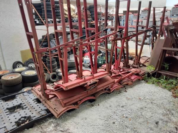

Hey y'all, really appreciating the wealth of knowledge you all are here! Wanted to see if anyone could help me figure out if this type of plow would fit my 1985 312-8.
Photo attached from the craigslist ad.
I tried to do some reading but was still confused. It sounded like I might possibly need some sort of horizontal bar in the rear - any idea if that's true and where I could get one?
I also read that some models require an offset handle so it doesn't hit the right hand foot rest. Can you tell if these have that handle?

Yes, you will need a rear axle bracket.  If the Seller has that manyWH Plows I would be the has a rear axle bracket to throw in with the deal.
You need the long frame for your 312-8.  These frames all appear to be the long frame.   The blades come in 42, 48, and 54" widths.     I prefer the 48" blades as even when angled they clear a path wider than the rear tires.   IMO, the 54" wide blades put too much side load making it difficult to steer.
Yes, you do need the axle mounting bracket.    I would not be concerned about the blade angle lever.  They can easily  be bent or  a spacer added to move them out to clear the brake pedal.

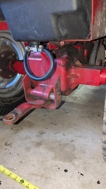

Thanks guys for your input and advice. Here is a photo (need to clean this thing still) of my rear end, with hitch.
The seller said he has a "rear axle bracket" I assume that is all I'm missing back here? Can anyone confirm if there is something else i need to buy?

You will need the rear axle bracket.

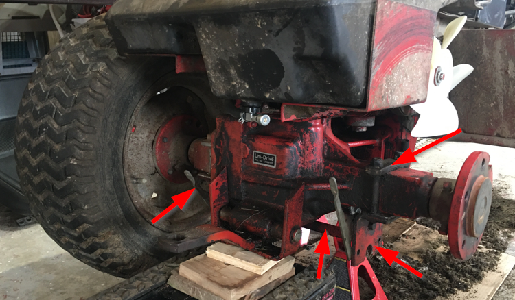

This picture (sorry, this was before some major cleaning took place) shows the rear axle bracket installed:
The rear crossbrace of the plow frame (and some other accessories) use the bottom of this to lock in the slot. The levers lock it in when pulled down.

Yes, the axle bracket is all you need.      If you plan to use the blade for grading dirt, you may want the solid link down pressure bar.    It is normally not required for snow plowing.
I am concerned about the big loop in the fuel line getting caught.        I would turn the valve to the left and shorten the fuel line removing the loop.

Thanks @Ed Kennell will keep that in mind. And you're right, I will put it on the list about cutting that fuel line down a bit
