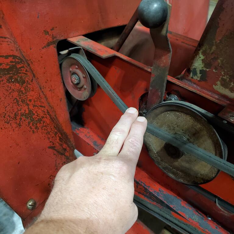

Cjwv1975 67 #1 Posted October 30, 2024 So got my 1054 running, needs some tuning but it runs. Couple of questions though 1. When I turn the key off and press the start button the starters turns, is that right? 2. My drive belt seems very loose is there a way to adjust that some or do I just need a new one? What size do I need? Thanks 1 Share this post Link to post Share on other sites

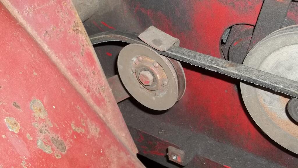

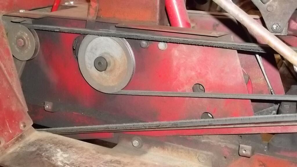

953 nut 57,768 #2 Posted October 30, 2024 4 hours ago, Cjwv1975 said: So got my 1054 running, needs some tuning but it runs. Cleaning you ignition points and adding some Seafoam fuel treatment to the tank should help. Couple of questions though 1. When I turn the key off and press the start button the starters turns, is that right? Yes, the starter will turn over without the ignition key being turned on. 2. My drive belt seems very loose is there a way to adjust that some or do I just need a new one? Take a look at the pictures below, also I an attaching a copy of the owner manual. What size do I need? 1/2" by 82" Kevlar belt from Tractor Supply Thanks Clutch down Clutch up Be sure your belt is on top of the belt guide bar. 1 Share this post Link to post Share on other sites

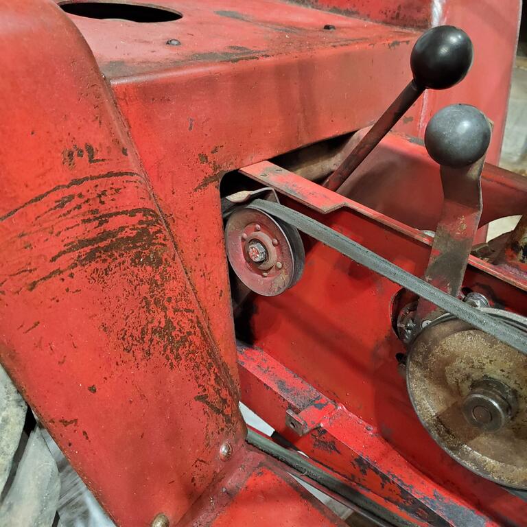

Cjwv1975 67 #5 Posted October 31, 2024 Thats the slack in mine and its flipped upside-down i just realized. Looks like clutch linkage needs adjusted my pulley seems high 1 1 Share this post Link to post Share on other sites
Achto 28,692 #6 Posted October 31, 2024 (edited) 11 hours ago, Cjwv1975 said: Your belt rolling over is a good indication that you need a new belt. Edited October 31, 2024 by Achto 3 Share this post Link to post Share on other sites
953 nut 57,768 #7 Posted October 31, 2024 11 hours ago, Cjwv1975 said: my pulley seems high That is about where all of mine ride with the clutch up. 2 Share this post Link to post Share on other sites
WHX?? 50,638 #8 Posted October 31, 2024 11 hours ago, Cjwv1975 said: its flipped upside-down i just realized. 4 minutes ago, Achto said: belt looks like it has rolled over and is running inside out. I think he said that dingus ... Yes we like the blue ones from TSC. My idler runs high too with a new belt but 82 is the correct belt. Only thing with the TSC belts is they will leave blue on the guard and it seems they need some break in to clutch proper. 3 1 Share this post Link to post Share on other sites
