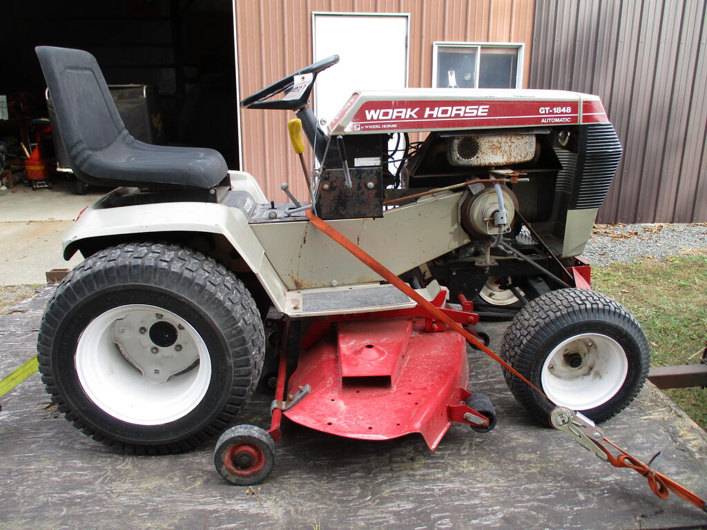

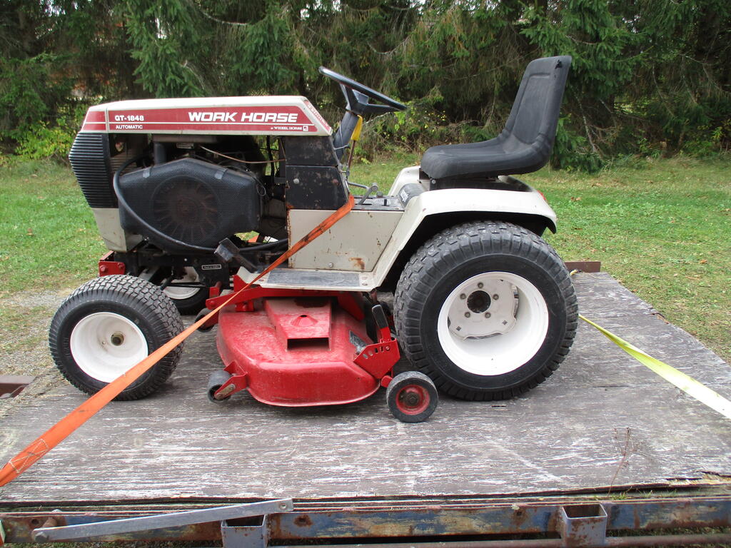

pfrederi 18,322 #1 Posted October 30, 2024 Won this at auction. They said it ran and mowed (yeah like I believe auction houses) Went to pick it up. it would start but barely ran took several tries to keep her running enough to get on the trailer...not looking good but I was really interested more in the nice looking deck. Got her home played around still ran like cr*p. (I had to look up how to adjust B&S carb...all mine are Kohler Techy...) still didn't want to run, drained fuel tank replaced fuel filter she ran better not great but the longer she ran the better she got. and some more carb adjustment now runs well. have ordered carb kit. Hydro seems strong haven't got really hot yet to test. Deck look good and is quiet. Heck the battery is only 4 months old... Not sure what to do with her really didn't expect to win (with tax and fees 300) and have no real need... 4 11 Share this post Link to post Share on other sites
davem1111 2,091 #2 Posted October 30, 2024 Is that the Onan engine? If so, might want to check the seam in the intake manifold. For that price, you bought a nice deck and got a free tractor that looks pretty good. 2 Share this post Link to post Share on other sites
pfrederi 18,322 #3 Posted October 30, 2024 37 minutes ago, davem1111 said: Is that the Onan engine? If so, might want to check the seam in the intake manifold. For that price, you bought a nice deck and got a free tractor that looks pretty good. B&S twin 18hp 2 Share this post Link to post Share on other sites

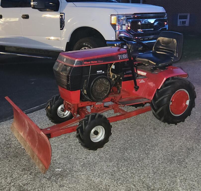

Greg Cullison 76 #5 Posted October 30, 2024 Picked this up two nights ago to push leaves and snow but more importantly to ride my grandson around on. My first Wheel Horse and when I saw it, I had to have it. Still trying to learn more about it but it is a 312-8 with the Kohler Magnum 12. I've attached the VIN plate (blurry). Can anyone tell me what year it is? 3 4 Share this post Link to post Share on other sites
pfrederi 18,322 #6 Posted October 30, 2024 (edited) Welcome. If it read 2112k801 it is 1985 but it would have been a K series not magnum... Edit:\\ If it reads R112K801 it is 1990 and had the magnum engine Edited October 30, 2024 by pfrederi 1 Share this post Link to post Share on other sites
Greg Cullison 76 #7 Posted October 30, 2024 OK, thanks. I read the model # as 31112R801..but a second look makes me agree the R is actually a K? 1 Share this post Link to post Share on other sites
Bill D 2,087 #8 Posted October 30, 2024 (edited) 1 hour ago, pfrederi said: Won this at auction. They said it ran and mowed (yeah like I believe auction houses) Went to pick it up. it would start but barely ran took several tries to keep her running enough to get on the trailer...not looking good but I was really interested more in the nice looking deck. Got her home played around still ran like cr*p. (I had to look up how to adjust B&S carb...all mine are Kohler Techy...) still didn't want to run, drained fuel tank replaced fuel filter she ran better not great but the longer she ran the better she got. and some more carb adjustment now runs well. have ordered carb kit. Hydro seems strong haven't got really hot yet to test. Deck look good and is quiet. Heck the battery is only 4 months old... Not sure what to do with her really didn't expect to win (with tax and fees 300) and have no real need... Contact @Brockport Bill. I know he's wanted one for awhile. Maybe you two can meet up. I love those Briggs. Great engine. Power on par with an Onan, with none of the problems. By far the easiest twin to work on. Basically an early 520 without the wiring nightmares. If you decide not to sell it you'll probably end up loving it. Edited October 30, 2024 by Bill D 3 Share this post Link to post Share on other sites
pfrederi 18,322 #9 Posted October 30, 2024 49 minutes ago, Bill D said: Contact @Brockport Bill. I know he's wanted one for awhile. Maybe you two can meet up. I love those Briggs. Great engine. Power on par with an Onan, with none of the problems. By far the easiest twin to work on. Basically an early 520 without the wiring nightmares. If you decide not to sell it you'll probably end up loving it. Ran her more today actually mowed some. Got the hydro hot hooked it up to my truck and she tried to dig holes. Carb is still finicky on hills (float issue?) Thinking now she may be put on cyclovac duty. Currently using C-175-8 but having better speed choices would speed up process... 4 Share this post Link to post Share on other sites
Bill D 2,087 #10 Posted October 30, 2024 (edited) 2 hours ago, pfrederi said: Ran her more today actually mowed some. Got the hydro hot hooked it up to my truck and she tried to dig holes. Carb is still finicky on hills (float issue?) Thinking now she may be put on cyclovac duty. Currently using C-175-8 but having better speed choices would speed up process... Change all the fuel lines, tank valve and grommet. Also change the vacuum line from engine to carb. The carb can be cleaned and rebuilt on the engine without removing it. If you do decide to remove it for rebuild it can be removed without taking the intake manifold off. Be careful of the little springs in the fuel pump. Plugs are Champion RJ12C. Clean the engine find well and re torque the head bolts. I'd be happy to help with any questions you have Also that hydro should have the same gearing as the 520HC. Faster ground speed when needed. Edited October 30, 2024 by Bill D 3 1 Share this post Link to post Share on other sites

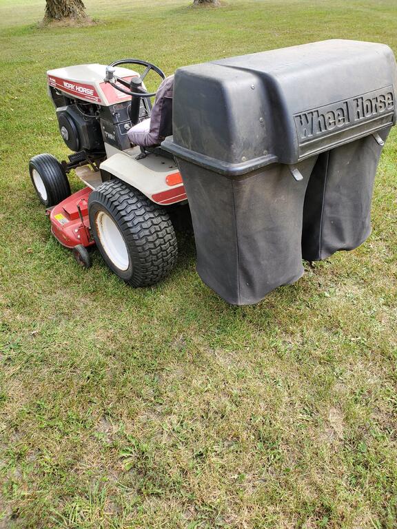

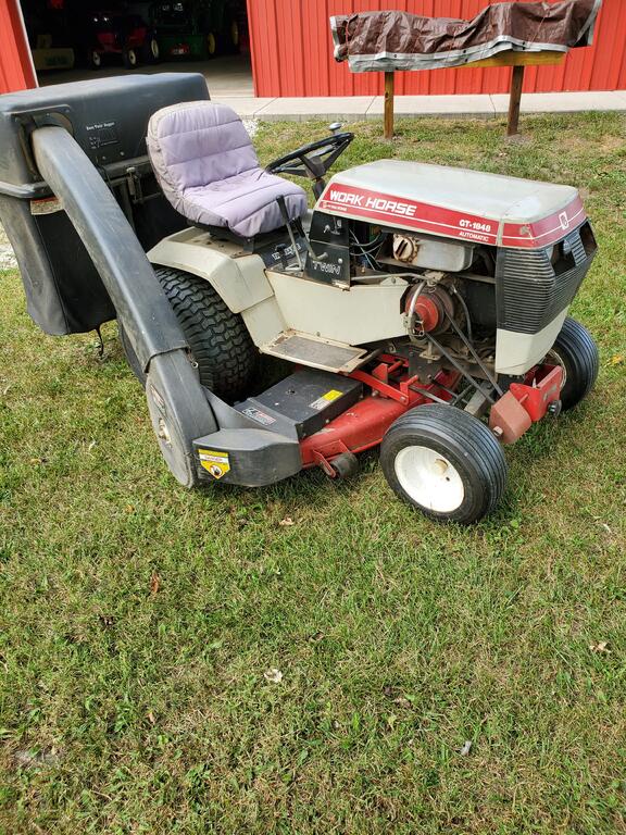

Moparfanforever 874 #16 Posted October 31, 2024 I have two GT1848 's and love both of them!! I Kohler swapped one of them. Your tractor looks very nice!! 4 Share this post Link to post Share on other sites

953 nut 57,839 #18 Posted October 31, 2024 19 hours ago, Greg Cullison said: My first Wheel Horse and when I saw it, I had to have it. Still trying to learn more about it but it is a 312-8 with the Kohler Magnum 12. I've attached the VIN plate (blurry). Can anyone tell me what year it is? Appears to be in real nice condition. It is a 1990 model and if you click on the link below it will take you to all the manuals, service bulletins etc. we have for it. https://www.wheelhorseforum.com/search/?q=31-12K801&quick=1&type=downloads_file 1 Share this post Link to post Share on other sites

Bill D 2,087 #20 Posted October 31, 2024 4 hours ago, Moparfanforever said: I have two GT1848 's and love both of them!! I Kohler swapped one of them. Your tractor looks very nice!! I noticed on your Briggs powered GT1848 there is an extra fan in the outside of the engine tins. I'm guessing that engine has been swapped too? You typically see those on Briggs from Craftsman tractors. What year is that engine? Just curious. Beautiful machines. Share this post Link to post Share on other sites
Moparfanforever 874 #21 Posted October 31, 2024 3 hours ago, davem1111 said: I'm curious about this, because my GT-1848 checks out as a 1982, but has a different lift handle. I'd need to go look but I think mine comes out of the tower, not the horizontal plate, and doesn't have a "cross piece". Maybe it was swapped out at some point - mine has a Honda GX610 engine, who knows what else they did to it. Edit - found this picture, a bit hard to see the handle but it's there: This one you got, I think even if the engine was shot it's still worth at least what you paid for it. Deck, wheels & tires, tins, all looking better than mine when I got it. @davem1111 are you sure the year is right?? My GT1848 with the bagger has that style of hydraulic handle, I think it is an 1984. It has the flat looking gray paint. The GT1848 with the ag tires is a 1982 and has the hydraulic handle in the tunnel cover, the brighter silver paint, and no rubber hood latches. @pfrederi tractor doesn't have the rubber hood latches either. Share this post Link to post Share on other sites
Moparfanforever 874 #22 Posted October 31, 2024 (edited) 14 minutes ago, Bill D said: I noticed on your Briggs powered GT1848 there is an extra fan in the outside of the engine tins. I'm guessing that engine has been swapped too? You typically see those on Briggs from Craftsman tractors. What year is that engine? Just curious. Beautiful machines. Yep,you are correct on the engine swap. Came from an older Craftsman tractor. I don't remember the year of the engine. It does have a fan behind the screen,no leaves or grass collects on the screen I guess due to the fan?? Thanks for the compliment!! @Bill D Edited October 31, 2024 by Moparfanforever Share this post Link to post Share on other sites
