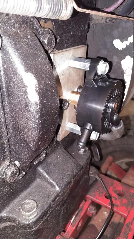

Racinbob 11,718 #2 Posted October 29, 2024 I really like going electric especially on the under the seat tractors. Any of the ones you listed are fine. I mounted a Mr. Gasket 42s like this. It simply made for a clean installation. There was a wire back there already that was hot with the switch on. It was for the seat switch or reverse backup key switch, neither of which are operational anymore. I put the same pump on the 314H but located it elsewhere since the tranny filter was in the way. Two tractors have the cheapy 2 fer < $20 pumps and they are doing fine as well. I just didn't trust them on the more critical workers. The 2005 has a Command engine and I just fed into the fuel pump. The 314, 854 and 76 are fed right into the carb. You can find blank off plates online or simple make them using a gasket as a pattern. 2 3 Share this post Link to post Share on other sites

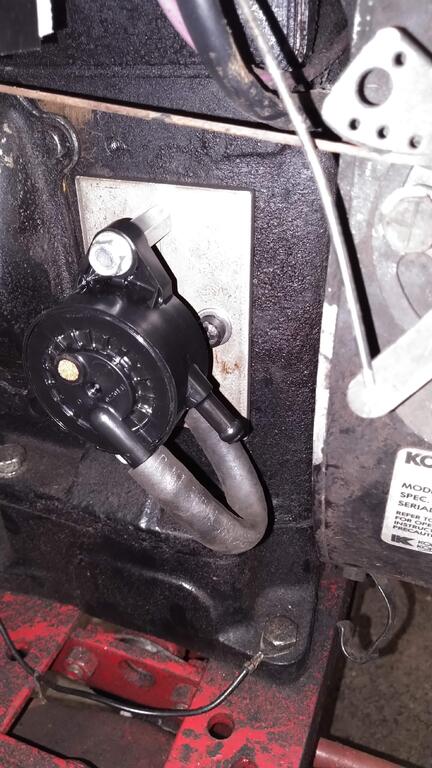

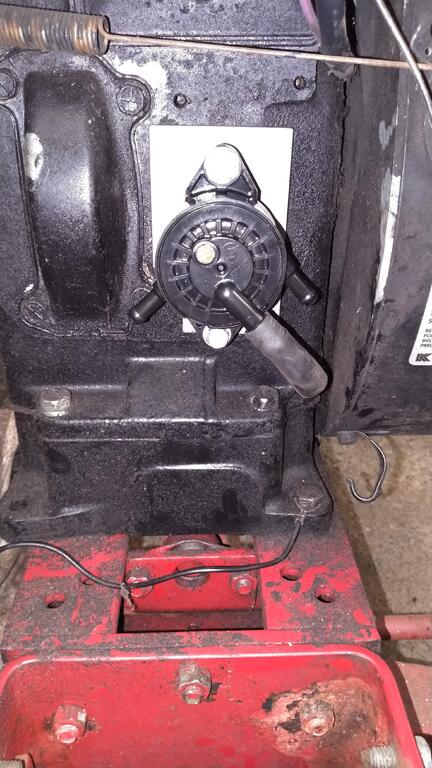

Blasterdad 3,033 #3 Posted October 29, 2024 I put electric pumps on all my 's when the stock pumps go bad, this one is on my C-120. The locations differ between different models, but this location has worked great for me with the gas tank under the hood like yours. As far as your old pump goes you can just leave it on, but I just make my own block off plates by tracing a gasket on a piece of steel & drill two holes, pretty easy to do. This tractor starts INSTANTLY now, no choke, throttle at idle, sitting for a month. I usually wire mine off the Accessory circuit WITH a fuse. 4 1 Share this post Link to post Share on other sites

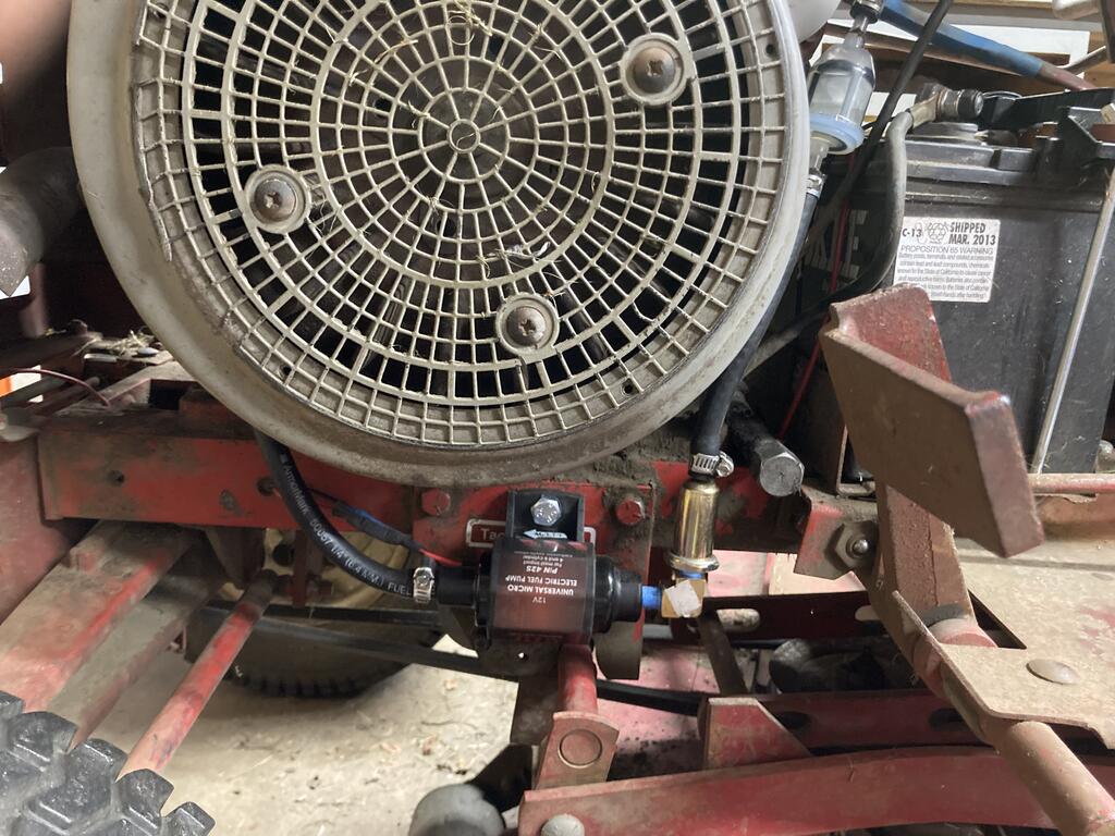

953 nut 57,833 #5 Posted October 29, 2024 On engines with a battery ignition system like yours I install a second wire from the "I" (ignition) terminal on the ignition switch with a fuse to operate the fuel pump. Mine are located in the tunnel where the shift levers/motion controller are located. This keeps them below the outlet of the fuel tank and protected from being hit or snagged by anything. 2 1 Share this post Link to post Share on other sites
