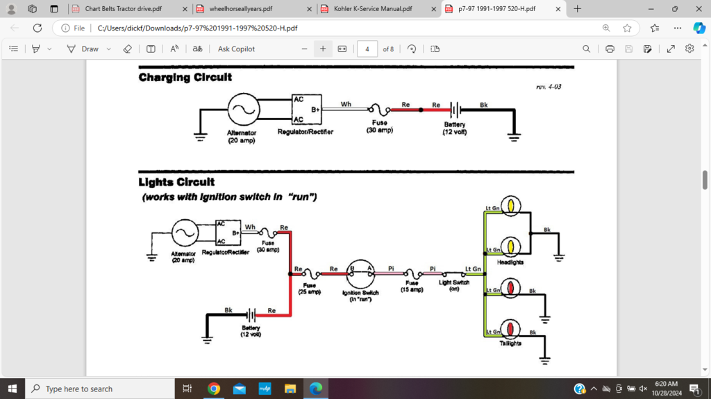

953 nut 57,839 #2 Posted October 28, 2024 The 30 amp fuse is in the path from the voltage regulator to the battery but it is unlikely that the voltage regulator is causing the fuse to blow. Carefully examine the wires to and from the 30 amp fuse and the fuse holder itself. 8 hours ago, Kaenath Pryde said: the fuse just gets hot The fuse getting hot leads me to think the fuse holder may have a bad contact causing resistance resulting in heat which will eventually blow the fuse. When you keep the RPMs low there is less voltage being generated resulting in less heat. Replacing the fuse holder with a new 30 amp weather tight fuse holder should solve the problem. https://www.google.com/search?q=watertight+fuse+holder&rlz=1C1JZAP_enUS981US981&oq=30+amp+weathertight+fuse+holder&gs_lcrp=EgZjaHJvbWUqCggCEAAYgAQYogQyBggAEEUYOTIKCAEQABiiBBiJBTIKCAIQABiABBiiBDIKCAMQABiiBBiJBTIKCAQQABiABBiiBDIKCAUQABiABBiiBNIBCTM0NDE5ajBqN6gCALACAA&sourceid=chrome&ie=UTF-8 Here is a diagram of your charging system. Also, a guide to the electrical system. 2 1 Share this post Link to post Share on other sites
