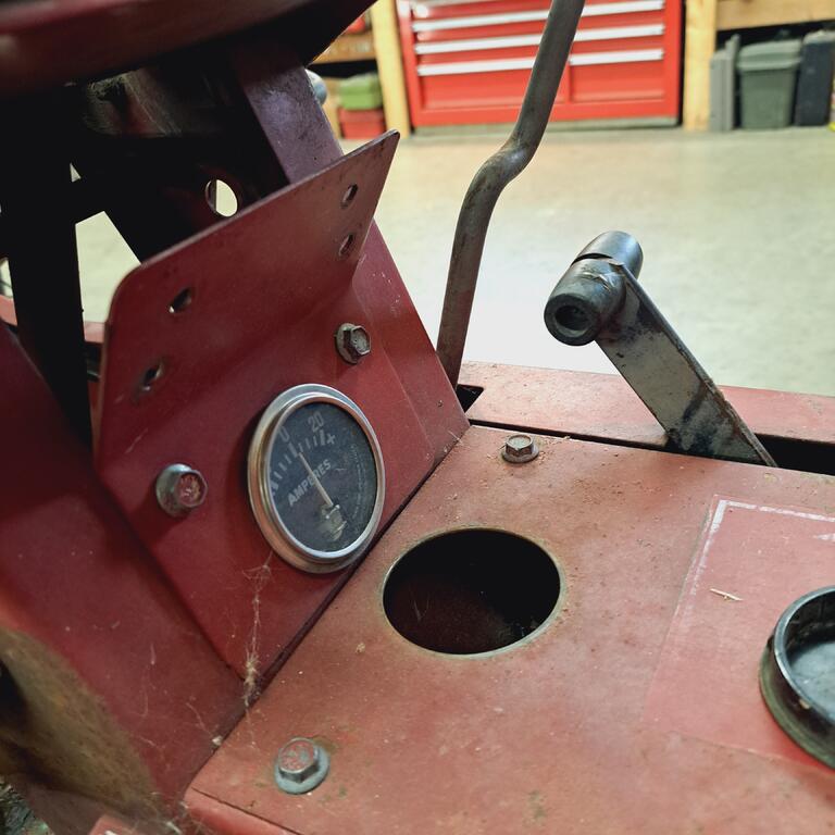

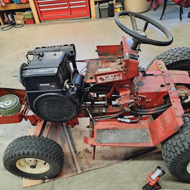

WHX?? 53,326 #1 Posted October 26, 2024 (edited) Alice is always been problematic starting and melted the tip of a fine pocket knife jumping the solenoid. While searching for the gremlin I decided it would be best with a whole new wiring job. PO had replaced the K with a magnum ... guess he had worked at Kohler go figure. Question is should I A) Pull the oil sensor out and plug it? It was not wired in. The safety switches are getting nixed. B Wire it in? C) Just leave it in and tie wrap the wires back? I suck at most things but pretty good at keep an eye on oil. Battery tray came out for cleaning and fix a broken hoobie doo so now would be the time. Edited October 26, 2024 by WHX?? 3 1 Share this post Link to post Share on other sites
953 nut 63,003 #2 Posted October 26, 2024 4 minutes ago, WHX?? said: A) Pull the oil sensor out and plug it? It was not wired in. The safety switches are getting nixed. B Wire it in? C) Just leave it in and tie wrap the wires back? 6 minutes ago, WHX?? said: whole new wiring job. 2 1 Share this post Link to post Share on other sites

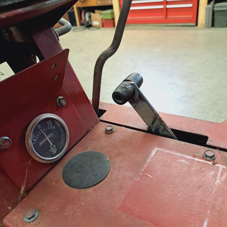

WHX?? 53,326 #8 Posted October 27, 2024 (edited) 18 hours ago, squonk said: " used" scotch lock that @wallfish gave me I give all mine to @Achto ... he uses them religiously ... 23 hours ago, 953 nut said: C) Just leave it in and tie wrap the wires back? Gets the nod. If I ever have to pull balance gears out she will come then. I thought this was odd too. A plug that appears to be factory. Anyone knows what this is was used for? Thoughts are using it for a turbo boost gauge... Prolly end up with a stupid hour meter tho. They just remind one of how little seat time one gets on a tractor. Since this is a dedicated tiller seat time won't be much. Maybe double up the ammeter with a voltmeter?? Note the absence of a regulator... a magnum ... maybe fab a new plate and add a gauge ala @Aldon ?? Edited October 27, 2024 by WHX?? 1 1 Share this post Link to post Share on other sites

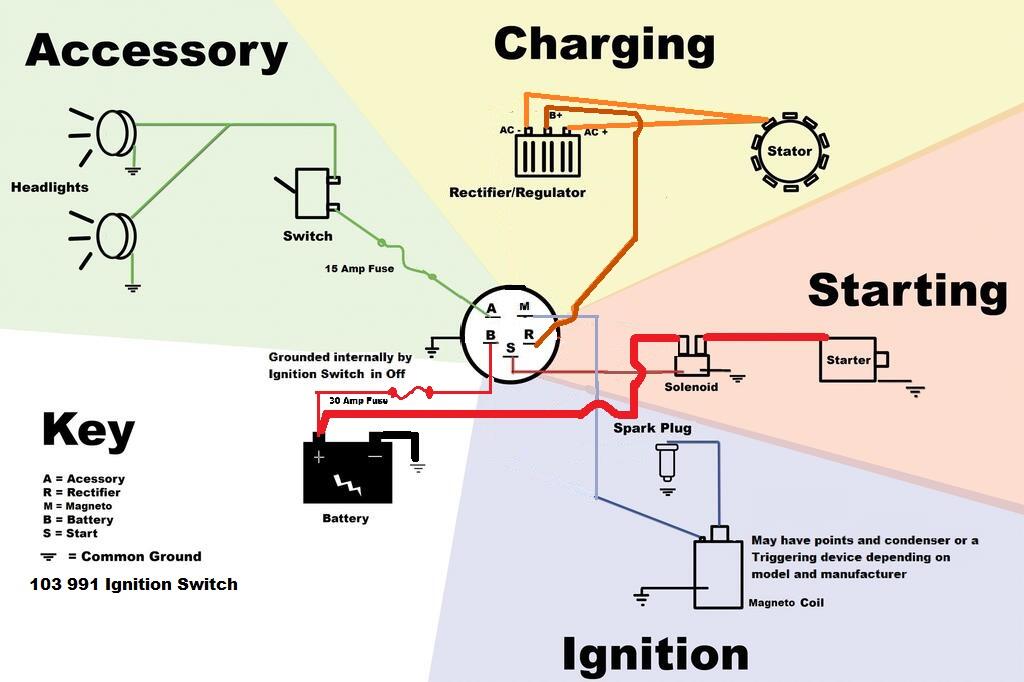

WHX?? 53,326 #9 Posted October 27, 2024 BTW Richard thank you for the wiring diagram but I have that one ... even gave five copies to my mother ... 2 Share this post Link to post Share on other sites

squonk 44,860 #11 Posted October 27, 2024 That hole was for the optional hour meter. My C-160 has one there. 53 minutes ago, WHX?? said: I thought this was odd too. A plug that appears to be factory. Anyone knows what this is was used for? Thoughts are using it for a turbo boost gauge... Prolly end up with a stupid hour meter tho. They just remind one of how little seat time one gets on a tractor. Since this is a dedicated tiller seat time won't be much. Maybe double up the ammeter with a voltmeter?? Optional hour meter. My C-160 has one there. 1 1 Share this post Link to post Share on other sites
953 nut 63,003 #12 Posted October 27, 2024 2 hours ago, WHX?? said: I thought this was odd too. A plug that appears to be factory. Anyone knows what this is was used for? That is where the factory optional spittoon would mount for smokeless tobacco users. 4 Share this post Link to post Share on other sites
