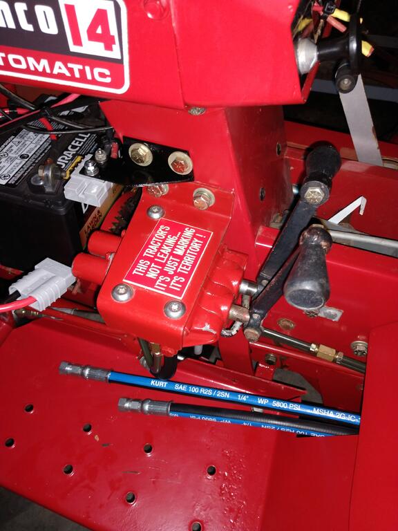

Handy Don 15,171 #8 Posted October 26, 2024 (edited) 15 hours ago, WheelHorseVH said: Anyone done it? Not exactly what you describe but with similar results and learned a ton about hydraulics in the bargain. End result: - two quick-connect hydraulic circuits at the front, one with float - joystick control via cables (from a Fisher) - uses existing Eaton 1100 charge pump circuit (i.e. no additional pump, etc.) - left existing lift cylinder, rock shaft, and control intact so all regular implements can work as they should Key things to know: - ALL WHs using Eaton 1100s need external pressure relief for the charge pump circuit -- all that I’ve seen have it built into the control valves - The max working pressure is ~700 psi. This is good in that simple auto brake line tubing and JIC fittings are plenty adequate and safe. Not as good is that it limits working loads. - The pump volume is ~1.5gpm at max pressure. Plenty for small cylinders but WAY too little for long or fat ones. Here you can see the joystick attached to the left side of the hoodstand (yellow knob) and the control valve above the left front wheel. The black connecting push/pull cables are hard to see! The two-spool with float valve is off a (cough cough) JD425 and carefully painted black! This is the lift mechanism I built for the front that hooks into the front- and mid-attach-a-matics. As you can see, it uses a standard 2” receiver at the top and a scavenged mid-hitch at the bottom latch to hold the implement (in the above picture, a flail mower). We have worked this setup hard at my children’s camp and are extremely happy with it. Our only disappointment is that there is no easy way to make the WH have 4WD or a locking rear diff so we’ve gotten it stuck in mud a couple of times! Edited October 26, 2024 by Handy Don 4 Share this post Link to post Share on other sites

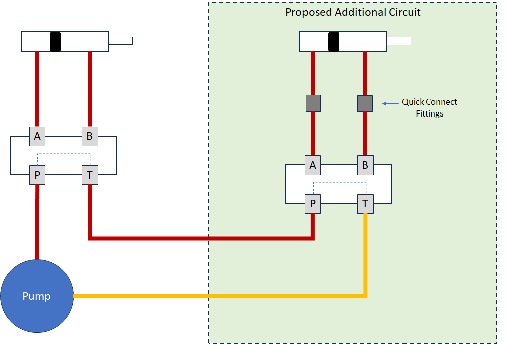

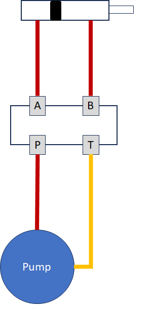

WheelHorseVH 110 #15 Posted October 28, 2024 (edited) Also, please verify the correctness of these diagrams. If anything is wrong or missing please let me know so I can fix. If this works out, it could help someone else in the future. Thank you. First the stock 520H setup: Next, the proposed setup: Edited October 28, 2024 by WheelHorseVH Share this post Link to post Share on other sites
Handy Don 15,171 #16 Posted October 28, 2024 14 hours ago, WHX?? said: I always thought that was called an open center??? They are very similar. In neutral, open center valves open all ports (P, A, B, and T) to a common gallery In neutral, tandem center valves open only the P to T connection. Fluid flows from pump to tank in both, but in tandem, ports A & B being closed locks the cylinder maintaining extend or retract against the load on the cylinder (e.g. a lifted deck or plow) 1 Share this post Link to post Share on other sites
Handy Don 15,171 #17 Posted October 28, 2024 (edited) 2 hours ago, WheelHorseVH said: 1. Would using stock 520H valve and cylinder alleviate the need for another external relief? I am assuming that if 520H valve currently has it built in then it should be fine? 2. Is there anything that I should be aware of if trying to install the quick connect couplers at the front? 1. If each valve in the string has its own internal pressure relief, you will be ok. I used a dual-spool valve without internal relief so I had to add it externally. Note: I strongly advise not even removing the acorn nut covering the pressure adjuster screw on the WH valves unless you know for absolute certain that it needs adjustment and you have the skills and equipment necessary to adjust it correctly (gauges and plumbing). Messing this up can diminish the function of the system and/or damage the pump. 2. Nothing in particular to consider on using quick connect female connectors with internal closure. I used ¼” Pioneer style. General comments: - The extra cylinder, valve, and plumbing will contain fluid once charged. Be sure to check the oil in the transaxle (aka, the tank) after installation to be sure it’s kept at the proper level. - There is very little room inside WH 500’s -- the engineers were ingenious. Rubber hydro hoses are bulky. I ended up using alloy brake tubing both for heat dissipation and space efficiency. Edited October 28, 2024 by Handy Don Share this post Link to post Share on other sites

WheelHorseVH 110 #20 Posted October 29, 2024 Are my diagrams correct? If so, @wallfishwould splitting before the valve work? I think the tandem valve setup @Handy Don is describing would not allow for that because the fluid would simply divert to the non-activated valve unless both valves were being operated simultaneously. Share this post Link to post Share on other sites
wallfish 18,786 #21 Posted October 29, 2024 There are pros and cons to everything. Spool to spool valve plumbing is normal and will work. A divider will ensure both valves have enough fluid volume to operate valves on both at the same time but the volume is split so the speed will be decreased When I made the back hoe a divider was definitely necessary because it would have run too slow and sacrificed some power too while using multiple valves at the same time. Not necessary to use a divider when using them at the same time but it can depend upon the application. Angling a plow, I would just go spool to spool. It will still operate both at the same time but the second one in-line will be slower than the first one because of the fluid being used. Share this post Link to post Share on other sites
Handy Don 15,171 #22 Posted October 30, 2024 3 hours ago, wallfish said: There are pros and cons to everything. Spool to spool valve plumbing is normal and will work. (As long as pressure relief is in place) A divider will ensure both valves have enough fluid volume to CAN operate valves both at the same time but the volume is split so the speed will be decreased When I made the back hoe a divider was definitely necessary because it would have run too slow and sacrificed some power too while using multiple valves at the same time. Not necessary to use a divider when using them at the same time but it can depend upon the application. Angling a plow, I would just go spool to spool. It will still operate both at the same time but the second one in-line will be slower than the first one because of the fluid being used. A divider makes sense only where the pump can adequately supply acceptable volume at useful pressure to the cylinders that will operate simultaneously. The Eaton charge pump is relatively low volume and low pressure. @wallfish’s setup uses a pump with at least 3x the volume and 3x the pressure Plus, a splitter (or diverter) is pricey, complicates your plumbing, and adds friction to the fluid flow. The simplest path is the one you diagrammed--two Eaton-compatible valves, each with internal pressure relief, in series. Alternately, if you really must have simultaneous operation and must stay with a single spool, get the new valve with an N port (power beyond) and a separately plumbed T (tank) port and put that first as described here... Pump --> New Valve P New valve T --> filter input (reservoir) New valve N --> existing valve P (input) Existing valve T (output) --> filter input (reservoir) (It is acceptable to join the two T outputs into a single line going to the filter/reservoir) An advantage to most multi-spool control valves (but NOT all) is they internally have the N to P connections where needed. Share this post Link to post Share on other sites
wallfish 18,786 #23 Posted October 30, 2024 7 hours ago, Handy Don said: A divider makes sense only where the pump can adequately supply acceptable volume at useful pressure to the cylinders that will operate simultaneously. The Eaton charge pump is relatively low volume and low pressure. @wallfish’s setup uses a pump with at least 3x the volume and 3x the pressure I was just throwing that dividing thing out there depending on the application and usage. More for knowledge than anything else. The cylinders he's using ( if the same as WH ) are also more than 3x smaller in volume and the pressure requirements for pushing and or pulling the cylinders probably require 3x less pressure or even less if just moving components compared to digging into the earth like my system was built for. Pressure won't change by dividing, just the volume does. It's all relative to the size of the parts being used and or the application. Share this post Link to post Share on other sites
Handy Don 15,171 #24 Posted October 30, 2024 7 hours ago, wallfish said: Pressure won't change by dividing, just the volume does Absolutely correct. Pressure does come into play, though, when sizing the cylinder diameter and length to get the force needed for the implement. Also correct that the “stock” WH cylinders with small diameter and short throw are appropriate for the volume and pressure of the Eaton charge pump as long at the application doesn’t require more than a few hundred pounds of force over a fairly short distance. I’m using the rear cylinder from a C-195 for my front attachment lift. It has a 2.58” ID so around 3,500 lbs of force at the rod end but over a throw of only 3.5”. Pushing on a lever to get 17.5” of throw reduces the max effective force to only 700 lbs. The stock, smaller, 1.5” ID mid-mount cylinder is good for about 1,200 lbs of force at the rod end. Share this post Link to post Share on other sites
