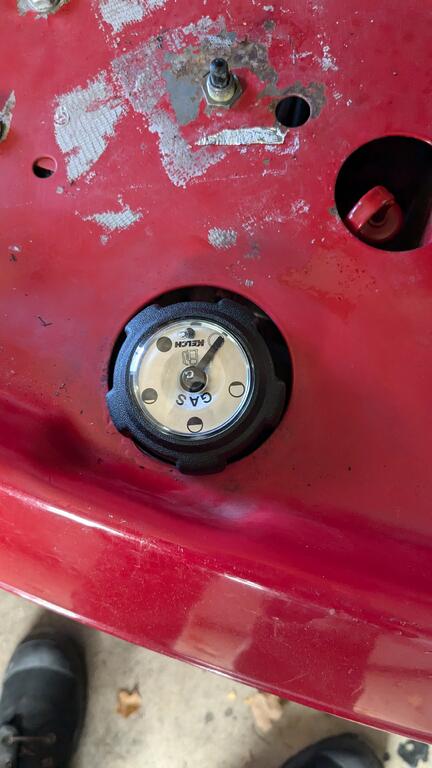

Alrashid2 427 #108 Posted October 27, 2024 (edited) On 10/25/2024 at 9:01 AM, cleat said: Clutch pedal can be adjusted by turning trunnion #22 on clutch rod #14 as shown on attached diagram. Clutch linkage.pdf 81.72 kB · 8 downloads Thanks Cleat. I assume just adjusts where the pedal sits? Maybe I'll just let mine be. I got my Kelch gas cap in by the way! Fits and seems to read properly. Only annoying thing is it's not lined up. I assume that's normal? Also wanted to add that my Amazon voltage meter worked! Replaced today Edited October 28, 2024 by Alrashid2 4 Share this post Link to post Share on other sites

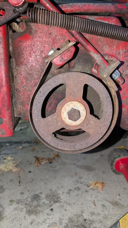

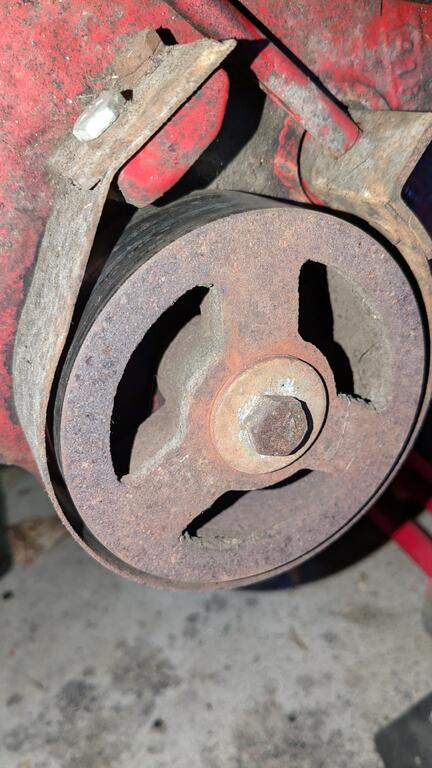

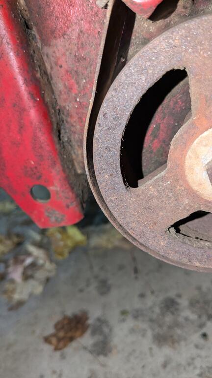

Alrashid2 427 #109 Posted October 28, 2024 On 10/25/2024 at 8:44 AM, rmaynard said: Not to be pushing my brake linings, but when dealing with brakes, sometimes a new lining makes all the difference in the world, not only when stopping, but holding the tractor when the parking brake is set. I sell the linings as does wheelhorsepartsandmore.com Message either of us if interested. Hey brother, finally got to looking at my brakes and am I right in thinking I don't even have a brake lining? It looks like I just have the band and no pad! 1 Share this post Link to post Share on other sites
johnnymag3 2,633 #110 Posted October 28, 2024 Welcome....and yes you are correct... NO BRAKE LINING !!! Time to reline or replace the band...it will operate much better !!! John 1 Share this post Link to post Share on other sites
Alrashid2 427 #111 Posted October 28, 2024 2 minutes ago, johnnymag3 said: Welcome....and yes you are correct... NO BRAKE LINING !!! Time to reline or replace the band...it will operate much better !!! John Yikes! No wonder I was having brake trouble lol! Shocked I am able to stop at all! @rmaynardcould you tell me more about your brake lining? Do you have one for a 312-8? Is it difficult to replace? Id like to buy one from you please! Share this post Link to post Share on other sites

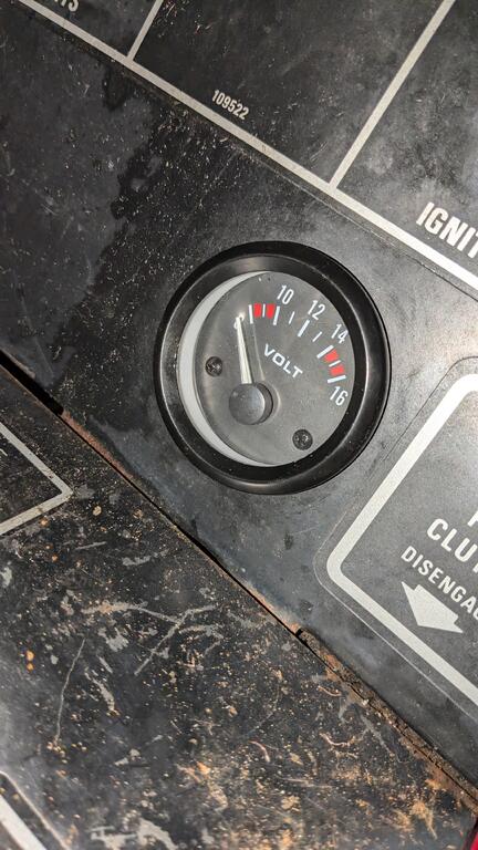

Alrashid2 427 #112 Posted October 28, 2024 Can I also ask you guys 2 more questions? 1. What should the voltage read at full throttle? Saw my voltage was spot on at 15 volts and just wanted to make sure that wasn't too high. Confirmed the new gauge is correct with a multimeter. 2. Am I OK to run the tractor at varying throttle positions? At full throttle the thing is LOUD! I find that lowering it even just a bit reduces the RPMS enough to really quiet it down (not idling of course) and I'm still getting enough speed/power just fine. Just wanted to make sure that wasn't a big no no. Share this post Link to post Share on other sites
Handy Don 15,138 #113 Posted October 28, 2024 (edited) 2 hours ago, Alrashid2 said: Can I also ask you guys 2 more questions? 1. What should the voltage read at full throttle? Saw my voltage was spot on at 15 volts and just wanted to make sure that wasn't too high. Confirmed the new gauge is correct with a multimeter. 2. Am I OK to run the tractor at varying throttle positions? At full throttle the thing is LOUD! I find that lowering it even just a bit reduces the RPMS enough to really quiet it down (not idling of course) and I'm still getting enough speed/power just fine. Just wanted to make sure that wasn't a big no no. 1. 15 is a tad high, but I would not trust that gauge alone to be accurate. Confirm the reading with a decent quality Volt-Ohm meter. 14.5 would be ideal. 2. Yes, tractors are noisy. I always wear ear protection, usually 28db 3M over-the-ear (~$30 and you will thank me in your dotage when you can still hear your grandchildren). The engines are designed to run at full or near-to-full throttle, 3,300 to 3,600 RPM for any sort of extended working period. It's not about power/speed, it's about circulating oil (spashing) and cooling. Edited October 28, 2024 by Handy Don 1 Share this post Link to post Share on other sites
Alrashid2 427 #114 Posted October 28, 2024 2 minutes ago, Handy Don said: 1. 15 is a tad high, but I would not trust that gauge alone to be accurate. Confirm the reading with a decent quality Volt-Ohm meter. 14.5 would be ideal. 2. Yes, tractors are noisy. I always wear ear protection, usually 28db 3M over-the-ear (~$30 and you will thank me in your dotage when you can still hear your grandchildren). The engines are designed to run at full or near-to-full throttle, 3,300 to 3,600 RPM for any sort of extended working period. It's not about power/speed, it's about circulating oil (spashing) and cooling. Thanks for responding! 1. I did confirm it with a multimeter and it read 14.95 Volts. This is at Full Throttle, so not sure if that makes a difference. 2. That is great to know, understood. I'll see if I can grab a tach and find out at what position is 3300 RPM and ensure I don't go below that. Thanks again Share this post Link to post Share on other sites
Handy Don 15,138 #115 Posted October 28, 2024 (edited) 1 hour ago, Alrashid2 said: This is at Full Throttle, so not sure if that makes a difference. It might. Max voltage is always at full throttle but how much it varies over the RPM range depends on your engine model. If it has a voltage regulator, it’ll jump from ~12 (the current voltage in the battery) up to the max at as little as 2500 RPM and then stay there, If you have a diode for converting the generated AC into DC for battery charging, the voltage varies steadily depending on RPM. Of course, the above depends on the state of charge/condition of the battery. Thread is too long for me to read back over it all, but do you have the wiring diagram for your model? Edited October 28, 2024 by Handy Don 1 Share this post Link to post Share on other sites
Alrashid2 427 #116 Posted October 28, 2024 1 hour ago, Handy Don said: It might. Max voltage is always at full throttle but how much it varies over the RPM range depends on your engine model. If it has a voltage regulator, it’ll jump from ~12 (the current voltage in the battery) up to the max at as little as 2500 RPM and then stay there, If you have a diode for converting the generated AC into DC for battery charging, the voltage varies steadily depending on RPM. Of course, the above depends on the state of charge/condition of the battery. Thread is too long for me to read back over it all, but do you have the wiring diagram for your model? Thanks for the reply. I do have the wiring diagrams yes, but not the best at reading them! I suppose if everything is all working well, then no issues. Battery is a 2018 and seems fine and holds a charge. Figured if something was wrong it would have ruined that battery by now but wanted to check! Another random question here: after looking at pictures of other Wheel Horses, I realize mine is missing the headlight bevels! Are they necessary or purely cosmetic? I was going to get a set but for $40 I rather just let them be if it's not a big deal. I'm only on 1.5 acres with neighbors so don't foresee ever running at night anyhow Share this post Link to post Share on other sites

kpinnc 16,174 #118 Posted October 29, 2024 8 hours ago, Alrashid2 said: Thanks for the reply. I do have the wiring diagrams yes, but not the best at reading them! I suppose if everything is all working well, then no issues. Battery is a 2018 and seems fine and holds a charge. Figured if something was wrong it would have ruined that battery by now but wanted to check! Your charging system responds directly to the load your battery requires of it. In short- I wouldn’t be concerned with a 15vdc charge rate right after cranking. Several of my machines peak at 16vdc immediately after starting, and taper off to around 13vdc after 20-30 minutes of charging. 4 Share this post Link to post Share on other sites
953 nut 62,979 #119 Posted October 29, 2024 The condition of the battery and the connections to the battery can make the charging system work harder. Clean and tighten ALL electrical connections including grounds. Any corrosion or looseness acts as a resistor and interferes with proper charging. Share this post Link to post Share on other sites
