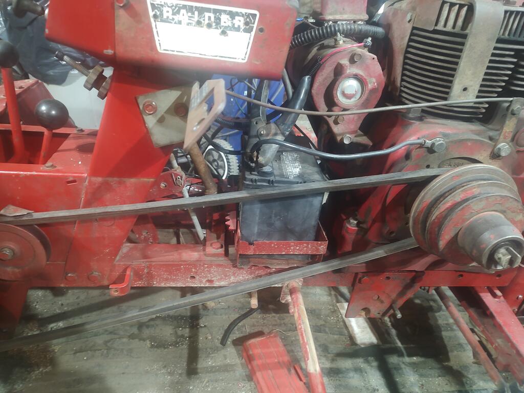

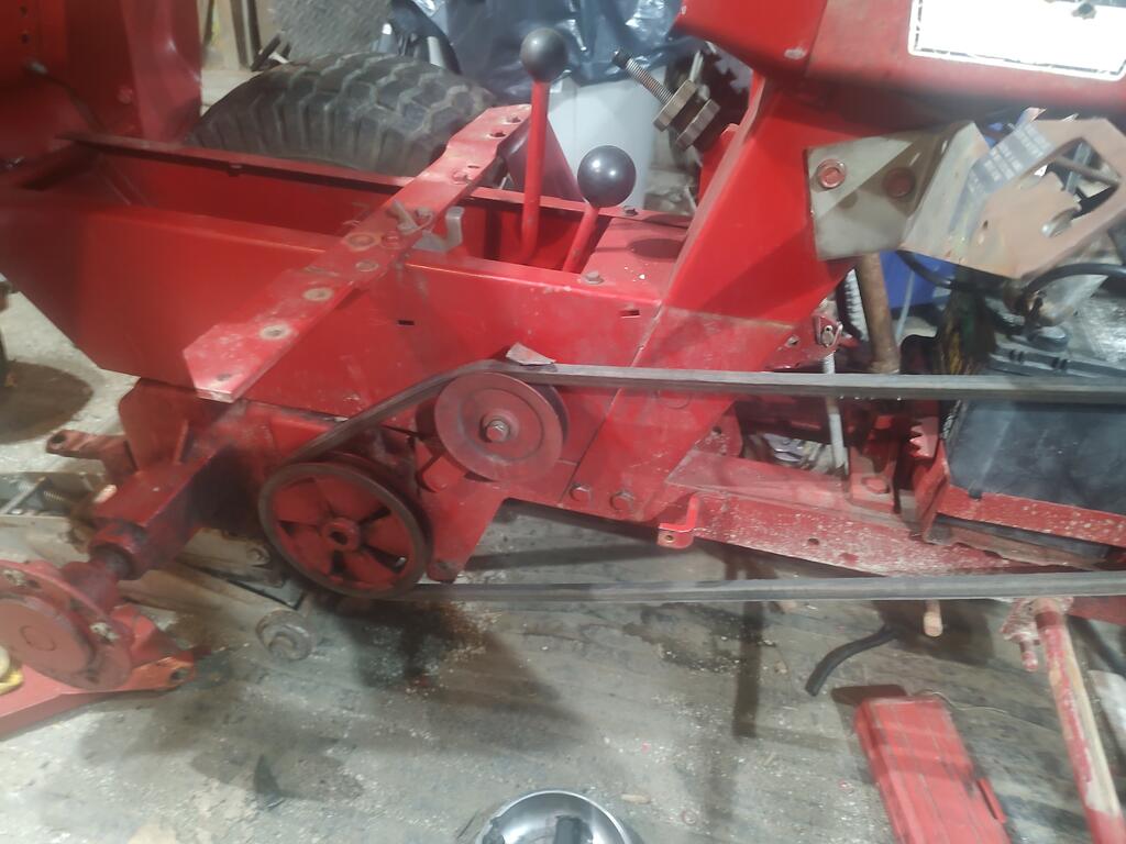

jtrosp1980 89 #1 Posted October 19, 2024 (edited) I have 3 raiders all high low transmission I can not figure out I have wheelhorses drive belt 7473 how to get belt to operate right for the transmission I'm smoking a belt took it back off I bent the pulley guide with no success any help would be appreciated Edited October 19, 2024 by jtrosp1980 Share this post Link to post Share on other sites

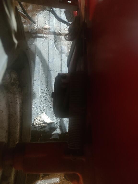

jtrosp1980 89 #3 Posted October 19, 2024 Changed clutch spring pictures included Share this post Link to post Share on other sites
ri702bill 8,938 #4 Posted October 19, 2024 Are you using the Belt Guard installed correctly for each?? Share this post Link to post Share on other sites

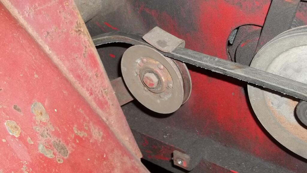

Ed Kennell 40,388 #5 Posted October 19, 2024 If the belt guard on the idler pulley is the adjustable type (not welded) ,try rotating it CCW so it is right at the contact point of the belt on the pulley. The guard may be contacting the belt before the belt is disengaged. 1 Share this post Link to post Share on other sites

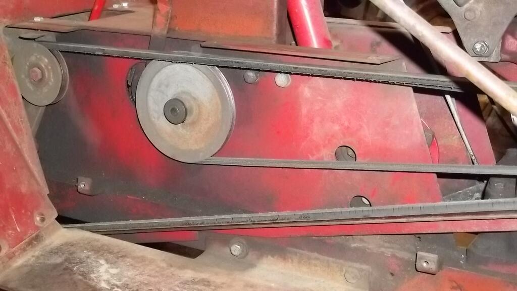

953 nut 57,740 #7 Posted October 19, 2024 11 hours ago, jtrosp1980 said: I'm smoking a belt Please define "Smoking the Belt" 11 hours ago, jtrosp1980 said: 3 raiders Is this a problem on all three or just this one Raider? Is the drive pulley on the engine pictured the same size as the other two Raiders? is the top cross section width on all three belts 21/32"? Some aftermarket belts being sold under the Wheel Horse number are nearly 1/8" wider making then ride higher in the pulley which results in them being effectively shorter. 2 hours ago, Ed Kennell said: If the belt guard on the idler pulley is the adjustable type (not welded) ,try rotating it CCW so it is right at the contact point of the belt on the pulley. The guard may be contacting the belt before the belt is disengaged. Like Ed was saying, with the clutch down the belt tab should slightly contact the belt as in the first picture, with the clutch released it should not touch as in picture two. Share this post Link to post Share on other sites
jtrosp1980 89 #8 Posted October 19, 2024 It is welded the top of belt got chewed the belt won't stop to put in a gear Share this post Link to post Share on other sites
953 nut 57,740 #9 Posted October 19, 2024 2 minutes ago, jtrosp1980 said: belt won't stop to put in a gear The belt guard MUST be in place to catch the slack from the belt when the clutch is depressed. 1 Share this post Link to post Share on other sites
jtrosp1980 89 #10 Posted October 19, 2024 Belt guide was on same issue Share this post Link to post Share on other sites

Ed Kennell 40,388 #13 Posted October 19, 2024 Is there any sign of a missing tab on the belt guard that would be in the same location as the one shown in my video? Share this post Link to post Share on other sites
953 nut 57,740 #14 Posted October 19, 2024 5 hours ago, jtrosp1980 said: Yes YES what? we asked several questions. Share this post Link to post Share on other sites
jtrosp1980 89 #15 Posted October 19, 2024 (edited) Sorry the yes I am having the same issue with all 3i figured of I get one then I'm doing better than I was Edited October 20, 2024 by jtrosp1980 Share this post Link to post Share on other sites
jtrosp1980 89 #16 Posted October 19, 2024 (edited) No the tab is on the side on the belt guide we're the step goes the belt I bought from a wheelhorses place many many years ago it was a original wheel horse drive belt I straightened the tab it helped some I can now get it in gear still has some squeak and little rub burn but better than it was I adjusted the petal and shortened the spring for the petal Edited October 20, 2024 by jtrosp1980 Share this post Link to post Share on other sites
