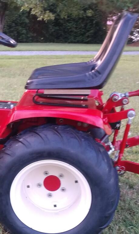

Lee1977 6,917 #9 Posted October 18, 2024 5 hours ago, Maz91 said: My ‘71 raider 12 had no springs. (Just for the record) I'm a blind welder is the reason I didn't add this picture to the build. Got old and can't see. I add the 1/8" x 2" flat to the front and a 2"x2" x 1/8" angle to the rear. Also added some 1" square tube on top of the fender with a few washers to raise the front of the seat. The fender also hinges off a 3/4" rod welded in the seat frame. where is also a fender latch at the front . 1 Share this post Link to post Share on other sites
