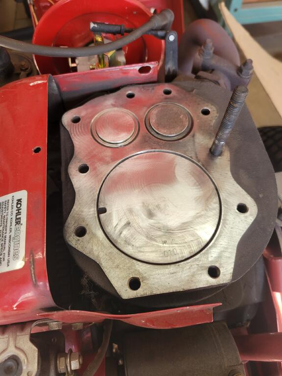

mrc 859 #5 Posted October 17, 2024 got the piston and valves decarboned with a roloc disc 2 3 Share this post Link to post Share on other sites
