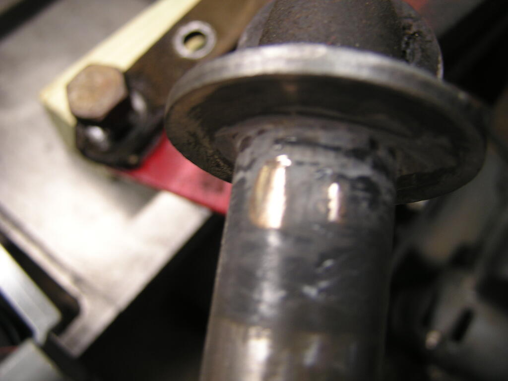

grinchsr 642 #1 Posted October 12, 2024 If I put a lot of grease on my axle will it solve my wear problem? 5 Share this post Link to post Share on other sites
ri702bill 8,951 #2 Posted October 12, 2024 Nope - not even Slippery Pete's favorite green grease will "fix" that. I have had good success welding them up with a tungsten - steel filler rod and hand filing them back to shape... 3 1 Share this post Link to post Share on other sites

ebinmaine 70,657 #5 Posted October 12, 2024 Just now, grinchsr said: Hi Eric it is from a 417 with 8” As long as the vertical part of the spindle is OK I'd still use them. The advantage to a 6" wheel spindle is the added height for forest travel. 1 Share this post Link to post Share on other sites
peter lena 9,085 #6 Posted October 12, 2024 @grinchsr @ri702bill , also bet that wheel was SHUCKING / SLAMMING SIDE TO SIDE . without enough spacing washers to snug up the fit , of course a good lube helps out , those bearings are not the best , by design / availability , that 5 lug conversion by @ebinmaine sounds interesting , also probably has a lot of experimental time on its set up , could be worth a try , pete 2 Share this post Link to post Share on other sites
grinchsr 642 #7 Posted October 12, 2024 Ok let my look at them again I didn’t look at the vertical shaft after looking at the horizontal. 2 Share this post Link to post Share on other sites

WHGuy413 2,771 #12 Posted October 13, 2024 I don’t know what you are talking about that spindle looks perfect to me! all kidding aside I have seen them repaired by a welder and then reworked to the roundness needed. Hope you can save it. IMG_8857.webp 1 Share this post Link to post Share on other sites
johnnymag3 2,559 #13 Posted October 14, 2024 which side is that Ray..... I have a new one you can have, if its the correct side john 1 Share this post Link to post Share on other sites
grinchsr 642 #14 Posted October 14, 2024 Thanks for the offer John but I had what I needed in my stash. 2 Share this post Link to post Share on other sites
