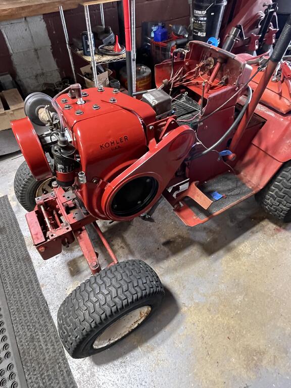

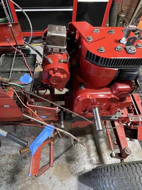

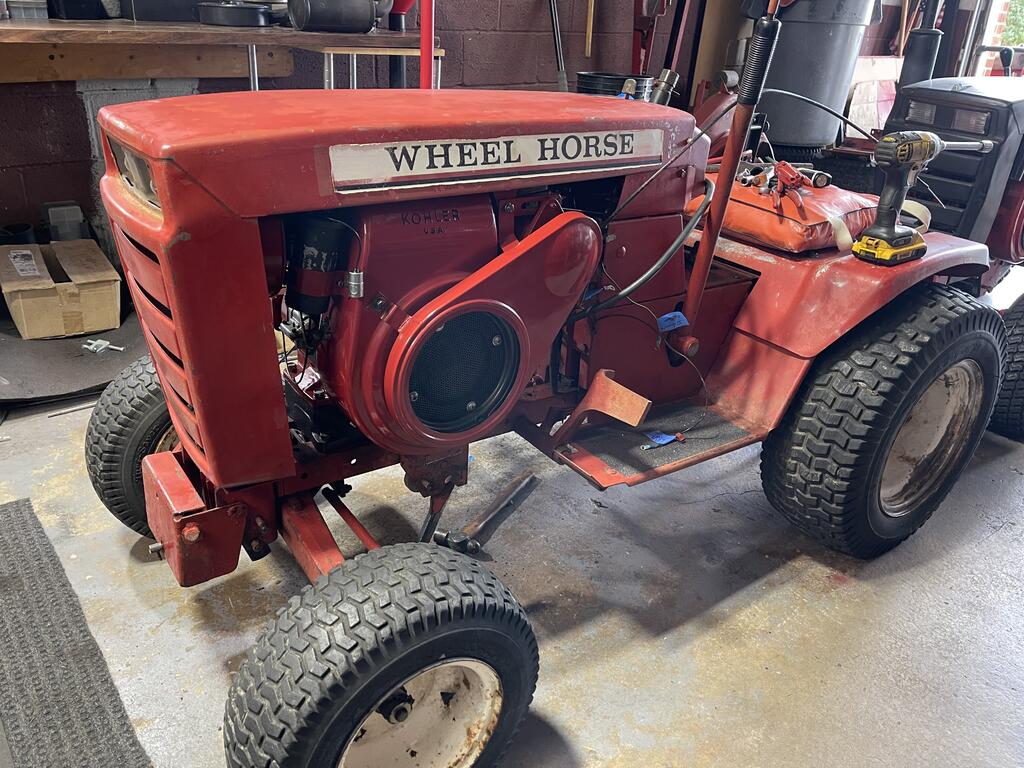

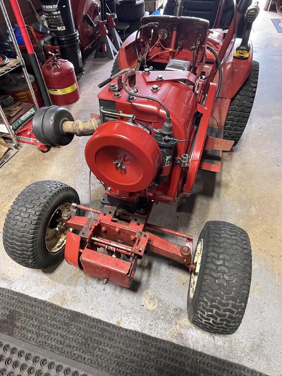

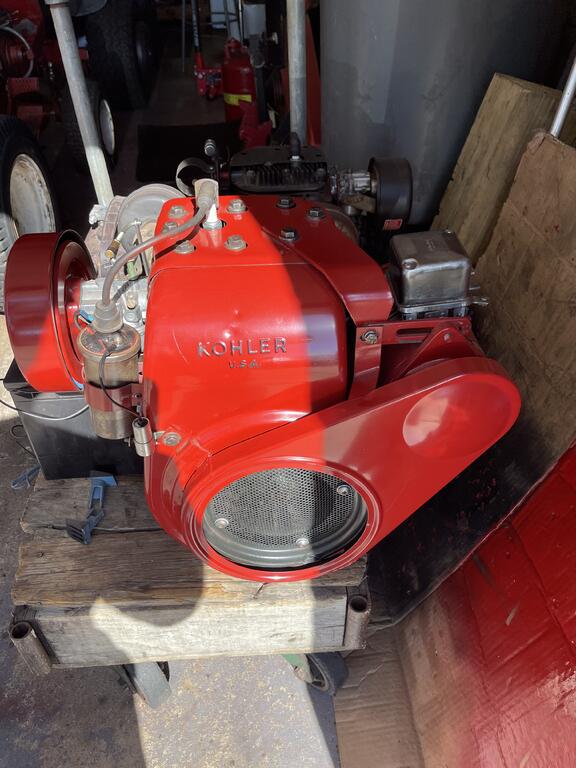

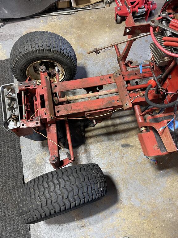

Wheelhorse#1 1,629 #7 Posted Wednesday at 05:38 PM (edited) Well, last couple days I spent working on the engine swap for the C-101 The pan on the old gen start k301 didn’t have the correct pan with the blind holes under the pan needed to attach to the frame but I had a spare parts motor a k321 that had the correct pan so just a matter of swapping them out. Today I dropped the engine and it fits great.Looks like room for the original Nelson exhaust too. Thanks for the tip on the pan @ebinmaine I most certainly would of done twice the work. I didn’t think of that in hindsight at all. Now the plan is to tear it all back down ,strip and paint it and what ever els needs doing over the winter. A couple pic Edited Wednesday at 05:39 PM by Wheelhorse#1 1 3 Share this post Link to post Share on other sites
