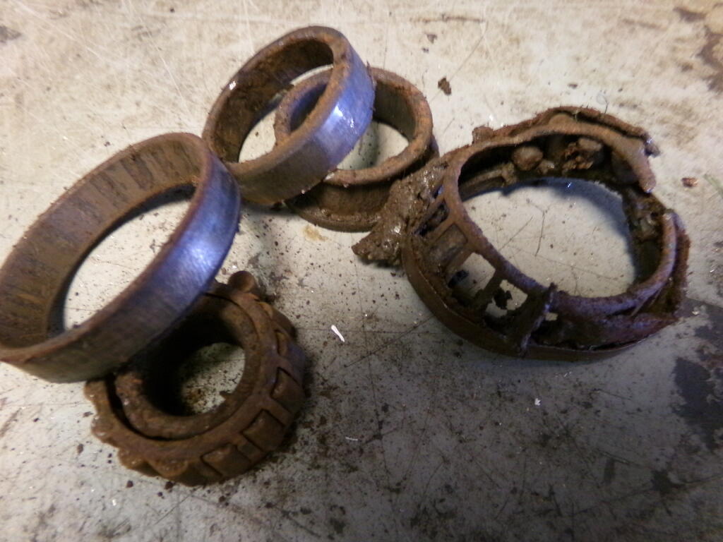

Ed Kennell 39,731 #1 Posted October 11, 2024 (edited) I bought this boat and trailer and was told by the PO the trailer bearings were just replaced. I launched the boat 4-6 times in salt water last year. Yesterday I pulled it out of the barn and both wheels slid on the concrete. The hubs were almost as tight as a 60 yo Wheel Horse hub. This is what I found. No sign of grease in the hubs. Went to NAPA to get 4 new bearings and 2 seals (China). They had them but were really proud at $113. 36. Edited October 11, 2024 by Ed Kennell 1 7 Share this post Link to post Share on other sites

Ed Kennell 39,731 #12 Posted October 12, 2024 18 hours ago, lynnmor said: It doesn’t matter much what you pay for bearings if they will take regular salt baths. True Lynn. I've had good luck keeping the salt water out of 5-6 boat trailers for many years. Gotta have a good inner grease seal and seal the outside cap to the hub. I have used sleeves cut from bicycle inner tubes, condoms, and electrical tape. Unfortunately I never sealed this one when I bought it. I don't think it would have mattered though as there was no grease in the hub. The new bearings and hubs are now packed with sticky marine grease and the end caps are sealed with tape and plastic ties. 1 3 Share this post Link to post Share on other sites
