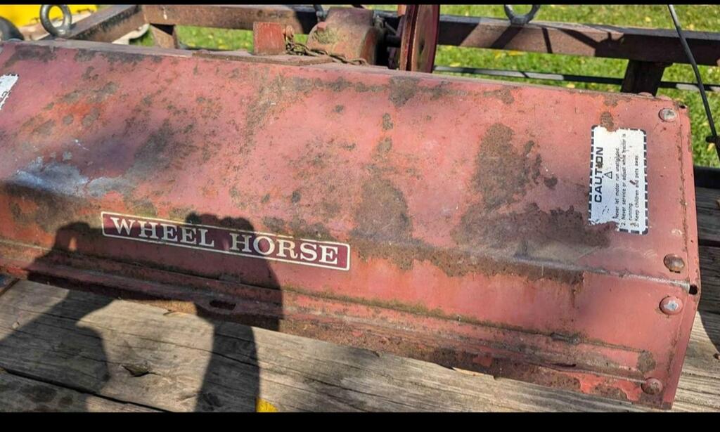

Rockcrawler69 15 #1 Posted October 11, 2024 Hello, I found the charts that show what rototiller fits which years, but the tiller I'm looking at doesn't have a model number on it. Is anyone able to tell by looking at it to see if this will work on a 1993 416-8 manual or a 1996 520 hydro? The guy only has the tiller so I'll end up having to piece the rest together. 4 Share this post Link to post Share on other sites

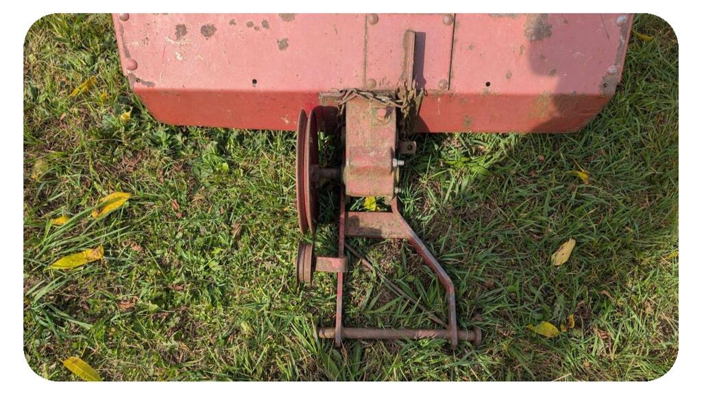

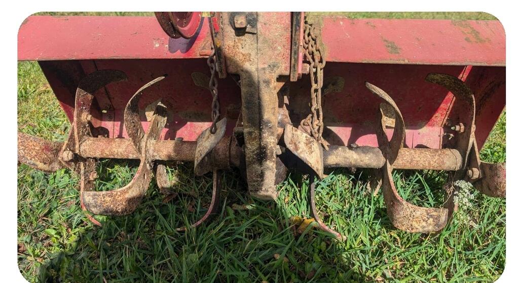

c-series don 9,424 #2 Posted October 11, 2024 That will work, however you will need the pulleys that clip into the mid-mount Tach-A-Matic, rear axle mount and lift cable. Good news is that those tines on that tiller are in great shape with plenty of life left in them. 5 Share this post Link to post Share on other sites
gwest_ca-(File Mod) 11,241 #3 Posted October 11, 2024 This is the tiller both your tractors used with the 416-8 the better choice in my opinion. Will give you an idea what else is required. 3 Share this post Link to post Share on other sites

Monstrosity 1,146 #7 Posted November 2, 2024 On 10/10/2024 at 9:24 PM, c-series don said: That will work, however you will need the pulleys that clip into the mid-mount Tach-A-Matic, rear axle mount and lift cable. Good news is that those tines on that tiller are in great shape with plenty of life left in them. Wheelhorsepartsandmore.com has the pulley setup with tension spring. Cheapest easiest and brand new! Don't waste time scouring ebay or FB marketplace . 1 Share this post Link to post Share on other sites
