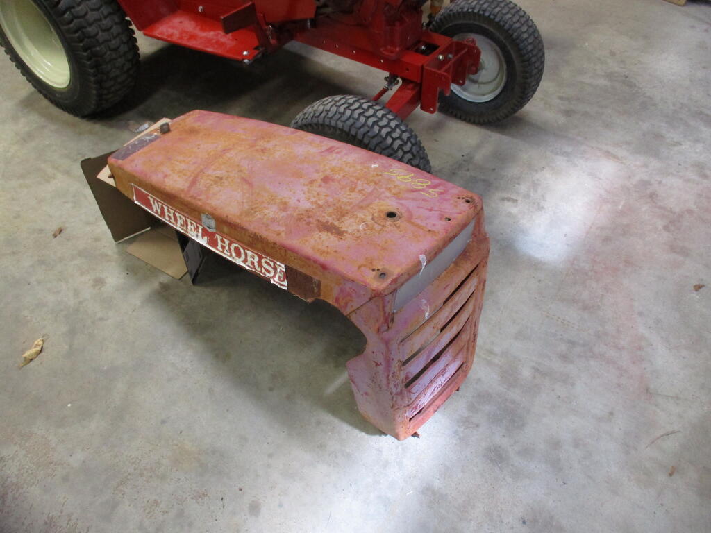

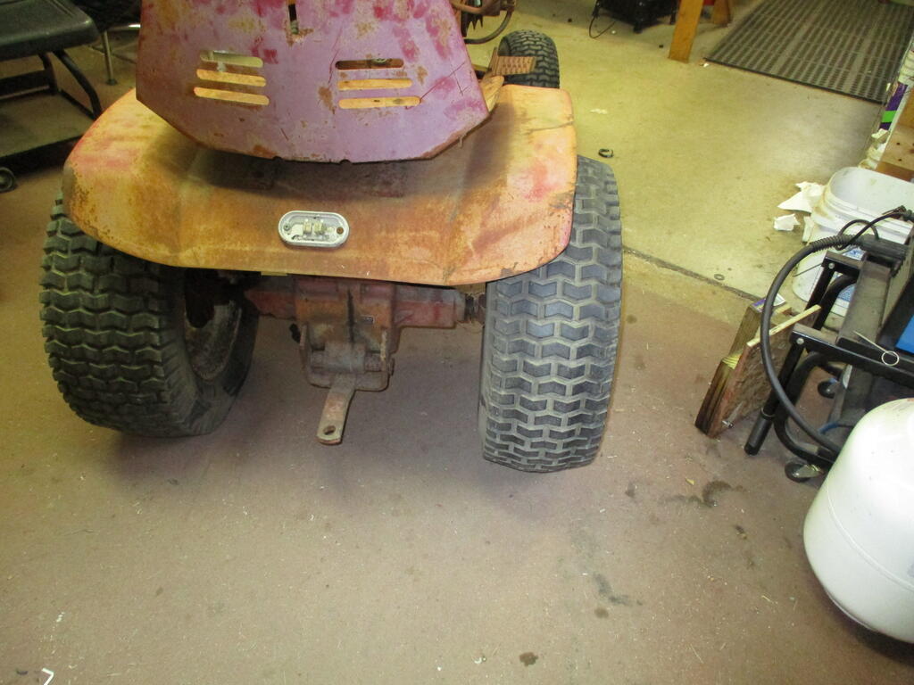

pfrederi 18,314 #1 Posted October 10, 2024 Been working on this C-160 since last fall. Engine completely overhauled tranny resealed. Looks better than she did....but I do not enjoy sanding prep painting etc The hood that came with her was chopped a bit and has holes. I have a similar hood that is not cut. I am thinking of trying the Marvel Mystery oil or some other wipe on finish as opposed to serious stripping repainting. What would you all do... 6 Share this post Link to post Share on other sites
peter lena 9,074 #2 Posted October 10, 2024 @pfrederi personal experience is a simple 2 step process , use an aerosol penetrating oil to totally spay down the areas , let it sit for days , then a clean oiled soft cloth , never sandpaper , for an initial wipe down , might even break thru the grunge , then I use a mineral oil rub down , if its going to break thuu , the mineral oil will do it . at that stage , like a 6" electric palm buffer , with cleaning wax , all the time you are retaining patina and original base coating . think the older units look best with oiled patina look , never shinny just clean and rust free. recovered a lot of neglect with this process, like to leave them in the sun , to heat up and draw in the lubrication , do the same thing on mower decks . patina look and rust free , pete 1 1 Share this post Link to post Share on other sites
ebinmaine 70,541 #3 Posted October 10, 2024 On my 1974 C160-8 with the Tecumseh engine I used a 3M Scotch-Brite that was the coarser of them. Maroon. Brown. I don't know what color we want to call that. In principle the idea worked out well but in reality it was a little too coarse. It worked absolutely excellent in removing the dirt, grime, dust, whatever had accumulated over the nearly 50 years.... But it was a little too aggressive on what paint was left on the tractor. I do have one other 1975 C160-8 with a Kohler engine that I'll be building in the future. That has nice straight ish sheet metal so I'm very likely to try using a finer grade of those Scotch brake pads to see how it comes out. I'm not sure on what chemical but it does kind of bug me that soaking something with oil would present serious paint adhesion problems later if I decided to strip and recoat. I just used water this last time. 2 1 Share this post Link to post Share on other sites
SylvanLakeWH 27,385 #4 Posted October 10, 2024 Try this: Used for years on old colored fiberglass boats... Just rub it on. 5 1 1 Share this post Link to post Share on other sites
squonk 42,450 #5 Posted October 10, 2024 Scotch Brite pad then Penetrol 4 Share this post Link to post Share on other sites
ebinmaine 70,541 #6 Posted October 10, 2024 38 minutes ago, squonk said: Scotch Brite pad then Penetrol Which Scotch Brite do you use Mike? 1 Share this post Link to post Share on other sites
squonk 42,450 #7 Posted October 10, 2024 1 hour ago, ebinmaine said: Which Scotch Brite do you use Mike? What ever one happens to be in the drawer! 2 Share this post Link to post Share on other sites
ebinmaine 70,541 #8 Posted October 10, 2024 7 minutes ago, squonk said: What ever one happens to be in the drawer! Fair 1 Share this post Link to post Share on other sites
953 nut 57,749 #9 Posted October 10, 2024 As good as the rest of the tractor looks it would look very odd with a patina hood. Sand it, paint it, you will love it. 4 Share this post Link to post Share on other sites
kpinnc 13,656 #10 Posted October 11, 2024 (edited) If you want to paint without sanding as much, a wire brush on a cordless drill is way easier than sandpaper. I’m sorta lazy, and it works well for me. Edited October 11, 2024 by kpinnc 5 Share this post Link to post Share on other sites
squonk 42,450 #11 Posted October 11, 2024 (edited) Another option would be either a Harbor Freight surface conditioning tool or if time isn't a concern a large electrolysis tank and cook the hood for about a week. Edited October 11, 2024 by squonk 5 Share this post Link to post Share on other sites
Pullstart 64,436 #12 Posted October 11, 2024 Whatever you have done to the tractor, it’ll take much less time with the hood alone. Do the same, you’ll be glad you did! 5 Share this post Link to post Share on other sites
rmaynard 15,900 #13 Posted October 11, 2024 I don't think the question should be "patina or refinish", but rather "rust or refinish". I say refinish. 5 1 Share this post Link to post Share on other sites
Ed Kennell 40,395 #14 Posted October 11, 2024 Here's one I had everything painted but the hood. Just couldn't bring myself to destroy the hood patina, so I got a two tone. 4 Share this post Link to post Share on other sites
pfrederi 18,314 #15 Posted October 12, 2024 Okay you guys shamed me into it. Ordered the HF Resurfacing tool ...will see how it goes... 3 1 Share this post Link to post Share on other sites

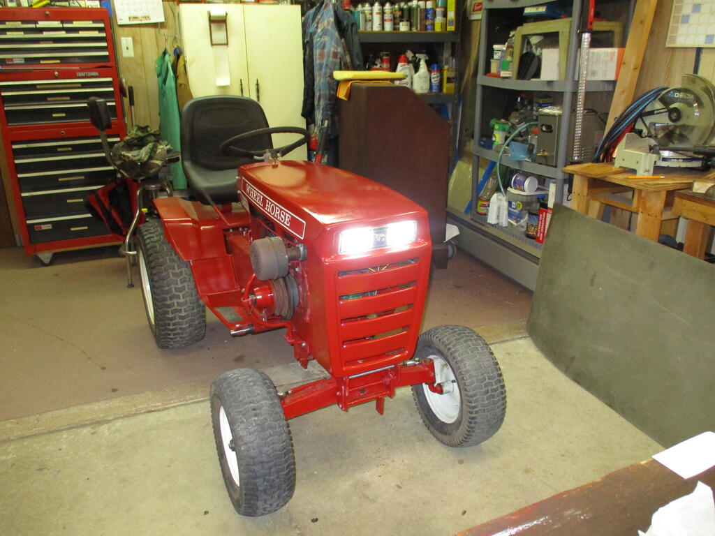

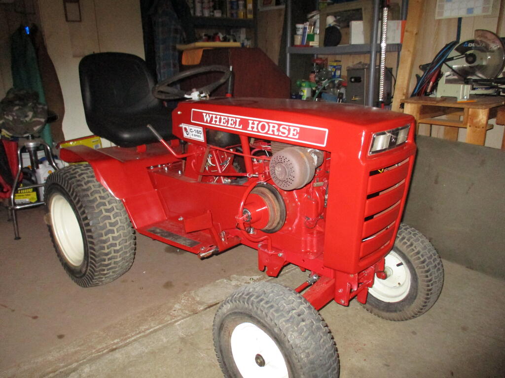

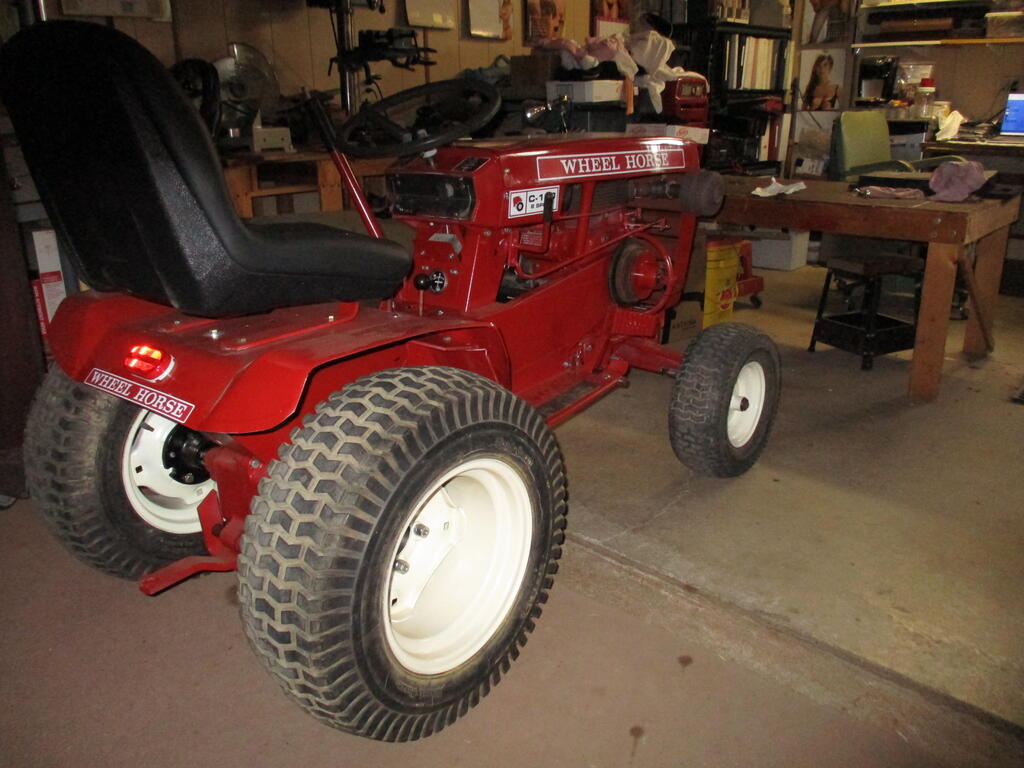

pfrederi 18,314 #16 Posted November 15, 2024 About finished found a correct hood and refinished it......need to get a correct steering wheel maybe new headlight lens. Engine overhauled 10 over and under, new valves, guides were in spec per machine shop, and (I am sure this will elicit groans) new balance gears and shafts. The last 341 l left out the balance gears and the vibration was too much for me...it is on long term loan to a neighbor. Terry's decal really make her look better than she is... my paint job is 50/50 Only issue...not sure what to do with her...don't really have a use for her..... 2 4 Share this post Link to post Share on other sites
ebinmaine 70,541 #17 Posted November 15, 2024 5 minutes ago, pfrederi said: About finished found a correct hood and refinished it......need to get a correct steering wheel maybe new headlight lens. Looks great Paul!! 5 minutes ago, pfrederi said: Engine overhauled 10 over and under, new valves, guides were in spec per machine shop, and (I am sure this will elicit groans) new balance gears and shafts. The last 341 l left out the balance gears and the vibration was too much for me...it is on long term loan to a neighbor. Nothing with with NEW balance gears AND SHAFTS. That's where I believe folks go wrong. The shafts wear out just as much as the gears and bearings. 5 minutes ago, pfrederi said: Terry's decal really make her look better than she is... my paint job is 50/50 Only issue...not sure what to do with her...don't really have a use for her.... Just toss it on the next Northeast bound freight train and I'll babysit it for ya.... 2 Share this post Link to post Share on other sites
squonk 42,450 #18 Posted November 15, 2024 I am having issues with the nerves in my hands. I have a rebuilt K321 in my 953 with no balance gears. At a certain RPM it sets up a noticeable vibration but a pair of Mechanicswear Impact gloves takes care of that. 2 Share this post Link to post Share on other sites
ebinmaine 70,541 #19 Posted November 15, 2024 30 minutes ago, squonk said: I am having issues with the nerves in my hands. I have a rebuilt K321 in my 953 with no balance gears. At a certain RPM it sets up a noticeable vibration but a pair of Mechanicswear Impact gloves takes care of that. I know that one all too well. Same here but not from a Kohler engine. Had to sell a favorite chainsaw because I couldn't use it. 1 Share this post Link to post Share on other sites
