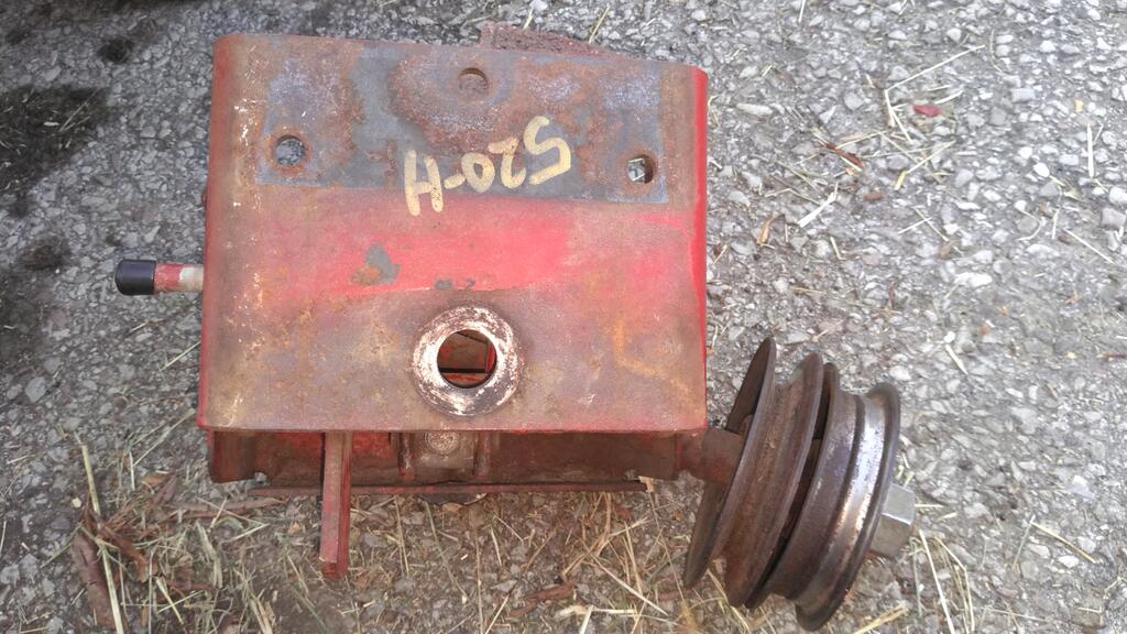

Borrowing heavily from @Aldon from pictures in his Lazarus thread. Began by following @daveoman1966 's pdf on it.

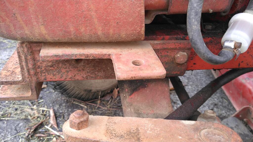

My frame below the front casting is a little different. Couple pieces of angle iron welded together and into the "nose" of the frame:
Will be adding this assembly (Guard currently removed):

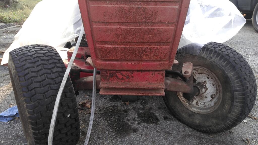

Belt in pictures isn't for use, I'm just using it for head scratching on clearances.
Plan is to get a piece of 2x2 x 1/4" angle and bolt it to the top piece of frame angle.
Tach-O-Matic will be attached off center to allow belt to clear the side of the front casting. With the standoff that the angle gives, I should actually get full turning radius. I.E. the tire shouldn't hit.

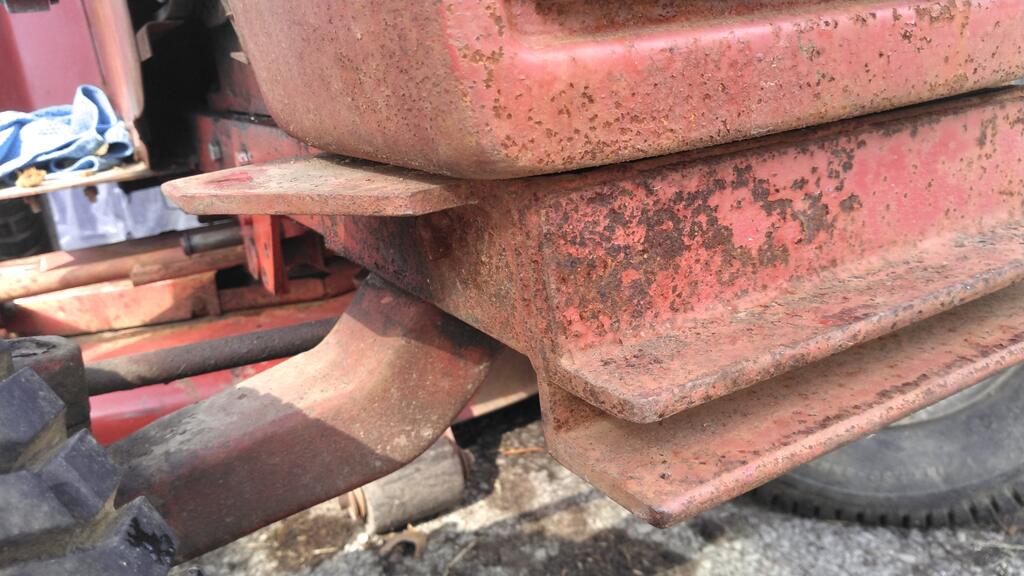

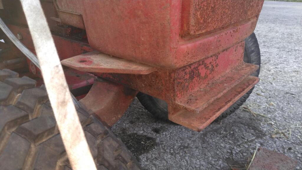

WHX??
A PO thing? Can't be ground off? What's with  the fins on the side?
@19richie66 factory?

BurtB
I'll investigate further, but it appears to be original. The paint has consistent rust/wear with the rest of the frame. Doubt it was PO.
While I could grind it off, I kind of hate to if it's original. It won't be any trouble to drill a couple of holes and bolt a piece of angle on. That will give me a flat surface to mount to. The extra standoff should also allow me clear the tire.
I ordered 2x3 angle. The extra inch should allow me to put the holes in the bottom angle where they'll be pretty much invisible when the assembly is removed. I'll end up loctiting the Tach-O-Mati to the angle. Angle will be held with nylock nuts.

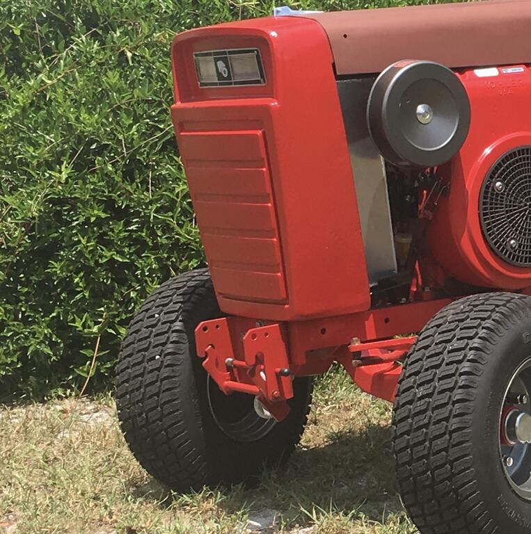

19richie66
All the gt14’s I have seen have the cheesy 1/8” flat plate across the front of the frame. This looks like someone welded a new piece in its place with a purpose. Maybe a blade with outriggers that had a rodnthat went to the hole on the side? Anything is possible with a welder. I replaced my factory “plate” with a 1/2” plate and put an Attachamatic on it. Never have had a mower on it. Aldon’s thread is also where I got the idea. IMG_6362.jpeg.d8c9a4ba9bf569bc2e6800a9b1a03b1a.jpeg

@BurtB  also a perfect time  to RE GREASE THOSE MULE DRIVE BEARINGS , remove pulleys , lay out  disassembly , critical  for correct smooth function . easy to remove wide rubber bearing side shields , small flat putty knife , flat pocket screwdriver , don't roughhouse the seals , pry to remove , easy to save , lucas green grease , 550 degree drop point , polyurea rated , makes those bearings silent , by the way that lubrication upgrade , is what makes that deck assembly , operate with a solid quiet operation . imagine no bearing whine . like to wipe out original " lubricant " flush with carb cleaner , repack to same ammount , my 3  horses have that set up , every bearing upgraded , every movement point moves with ease , pto lever does not  squeal , with easy engagement .  just an opportunity , pete

Looking closer, the wings and angle weldment are bolted on to the frame and not part of the frame. I still think I'll attach to angle instead of the frame itself. Keeps me from drilling the frame more and the standoff keeps it from interfering with the turning radius. If it's not wheel horse made, it's well built and appears to be around the same age as the tractor.

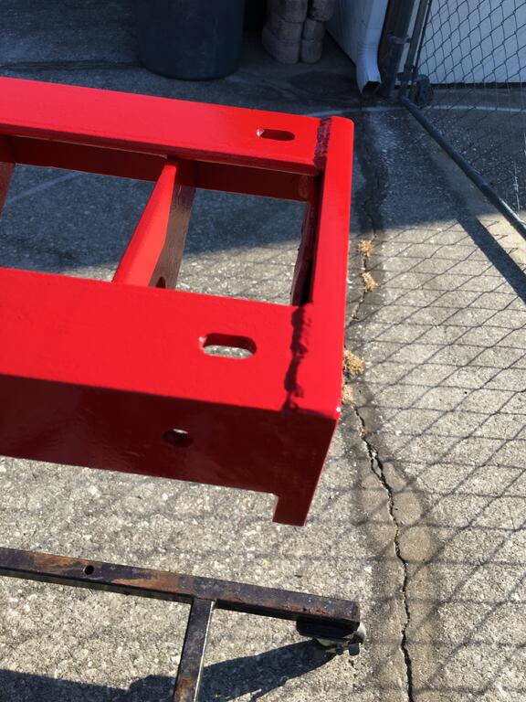

Pullstart
That looks like it was for a front end loader.  The ARK500 I had required a piece like that to hold the subframe up, and the wings were for the side upright braces.

WHX??
Might be on to something there Kev... I thought maybe some sort of front blade.

BurtB
@Pullstart @WHX?? The piece that Pullstart is referring to is very similar to mine. I'm guessing that differences are due to frame size. Figure that it is WH made. Wish I had the loader or whatever attachment that went with it. I do have a snow plow/front blade that was on the tractor when I bought it. It didn't use that bracket.

Pullstart
You are correct, my loader was from a standard size C series frame.  The GT14 and 953/1054 frames were much wider and heavier duty.
