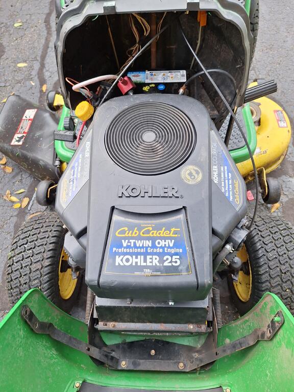

D_Mac 9,111 #1 Posted October 4, 2024 So I got this dropped off at my house last night. Has new tires, new blades, new spindles, new deck belt. The engine was swapped out from the original Briggs to this 25hp Kohler. Runs, drives and cuts just fine . The issue with it is that an over sized battery was shoved in there and the throttle and choke cables are messed up behind the dash. The throttle still functions if you mess with it a little but the choke dosnt. I'd like to find a little longer cables as they seem a little tight with this bigger engine. I think they route a little different as well. Not sure how to look for them. For free I will let it stay in the yard till it's fix so I can pass it on to someone who will over pay for it because its green. 20241004_155044.mp4 4 Share this post Link to post Share on other sites

D_Mac 9,111 #6 Posted October 5, 2024 (edited) Well worked on it this morning and got it all fixed. Addressed the cable issue. Turns out when they put an oversized battery in there, it jammed up the cable levers behind the dash. Put a charge on a smaller battery I had and installed it. It fired right up. Then I noticed when I raised the deck all the way up, it was higher on the left then the right hand side. It was installed uneven so I dropped it and leveled it out. Now I just need some yellow duct tape for the seat, and a For Sale sign so I can pass it on. I love free money ! Edited October 6, 2024 by D_Mac 1 Share this post Link to post Share on other sites
