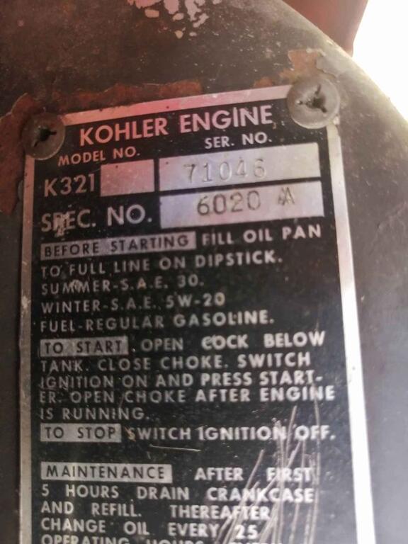

WHX?? 53,326 #6 Posted October 5, 2024 That ain't the worst price but yes we would need to see pics. We could tell you exactly what you are getting into then. If a Kohler, spins & has compression we can make it run. A '65 might make it a SG motor if original. What is a 71046?? Pesonally 140 CAN is my top dollar I can't hear it run but that goes with a grain of salt. Big block in a short frame?!?!?!? Share this post Link to post Share on other sites
gwest_ca-(File Mod) 11,845 #7 Posted October 5, 2024 71046 should be the spec number for a 16hp K341 Share this post Link to post Share on other sites

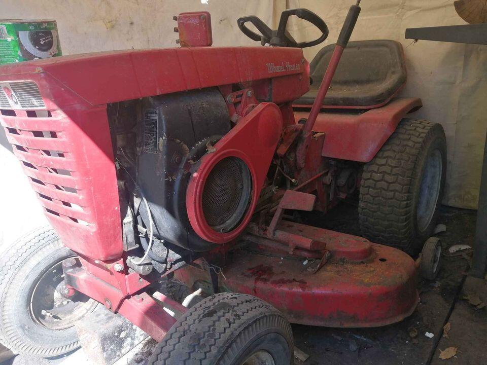

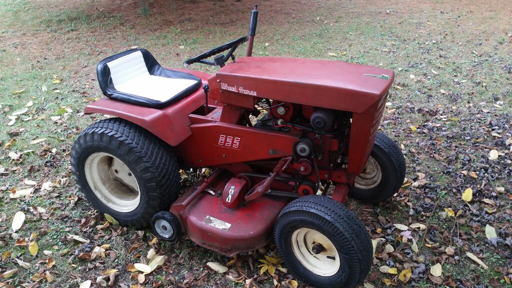

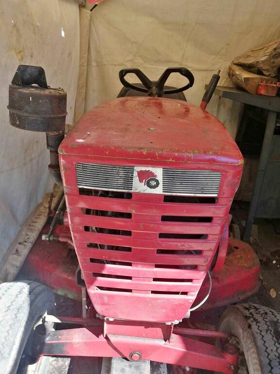

Phan 49 #9 Posted October 5, 2024 Dear Friends, I appreciate all of your advice ! I spoke with the guy - he said he is not sure whether if the motor is 8hp or 16hp. He said it has a lot of compression, no knocking engine. He's owned since 2009, but it quited on 2015. I attached the link (Links to classifieds hosted elsewhere are not permitted) It includes mower deck 42". What do you think? If things are good, I want to get it on Monday. Another person is selling his, which is simlillar However, I ahve a hard time to reach him. Thanks!!! Share this post Link to post Share on other sites
Phan 49 #10 Posted October 5, 2024 16 hours ago, gwest_ca said: 71046 should be the spec number for a 16hp K341 You seem correct as the seller said he is not sure if 16hp or 8hp. Share this post Link to post Share on other sites

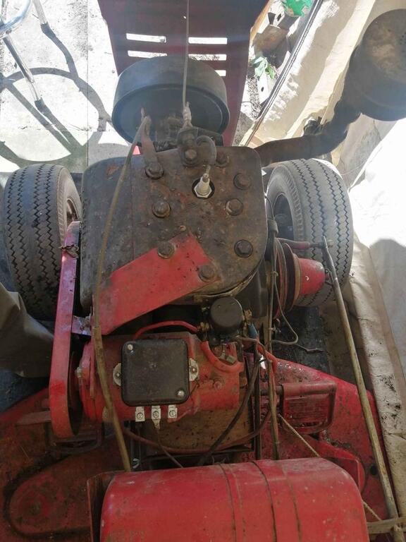

squonk 44,860 #11 Posted October 5, 2024 By the number of head bolts it's not a 16 and it ain't an 8 either. Looks like a replacement engine. I'm thinking a 10 or 12 2 Share this post Link to post Share on other sites
Phan 49 #12 Posted October 5, 2024 21 minutes ago, squonk said: By the number of head bolts it's not a 16 and it ain't an 8 either. Looks like a replacement engine. I'm thinking a 10 or 12 I just looked online and K312 list as 14hp https://resources.kohler.com/power/kohler/enginesUS/pdf/tp_1346_c_all.pdf Share this post Link to post Share on other sites

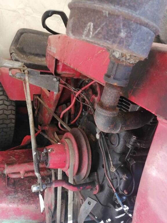

953 nut 63,003 #16 Posted October 5, 2024 (edited) Well, it isn't a 1965 and it isn't an eight HP nor is it a 16 HP engine. It is a fourteen horsepower K-321 replacement engine. The only thing I see that is missing is the belt guard, you will want to get that if the seller has it. The gears will grind while shifting without it. Edited October 5, 2024 by 953 nut Share this post Link to post Share on other sites
gwest_ca-(File Mod) 11,845 #17 Posted October 5, 2024 18 hours ago, gwest_ca said: 71046 should be the spec number for a 16hp K341 71046 is the Kohler serial number. The data decal is K-321 with a 6020 spec number making it a replacement engine. Share this post Link to post Share on other sites
D_Mac 9,330 #18 Posted October 6, 2024 Big block is 10hp or larger. Short frame refers to the shorter framed tractors of the 60s. We like those. Most common no spark issues are bad points, bad coil, bad plug wire or other wires. Like ground wire or wire from points to coil. Also could be a bad switch. No spark on these engines usually isn't hard to fix as it dosnt require taking the engine apart because every thing is external and easily accessible. The asking price I think is a little much. They all say ran good when it was parked X number of years ago. How's the tranny? Hows the tires? Steering tight? All things to consider. That being said..... Big Block on Short Frame ( making gorilla noise and grunts) 2 Share this post Link to post Share on other sites

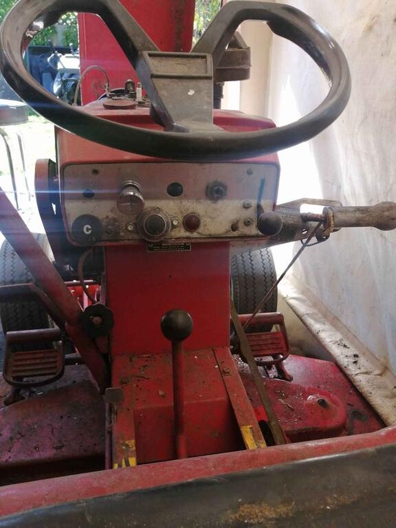

WHX?? 53,326 #19 Posted October 6, 2024 (edited) Be careful Phan ... links to off site sales are not allowed. The moderators and myself do not want to turn RS into a free for all selling site is the reason. Since your post will most likely get edited. I cut and pasted the pics here which is allowed. 18 hours ago, Phan said: Hi WHX - What did you mean - a positive or negative :)??? Big block in a short frame?!?!?!? The short framed early sixties tractors D Mac mentioned. Some were fitted with a 10 hp big block when traditionally they had small block 6,7 or 8 hp. The 1045 and 1055 come to mind. In late '66 - 67 longer framed models with bigger motors became the norm as people wanted the more powerful motors with larger decks. A positive and desirable model with us collectors. If you decide to buy get us a pic of the tag visible just under the dash. I'm guessing a 67 or mid 68 model. Three speed and hood decal say repoed 10 or 1257 Edited October 6, 2024 by WHX?? 2 Share this post Link to post Share on other sites

Phan 49 #22 Posted October 6, 2024 2 hours ago, WHX?? said: Be careful Phan ... links to off site sales are not allowed. The moderators and myself do not want to turn RS into a free for all selling site is the reason. Since your post will most likely get edited. I cut and pasted the pics here which is allowed. The short framed early sixties tractors D Mac mentioned. Some were fitted with a 10 hp big block when traditionally they had small block 6,7 or 8 hp. The 1045 and 1055 come to mind. In late '66 - 67 longer framed models with bigger motors became the norm as people wanted the more powerful motors with larger decks. A positive and desirable model with us collectors. If you decide to buy get us a pic of the tag visible just under the dash. I'm guessing a 67 or mid 68 model. Three speed and hood decal say repoed 10 or 1257 Thanks a lot for removing the link " links to off site sales are not allowed" Once I have the tag info under the dashboard from the seller - I will share with you. 1 Share this post Link to post Share on other sites

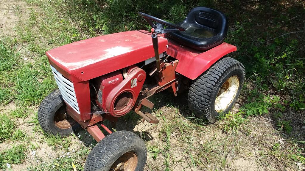

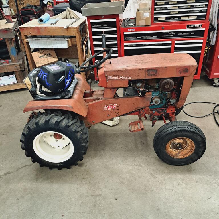

Phan 49 #23 Posted October 6, 2024 Dear Friends, Another person is asking for 300 CAD - saying maybe running. However, I don't much info besides this photo. What do you think? Share this post Link to post Share on other sites

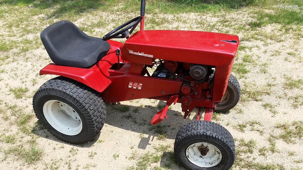

WHX?? 53,326 #24 Posted October 6, 2024 (edited) Looks like a 8 hp ... possibly a 856 or so. Maybe a '65. Looks to have strait sheet metaI, complete & unmolested in that pic. I have a 856 for sale now. I'm asking 300 US but would take 250 from a nice guy. Problem finding a taker tho. Lots of variables in availability & pricing from area to area. 7 hours ago, Phan said: Thank you so much for teaching me those - BBSF (Big Block on Short Frame) !!! No problem that's what we do here although some of these bozos have regular day jobs too... Suggestion When you go to look at tractors take your camera take plenty of pics. Be polite and ask seller if it's okay. Bring them back here for us to evaluate. Some guys here forgot more than I'll ever know. Tractors always look better in pics to the layman. Couple of 856s for the fellas... @Achto has ole pale face now. A orginal 855 I had... shoulda never sold it to @rj35hunter... Edited October 6, 2024 by WHX?? 1 2 Share this post Link to post Share on other sites
