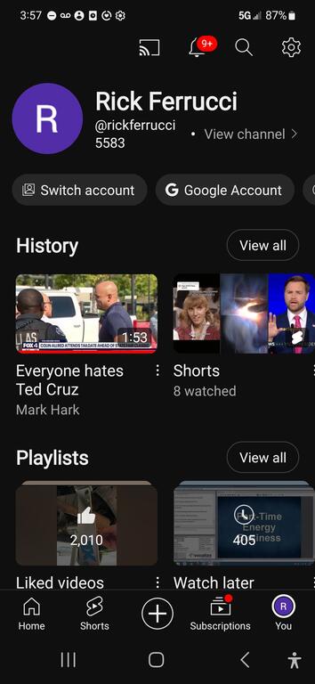

WHX?? 49,916 #2 Posted October 2, 2024 And the screen shot is for ??? Rick?? Oh your looking for a screen shot of your flywheel screen?? Have you posted a ad in wanted? 2 Share this post Link to post Share on other sites
