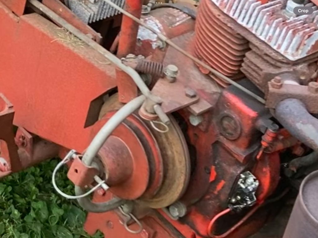

Retired Wrencher 5,590 #1 Posted October 2, 2024 Sorry if this not correct place. Where dose or what goes in this hole? With open hole to right on the pto top plate. Pictures would be nice if you have them? This is the only pto I have like this. Share this post Link to post Share on other sites

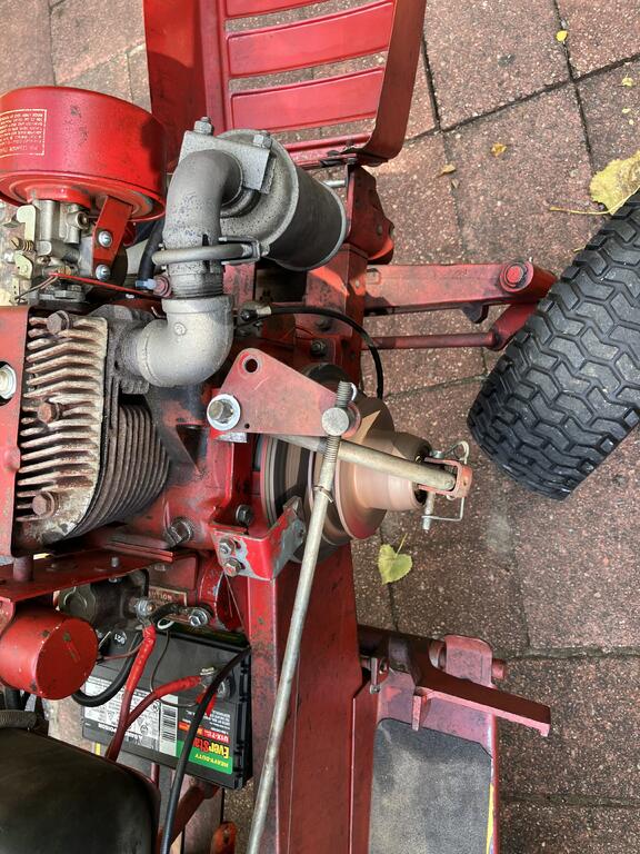

TonyToro Jr. 1,718 #2 Posted October 2, 2024 Here’s a semi decent picture it looks like a bolt goes through it. 2 Share this post Link to post Share on other sites
Racinbob 11,448 #3 Posted October 2, 2024 It's in the wrong hole. Notice how the yoke isn't centered with the PTO. I don't see how it could even work that way because there is no camming to pull the yoke tight. It should have a shoulder bolt in the hole where the top of the yoke is now. Take it apart and reassemble like Tonys. No need to pop the retainer off the yoke. Just reposition and install the bolt through the unused hole in the plate. 2 Share this post Link to post Share on other sites
