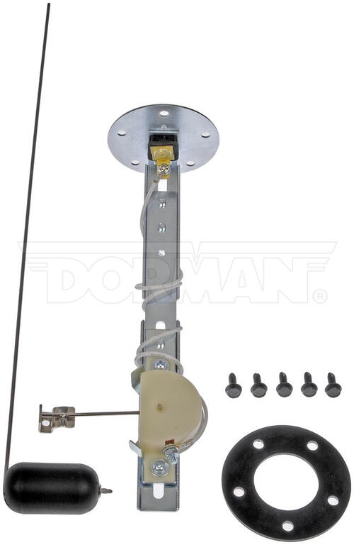

cleat 6,975 #1 Posted September 30, 2024 I have heard through the grapevine that the Dorman 55818 fuel sending unit will fit the Wheel Horse fuel tank. Has anyone tried it ? Electrically it is close but not perfect. I can't find the exact specs on the mounting flange so I don't know if it fits or not. I don't need a new sending unit right now, just curious. https://www.dormanproducts.com/p-80972-55818.aspx 1 Share this post Link to post Share on other sites

cleat 6,975 #3 Posted September 30, 2024 I believe this unit can be flipped over to make the electrical part correct. I am more worried about the actual flange mounting into the fuel tank. Share this post Link to post Share on other sites
cleat 6,975 #4 Posted September 30, 2024 I see Princess auto carries it as well here in Canada so next time I am going to a city that has a Princess auto store, I can take an old sender and do some comparisons. 1 Share this post Link to post Share on other sites

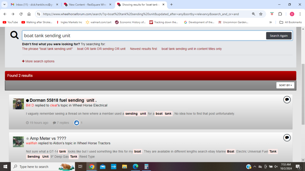

Bill D 2,083 #8 Posted October 1, 2024 I vaguely remember seeing a thread on here where a member used a sending unit for a boat tank. No idea how to find that post unfortunately. 1 Share this post Link to post Share on other sites
953 nut 57,768 #9 Posted October 2, 2024 19 hours ago, Bill D said: No idea how to find that post unfortunately. All ya gotta do is search! https://www.wheelhorseforum.com/search/?q=boat tank sending unit&updated_after=any&sortby=relevancy&search_and_or=and 1 Share this post Link to post Share on other sites
