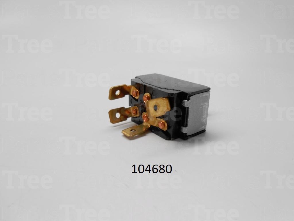

Bar Nuthin 904 #28 Posted October 4, 2024 (edited) I noticed this PTO Interlock switch behind the side panel. It has been bypassed and there is no harness plug for it. Does anyone know the correct wiring, if I wanted to re-connect it? If nothing else, I guess I could just test continuity and see which posts interrupt the wire from the ignition switch to the solenoid. I'm guessing there should be an interlock for the hydrostatic control as well. Switch Pto Safety Push-button 104680 List.jpg - Electrical - RedSquare Wheel Horse Forum Edited October 4, 2024 by Bar Nuthin Share this post Link to post Share on other sites

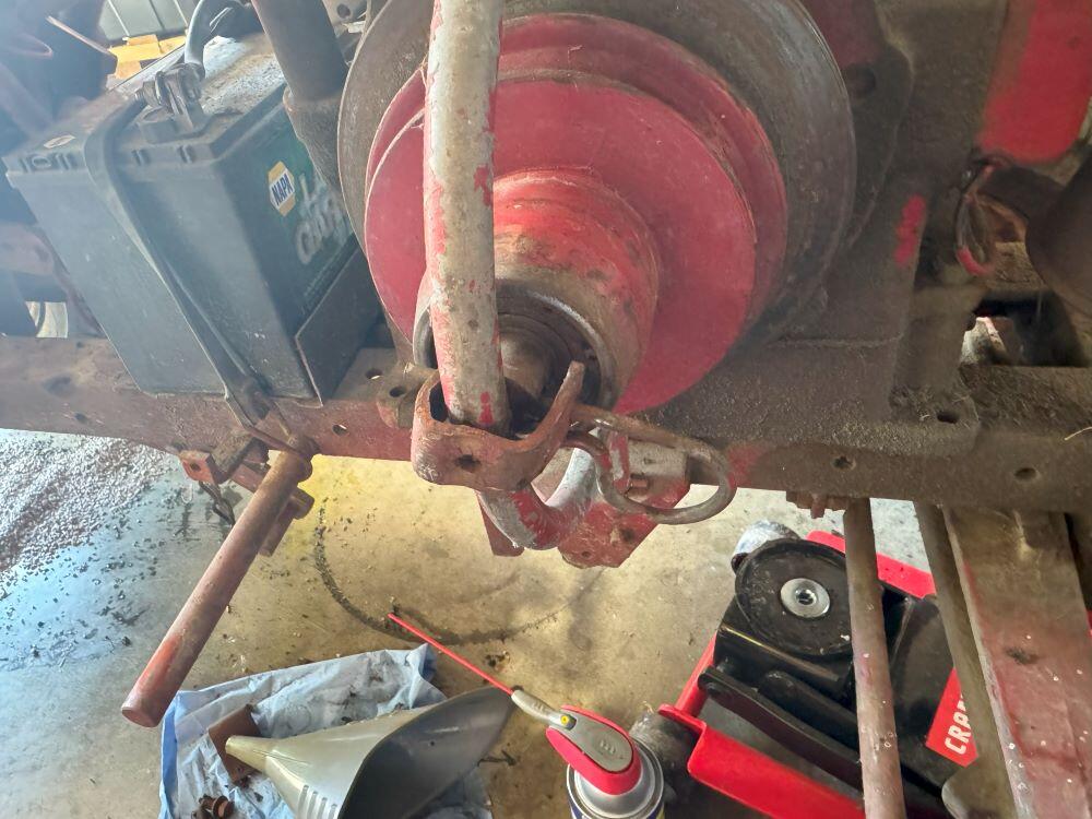

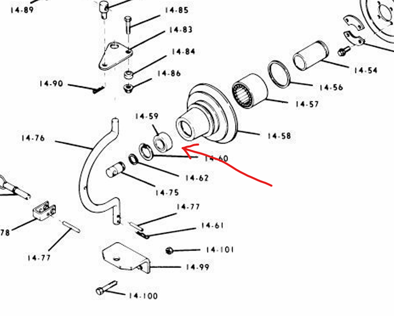

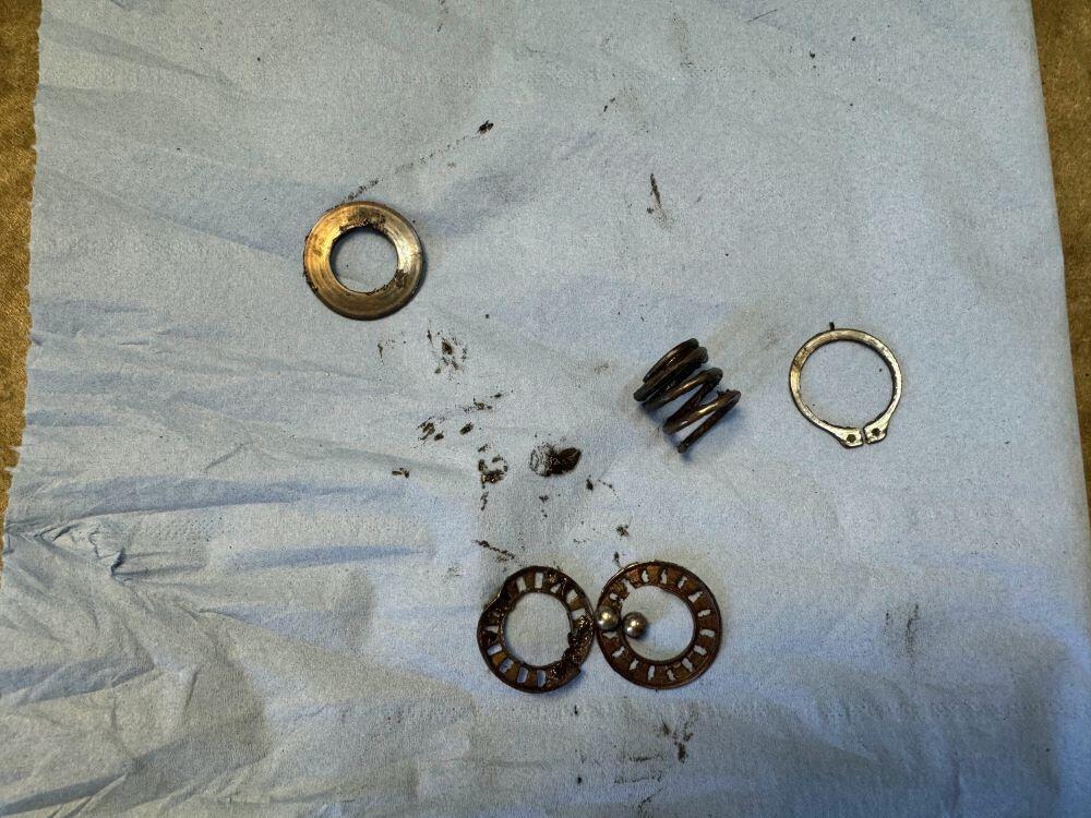

WHX?? 50,512 #29 Posted October 4, 2024 (edited) On 10/2/2024 at 2:13 PM, Bar Nuthin said: I noticed the PTO clevis was bent, so I pulled the PTO to have a look inside. I found these parts inside. But looking at the schematic, no such parts are shown. Everything in the diagram is intact. The outer PTO shaft spins freely in its bearing and the appropriate snap rings seem to be in place. Any ideas? Somebody had parts in there that didn't belong. Looks like the remnants of a thrust bearing of sorts. the outer bearing is designed to act as a thrust bearing if it's the correct bearing. Assemble exactly as show in the IPL. I notice you have the usuall battery box issues ... the fix here... Edited October 4, 2024 by WHX?? 1 1 Share this post Link to post Share on other sites
WHX?? 50,512 #30 Posted October 4, 2024 (edited) 9 hours ago, Bar Nuthin said: interlock for the hydrostatic control as well. No but is a switch located by the brake/return to neutral pedal that must activated for the engine to start. Many guys bypass the switches as they can be troublesome with age. Not recommended if others unfamiliar with it operate the tractor. Edited October 4, 2024 by WHX?? 2 Share this post Link to post Share on other sites

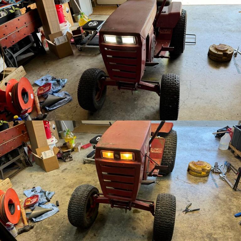

Bar Nuthin 904 #33 Posted October 6, 2024 Got the parts I needed for the headlights and replaced the filament bulbs with bright LED bulbs. I have some stainless steel tubing I may polish up and use as reflectors behind the bulbs. Question: The original wire going to the headlights was gone. What is the best way to route the new wire? 4 Share this post Link to post Share on other sites
ebinmaine 70,339 #34 Posted October 6, 2024 8 hours ago, Bar Nuthin said: Question: The original wire going to the headlights was gone. What is the best way to route the new wire? Originally it would have been routed along the frame under the engine using clips to hold it away from the steering. 1 Share this post Link to post Share on other sites

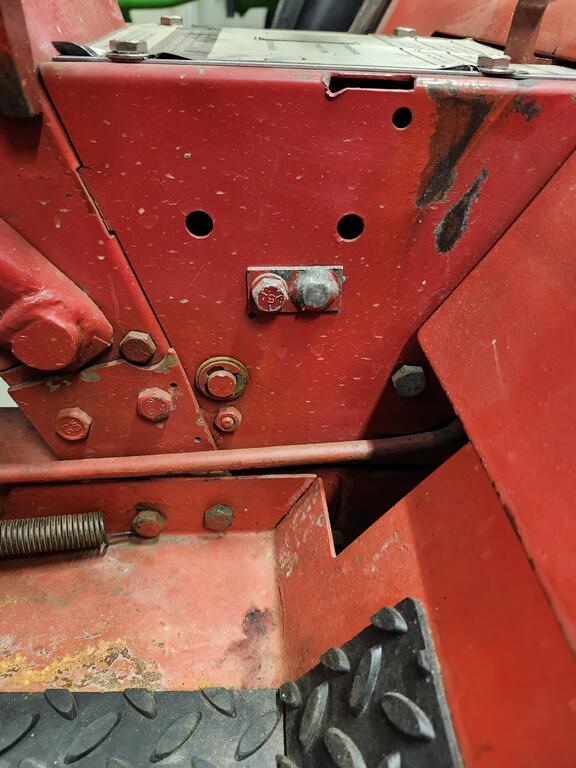

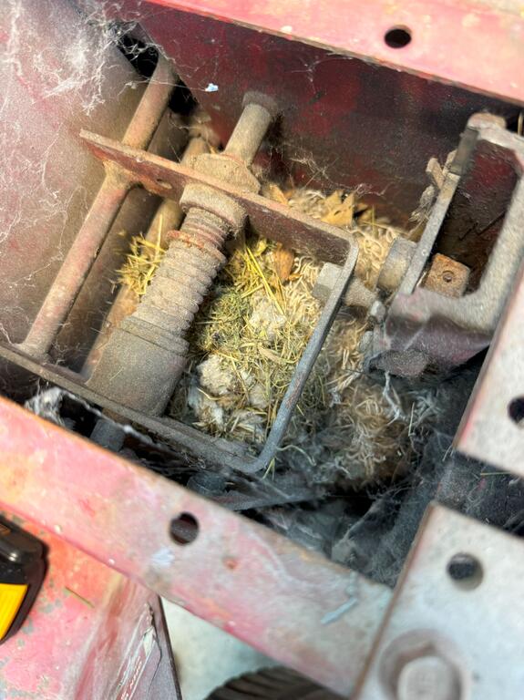

Bar Nuthin 904 #43 Posted October 11, 2024 On 9/29/2024 at 4:49 PM, oliver2-44 said: Give this a area a good gentle cleaning. Then follow the maintenace manual and lube the linkage it list, but also don't lube some of the linkage it list. @oliver2-44 I cleaned up this mess and lubricated the friction points I could see. I must have lubricated one of those area you said "don't lube some of the linkage it list". Now when traveling forward, my hydrostatic lever magically vibrates to full speed ahead unless I hold it in place. Is there an adjustment (or other fix) for this? Share this post Link to post Share on other sites
8ntruck 7,326 #44 Posted October 11, 2024 (edited) I'm guessing that you lubed the cup and cone do floppy inside the square frame piece of linkage near the bottom of the picture. That area needs to be dry to produce enough friction to keep the motion control lever in place. Edited October 11, 2024 by 8ntruck 1 1 Share this post Link to post Share on other sites
Bar Nuthin 904 #45 Posted October 11, 2024 9 hours ago, 8ntruck said: I'm guessing that you lubed the cup and cone do floppy inside the square frame piece of linkage near the bottom of the picture. That area needs to be dry to produce enough friction to keep the motion control le er in place. Doh! Yes, I did! I think I'll use some electronics cleaner to "un-lube" it, as to not damage the plastic. 1 Share this post Link to post Share on other sites
ebinmaine 70,339 #46 Posted October 11, 2024 9 minutes ago, Bar Nuthin said: Doh! Yes, I did! I think I'll use some electronics cleaner to "un-lube" it, as to not damage the plastic. Lemme know how that works... I have one that loses speed instead of gaining it. 1 Share this post Link to post Share on other sites
8ntruck 7,326 #47 Posted October 11, 2024 2 hours ago, Bar Nuthin said: Doh! Yes, I did! I think I'll use some electronics cleaner to "un-lube" it, as to not damage the plastic. What kind of lube did you use? Like @ebinmaine, I'm curious to know how cleaning it works out. I am a mentor for the local high school's robotics team. Pre season activities are underway. I like to point out to the students that one gains knowledge from one's own mistakes, and, if one pays attention, one can gain wisdom from other's mistakes. 1 Share this post Link to post Share on other sites
Moparfanforever 873 #48 Posted October 11, 2024 13 hours ago, Bar Nuthin said: @oliver2-44 I cleaned up this mess and lubricated the friction points I could see. I must have lubricated one of those area you said "don't lube some of the linkage it list". Now when traveling forward, my hydrostatic lever magically vibrates to full speed ahead unless I hold it in place. Is there an adjustment (or other fix) for this? There is a metal shaft that goes through those parts, and unfortunately, they rust to the shaft. You can loosen the big nut on the right, and there is four flat spots on the part that has threads. IF the part with threads isn't rusted to the shaft, you can turn it in to put more tension on the big spring, or turn it out for less tension. Good luck, the part with threads and the part of the friction cone will rust to the shaft. 1 Share this post Link to post Share on other sites
Moparfanforever 873 #49 Posted October 11, 2024 This tab is welded to the shaft that goes through those parts, it keeps the shaft from moving. Alot of times these are broken from people trying to move the hydro handle with everything rusty. 2 Share this post Link to post Share on other sites
