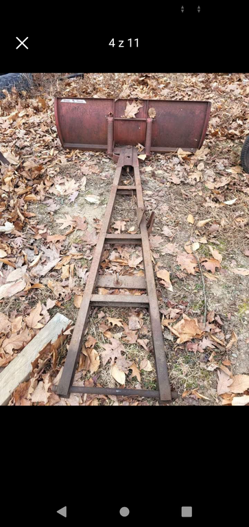

Milosz 3 #1 Posted September 29, 2024 Hello I have owned a 706 for some time now. Unfortunately, I only have a trailer for it and no tools are available for purchase in my area. I would like to make a snow plow myself based on the original. I found a photo on the internet but I have a request. Could someone who has one measure the frame elements exactly? Greetings from Poland! 1 Share this post Link to post Share on other sites
ri702bill 8,729 #2 Posted September 29, 2024 Milosz - Welcome. That is a VERY ambitious project. You also need the rear axle quick mount. And - the angling lever & rod are not shown - you need them too. A suggestion - are you better off modifying a different brand, but similar size plow to fit your needs??? Perhaps @gwest_ca can supply documentation. 1 Share this post Link to post Share on other sites
Milosz 3 #3 Posted September 29, 2024 39 minutes ago, ri702bill said: Milosz - Welcome. That is a VERY ambitious project. You also need the rear axle quick mount. And - the angling lever & rod are not shown - you need them too. A suggestion - are you better off modifying a different brand, but similar size plow to fit your needs??? Perhaps @gwest_ca can supply documentation. I have already found the rear axle dimensions on the forum and I will make one without any problems. I already have an idea and material for the plow. But I still need frame dimensions to make the task easier and not do it haphazardly. Angle change levers won't be a problem Share this post Link to post Share on other sites
ri702bill 8,729 #4 Posted September 29, 2024 Sounds like you have a handle on this.... keep us posted on your progress. Share this post Link to post Share on other sites
Milosz 3 #5 Posted September 29, 2024 As soon as I find time to do it, I will definitely post some photos 1 Share this post Link to post Share on other sites

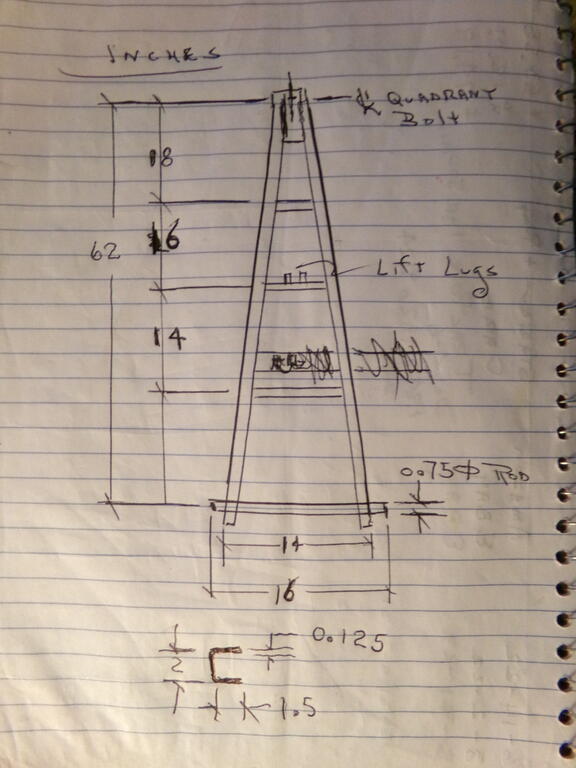

Ed Kennell 39,731 #8 Posted September 29, 2024 to the Milo. This may help you get started. 2 1 Share this post Link to post Share on other sites
Milosz 3 #10 Posted September 30, 2024 10 hours ago, Ed Kennell said: to the Milo. This may help you get started. Great! Man this is what i looking for. Thanks a lot! 1 Share this post Link to post Share on other sites
