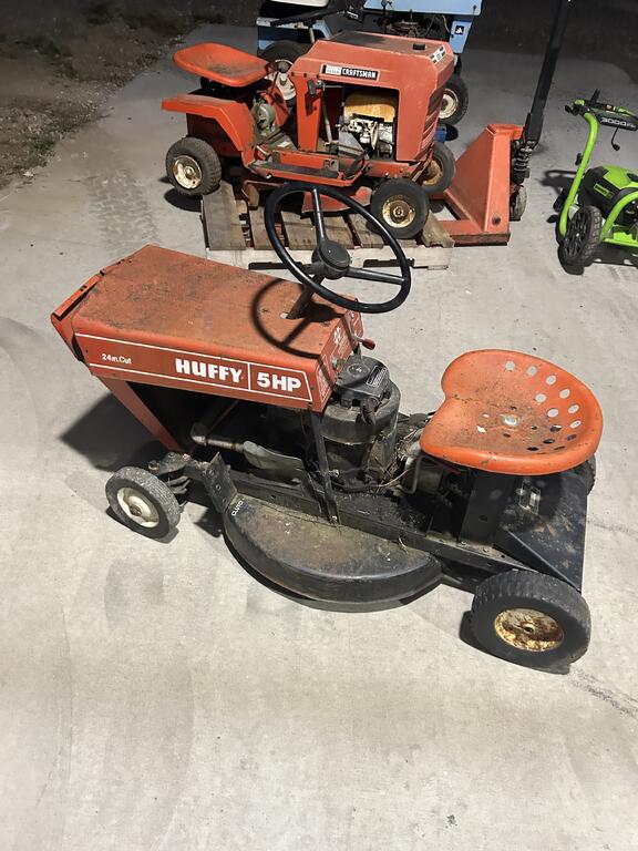

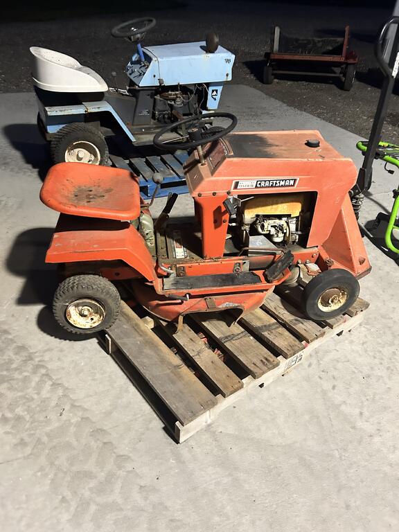

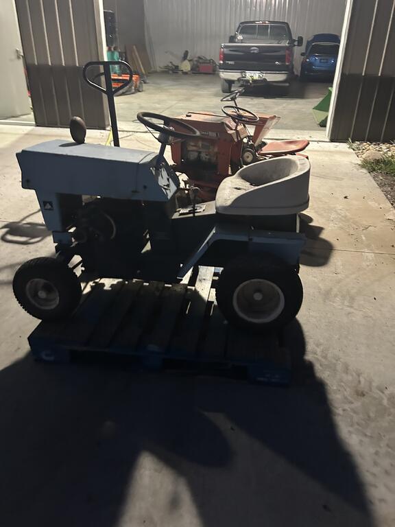

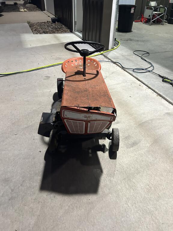

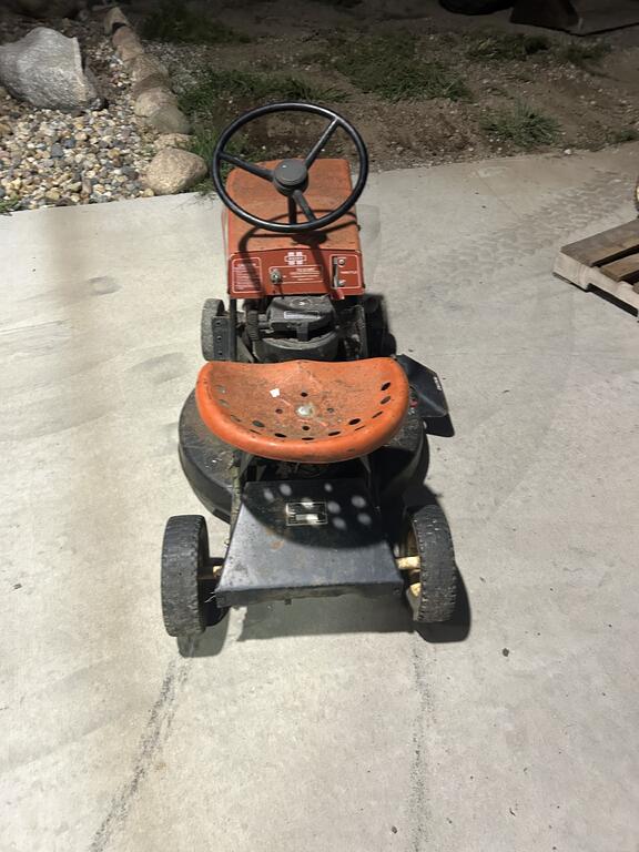

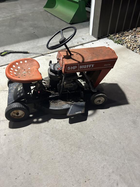

Keaton 466 #4 Posted September 27, 2024 (edited) as promised here they are, first the huffy. spins over good and rolls well, I look the carb off this morning and float bowl is there in the tank and the tanks pretty nice, that shouold run but the throttle on the carb barley turns and sorry it was dark when I got back from the homecoming parade, I'm going to get the Springfield 36 next week it was in another building Edited September 27, 2024 by Keaton 2 Share this post Link to post Share on other sites

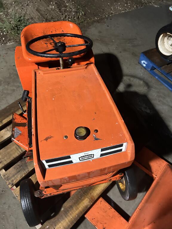

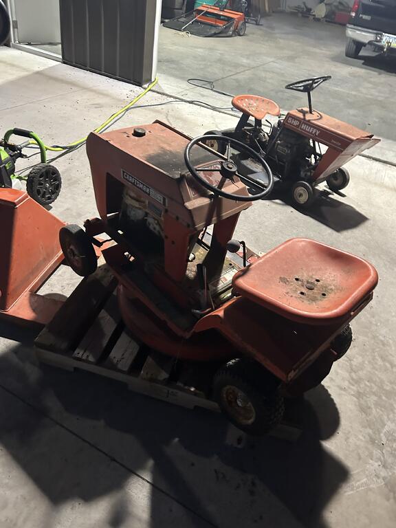

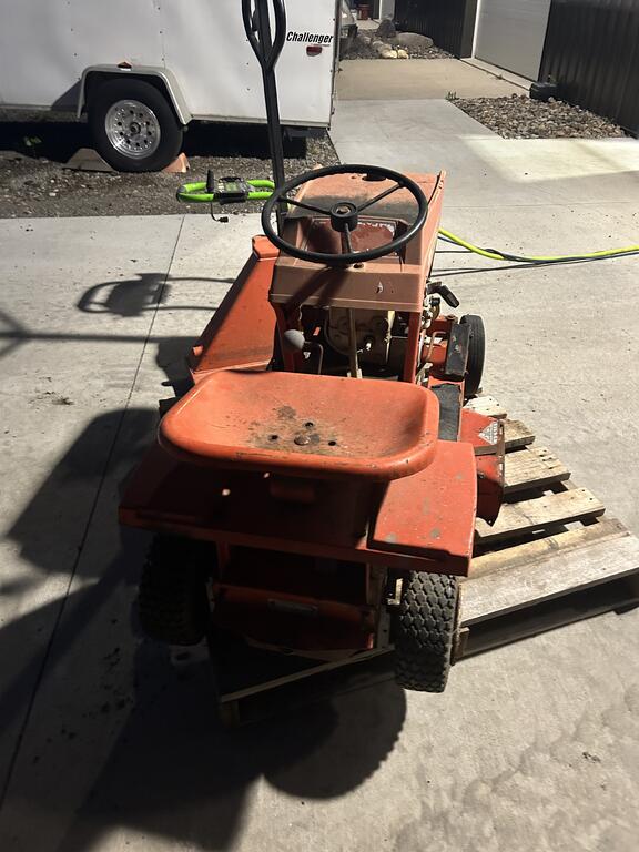

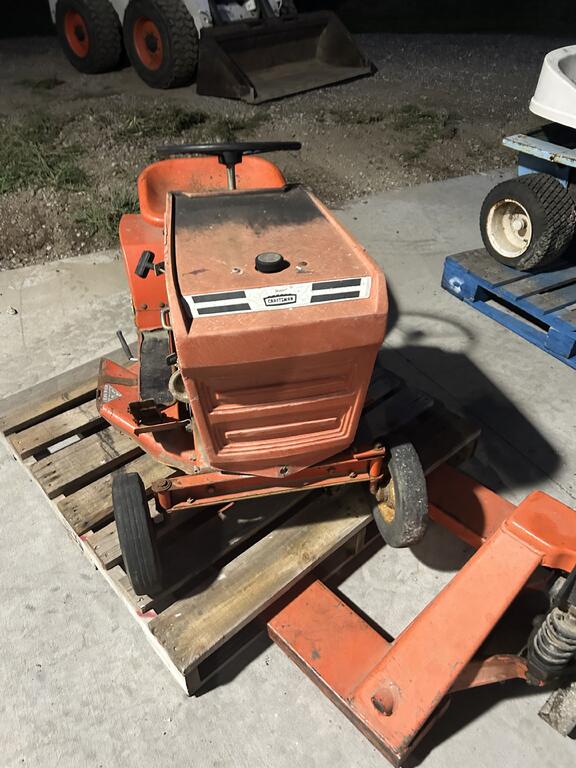

Keaton 466 #5 Posted September 27, 2024 this is the craftsman, its pretty rough, stuck engine and stuck steering, I sprayed all of them down in pennatrating oil. these are all pictures of before I washed them, one in here is after I washed it, the hood cleaned up nice 2 Share this post Link to post Share on other sites

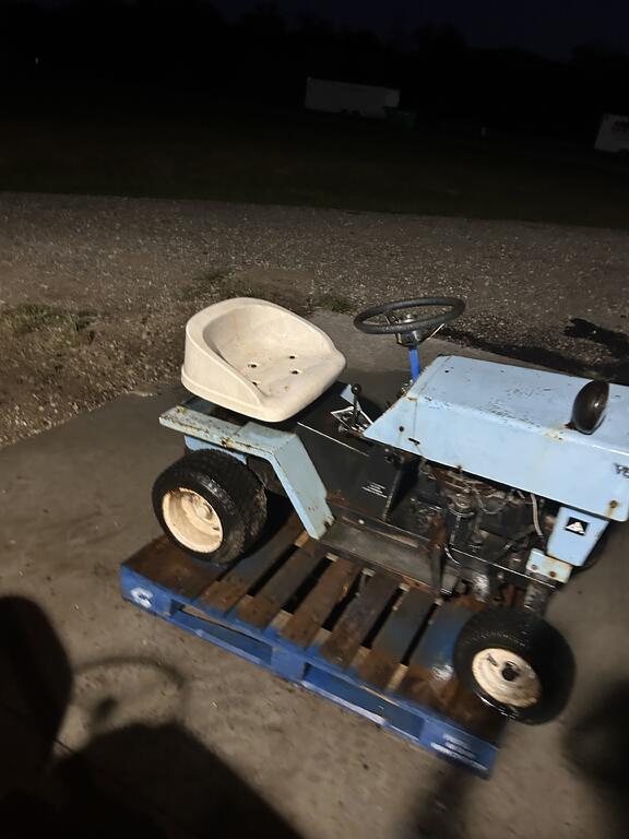

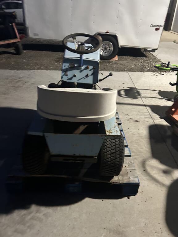

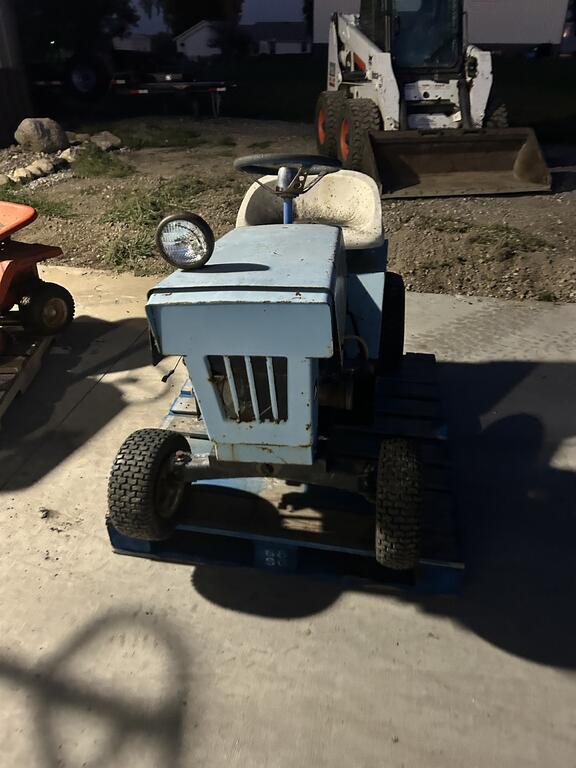

Keaton 466 #6 Posted September 27, 2024 and last but not least the bonanza, seat cleaned up great. and it spins over decent now, only electric start, the recoil if it had one and cover is missing. its not a terriable mechine, I was told the bonanza and huffy ran and drove once, I believe it, I bet by next week I'll have they huffy running its pretty hopefull after I get spark 2 2 Share this post Link to post Share on other sites

Keaton 466 #9 Posted September 29, 2024 update, the huffy has spark I'll but the carb back on in the morning and see if it will start. and the craftsman I just took the hood off of. I got it eventually and tommrow were dropping the engine back in my truck, yay! and then I'll turn to the tecumpse, awww, but I'll give it a whirl, they either just need a carb clean end fire up or they need a lot more it seams same for the Briggs engines. Kohler's are there own game 1 Share this post Link to post Share on other sites
Keaton 466 #10 Posted October 1, 2024 the huffy runs, the carb is not sealed 100 % I will fix that tomorrow, it ran for a solid 3 minutes and mentioned above On 9/28/2024 at 11:31 PM, Keaton said: and tommrow were dropping the engine back in my truck the engine is back in my truck, we set the fuel injection on it now we got to wire it all up, 2 Share this post Link to post Share on other sites
Keaton 466 #11 Posted October 2, 2024 tried fixing the carb now it wont start. dont know why the gasket material was probally a bad idea. cant figure it out Share this post Link to post Share on other sites
Keaton 466 #12 Posted October 3, 2024 it rung good now I did not have a hold in the gasket for fuel to the float bowl inside the tank 1 Share this post Link to post Share on other sites
ebinmaine 75,689 #13 Posted October 3, 2024 8 hours ago, Keaton said: it rung good now I did not have a hold in the gasket for fuel to the float bowl inside the tank Nice catch. I've done similar. Lesson learned. Share this post Link to post Share on other sites
