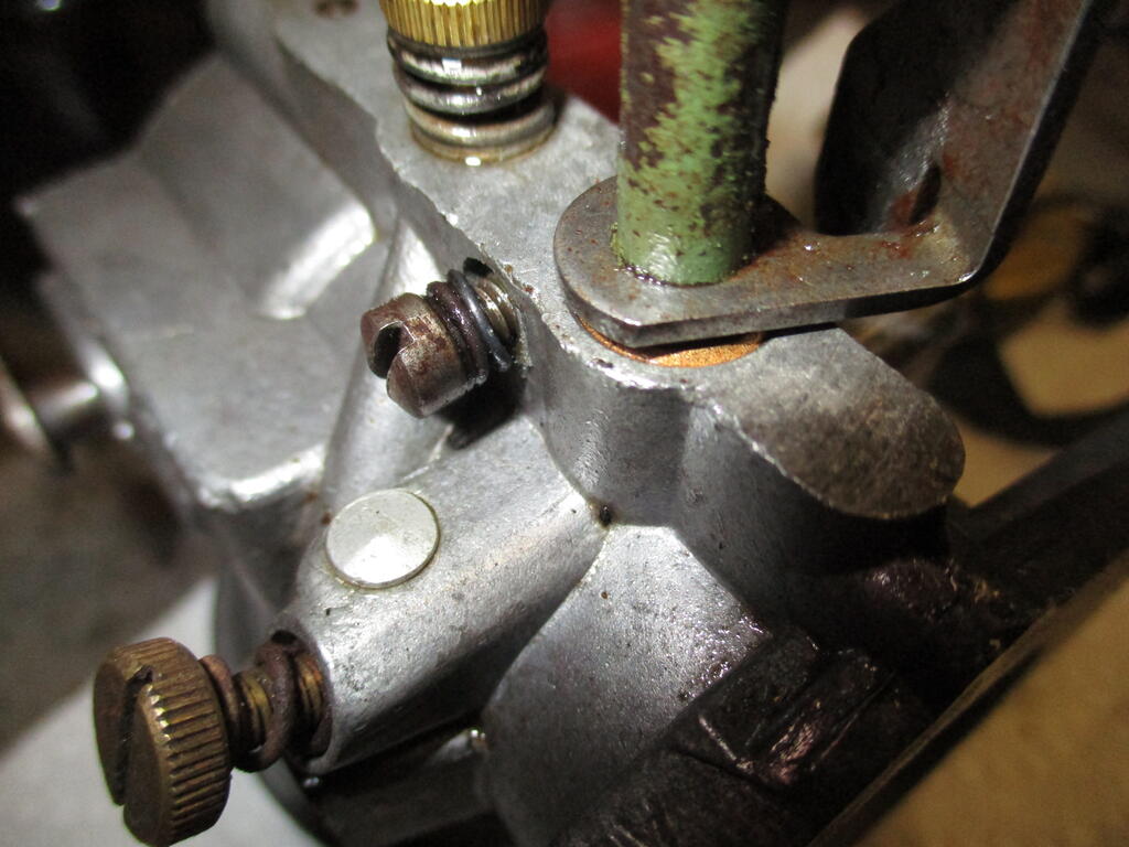

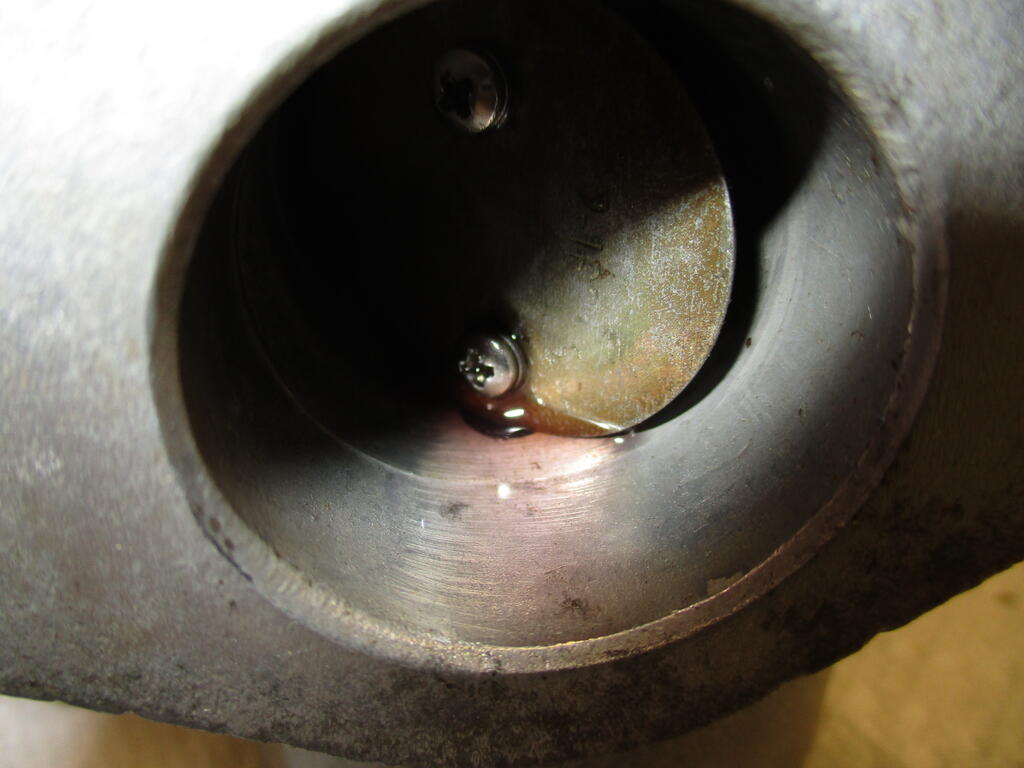

pfrederi 19,255 #1 Posted September 25, 2024 Picked up a #30 carb some time ago not having an immediate need went into a box. Now I want to use it non my C-160-8 with the overhauled motor. The darn throttle shaft will not budge... have soaked it with various snake oils can't move it with vice grips....Appears some PO put a bushing or the top of the shaft..you can see a bit of bronze peaking out, also welded the throttle arm. Tried a little warmth (not real hot) but nada. Butterfly is turned to much to remove the little screws unless i just grind them off but still not sure that will free the shaft. Thoughts Smart people.... Share this post Link to post Share on other sites
ebinmaine 75,740 #2 Posted September 25, 2024 I've put bushings in the top of quite a few carbs. It's a loose enough fit that you certainly do not need to drive the shaft down through or anything like that. If it won't move either direction I would begin to wonder if someone got some Loctite down in that lower bushing housing. I think a little more heat shouldn't hurt much. But obviously, don't be too ambitious on that. I would be prone to trying to lock the carb into a vice and use large pliers or some such, to try to turn that throttle shaft towards the "more open" direction. More that turns open, the more freedom there should be for that butterfly. 2 Share this post Link to post Share on other sites
wallfish 18,786 #3 Posted September 25, 2024 Back and forth repeat repeat repeat oil the top too. Back and forth repeat. You could try prying lightly on the butterfly in the same direction and at the same time. That shaft should also move just a tiny little bit up and down too so you can trying prying it up and tapping down on it too. 2 Share this post Link to post Share on other sites

lynnmor 8,254 #6 Posted September 25, 2024 Clean away the products that you tried with acetone. Let it soak with the acetone and try moving it again. If that doesn't help heat the shaft rapidly to over 300 degrees and see if it will move. The reason for quickly heating it is so you don't over heat parts that may be destroyed. What I suspect is the same as ebinmaine, possible super glue use. It appears that the screws might come out with a right angle Phillips screwdriver. 1 Share this post Link to post Share on other sites
Ed Kennell 43,782 #7 Posted September 25, 2024 Can you get a short philips bit and wrench on the screws? If you can get the plate off, then use/make a slide hammer to pull the shaft and bushing. 1 Share this post Link to post Share on other sites
Bill D 2,442 #8 Posted September 25, 2024 My guess is someone used red loctite on the screws for the throttle butterfly. It ran down the shaft, pooled at the bottom and locked the shaft in place. Heat up the bottom of the carb where the pocket for the shaft is. I think that will free it up. Then you can get the screws out, take the shaft out and clean everything up. 3 Share this post Link to post Share on other sites

pfrederi 19,255 #12 Posted September 26, 2024 Thank you all!! Applied a bit more warmth and applied more acetone/atf bug juice and it broke free. Actually moves pretty well now after a lot of back and forth. Going to get the screws out of the butterfly and pull the shaft soak it berrymans then some time in the ultra sonic cleaner... 1 2 Share this post Link to post Share on other sites
