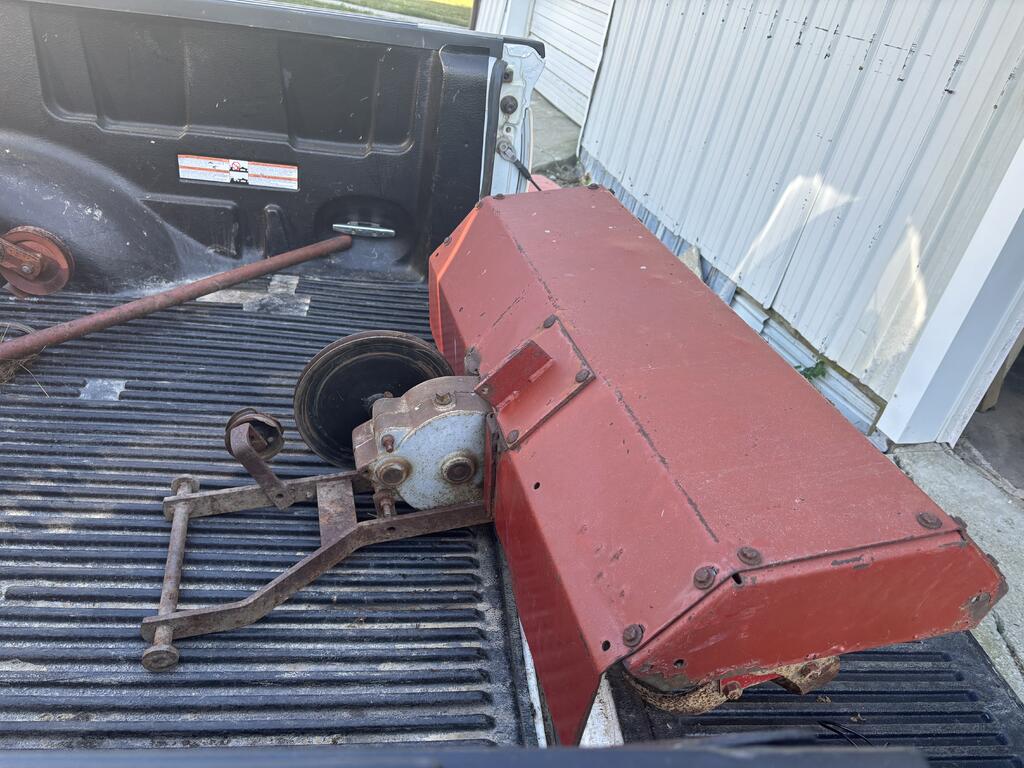

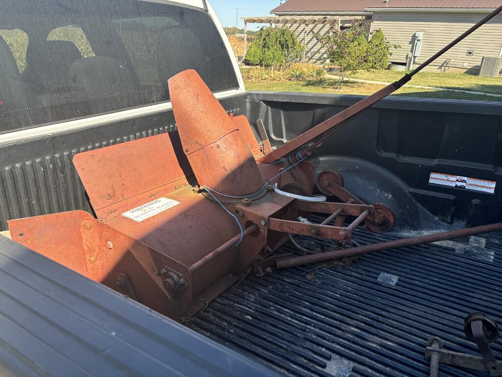

fourwheelhorseman 350 #1 Posted September 21, 2024 I just drove 3-1/2 hours for these two items, snow blower and tiller.. the only thing I REALLY wanted was the tiller, it’s complete minus the bracket for the axle… the price was for sure worth it! I’ll be needing an idler pulley and maybe a longer cable for the lift. All in all I’m pretty satisfied. The snowblower is going to need some work so I might part it out or sell it as a project, it has rod and flag. The tiller has a little fluid in it, but not a whole lot.. I’ll not use it alot so if it leaks a little it’s ok. 9 1 Share this post Link to post Share on other sites

peter lena 9,085 #7 Posted September 22, 2024 @fourwheelhorseman referring to that single stage blower , notice the 2 pulley idler set up ? that frame is steel on steel , rarely lubricated , so it does not easily follow belt drag , also those 2 pulleys are rarely if ever re lubricated , so they spin easily , combine that with a chain / cable lubricant for the auger drive chain , and it moves much easier . often refer to detail functioning on horses , the difference is amazing ! blower I sold to a guy moved by hand , emphasized how it worked , probably been sitting outside in tall grass , forgotten , pete Share this post Link to post Share on other sites

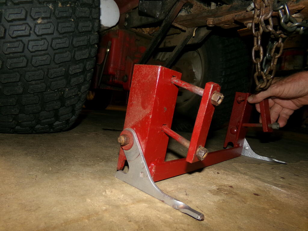

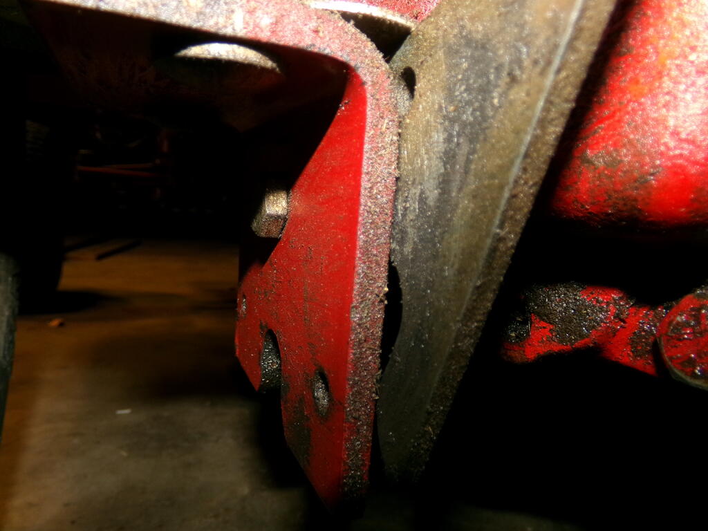

Ed Kennell 40,454 #10 Posted September 22, 2024 3 hours ago, WHX?? said: I'm axle bracket heavy if you need one. Most are off round hoods tho not sure if the same for use on bigger tractors. The 856 I just took in has one that will come off and not get used. Those early axle brackets have the rod notches in the front of the axle. The later ones have the notch below the axle. I'm not sure, but I doubt if a tiller would work with the early brackets. Seems the axle would interfere with the tiller mounting frame. If it did fit, it would move the tiller about 3 inches forward. 1 Share this post Link to post Share on other sites

Ed Kennell 40,454 #13 Posted September 22, 2024 (edited) 1 hour ago, Pullstart said: I beg to differ, in bracket usability. I recently set up my old tiller for my brother in law on an old @roadapples Raider, and also purchased and delivered another tiller setup to Grey and Katherine, @Wheel Horse 3D. Both those brackets were different than all my other plow brackets. What is correct? I am not positive. Got any pics Kev? Here is a newer bracket on my 312 where the notches are below the axle. And the older design where the notches were in front of the axle. Seems the tiller bars would interfere with the axle and/or the axle bracket spacer bar. BTW, I believe Jay's old Raider lived in my barn before I dropped it off at Jays barn. Edited September 22, 2024 by Ed Kennell 4 1 Share this post Link to post Share on other sites

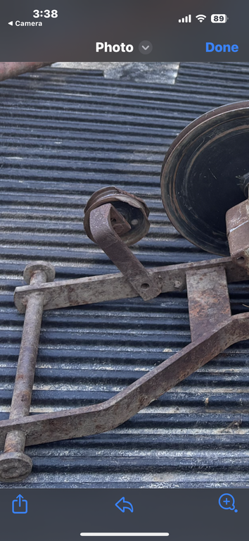

fourwheelhorseman 350 #20 Posted September 23, 2024 39 minutes ago, WHX?? said: Havta look when I'm out horsin around tomorrow . Let me know Sir! Thanks again! Hey while I have you guys attention, where can I get that idler pulley that is show in the earlier pics, the one that is all mangled will need to be replaced… 1 Share this post Link to post Share on other sites

WHX?? 50,691 #22 Posted September 23, 2024 12 minutes ago, fourwheelhorseman said: I get that idler pulley Check with parts n more... otherwise the jungle or flea bay. 1 Share this post Link to post Share on other sites
