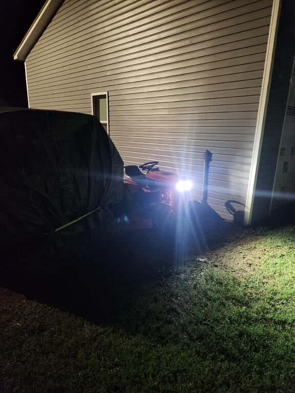

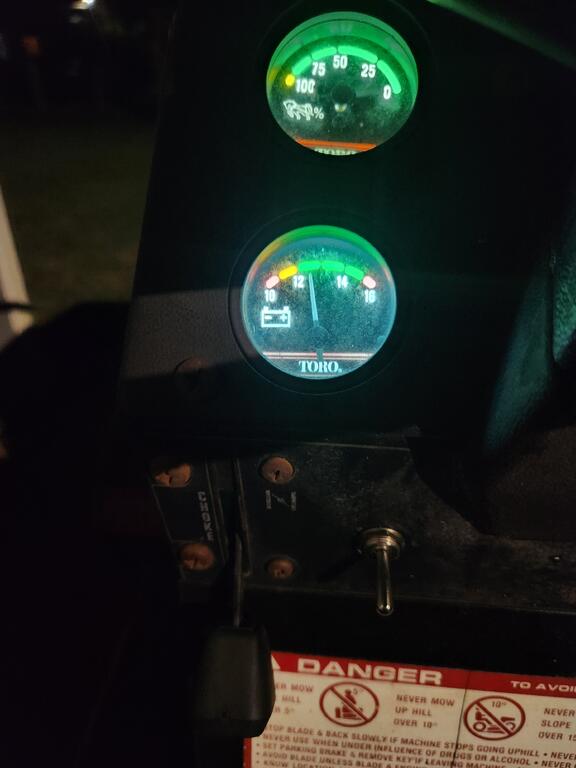

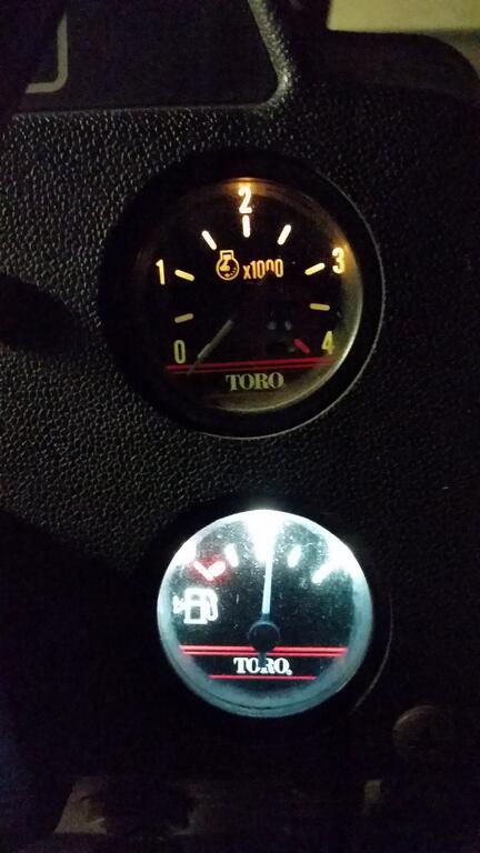

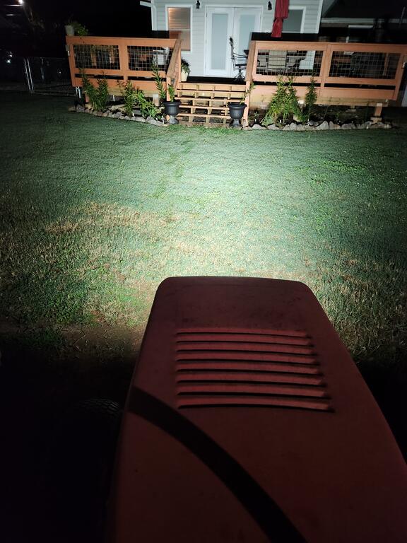

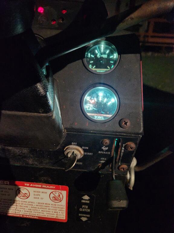

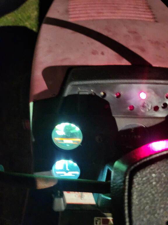

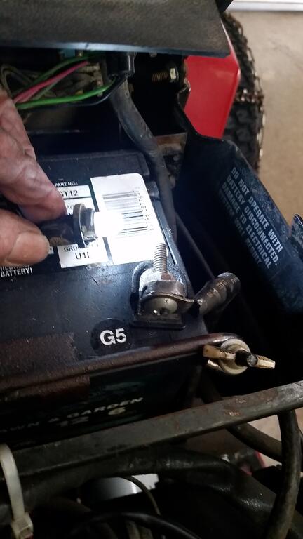

2drxploder 127 #1 Posted September 21, 2024 as usaual my 9 pin was shot. replaced it with 2 weather pack 4 and 5 pin 30 amp connectors, w/ pigtails, soldered and marine grade heat shrinks. my tach, dash lights, headlights, tail lights, and charging system came back to life. who would have thought? anyways im interested in the charging circuit re-route. could some one post a link? whats the benefit? also upgraded dash and head lights to led.... super nice! 3 Share this post Link to post Share on other sites

WHX?? 50,638 #3 Posted September 21, 2024 The only charge circuit re route I know of was just to get it out of the nine pin. Maybe @cleat knows more. 6 minutes ago, 2drxploder said: also upgraded dash and head lights to led.... super nice! Pics?!?!?! 2 Share this post Link to post Share on other sites
2drxploder 127 #4 Posted September 21, 2024 11 minutes ago, WHX?? said: The only charge circuit re route I know of was just to get it out of the nine pin. Maybe @cleat knows more. Pics?!?!?! 6 1 Share this post Link to post Share on other sites
cleat 6,975 #5 Posted September 21, 2024 28 minutes ago, WHX?? said: The only charge circuit re route I know of was just to get it out of the nine pin. Maybe @cleat knows more. Pics?!?!?! The upgrade is to go to the way wheel horse did it on the early models (1988, 1989) and run the charge current directly from the regulator output to the battery cable on the starter with a 30A inline fuse for protection. Here is the wire diagram showing how it came from the factory. Wheel horse 520H wire diagram.pdf The later ( 1990 and up) models ran the charge current through the 9 pin white wire shown on the attached diagram then passes through the 30A fuse and then goes back through the 9 pin on the red wire and then on to the battery cable at the starter. Later model 520 wire diagram.pdf I believe that is why the newer 520's and I believe the 416's have many more 9 pin issues than the 1988 and 1989 models. 2 1 1 Share this post Link to post Share on other sites

WHX?? 50,638 #13 Posted September 21, 2024 (edited) 9 hours ago, Horse Newbie said: Can you post the brand, where bought, part number for the led dash lights please ? Super bright leds Newbs ... BA 9,,, is where I got mine. Trouble is such a selection to choose from https://www.superbrightleds.com/led-light-bulbs-universal-finder/ba9s-led-bulb-1-led-ba9s-retrofit-classic-car-bulb-ba9s-x-xvac-car+volts-12V~ACDC Edited September 21, 2024 by WHX?? 2 Share this post Link to post Share on other sites
Horse Newbie 7,195 #14 Posted September 22, 2024 Thank you kindly… Did you get the Cool (6000 K), or the Warm (2700 K). ? 1 Share this post Link to post Share on other sites
2drxploder 127 #15 Posted September 22, 2024 Amazon dash lights: BA9S BA9 1895 1891 53 57 47830 64111 3893 LED Bulb White, Super Bright Canbus Error Free 12 Volt Replacements for Interior Dome Map Lamp License Plate Glove Box Lights (Pack of 10) headlights: Round 18W Agriculture LED Work Light,Par 36 LED Light Replace 4410, 4411 Sealed Beam, Tractor LED Compatible with Allis Chalmers Ford International John Deere Case Tractor Flood 12V 1 Share this post Link to post Share on other sites
WHX?? 50,638 #16 Posted September 23, 2024 9 hours ago, Horse Newbie said: Thank you kindly… Did you get the Cool (6000 K), or the Warm (2700 K). ? Who Me Neubs? ... 6K 1 Share this post Link to post Share on other sites
Horse Newbie 7,195 #17 Posted September 24, 2024 On 9/22/2024 at 9:53 PM, WHX?? said: Who Me Neubs? ... 6K Nah, was asking @2drxploder, but hey, I don’t mind who responds trying to help. Share this post Link to post Share on other sites
2drxploder 127 #18 Posted September 24, 2024 6k here too 1 Share this post Link to post Share on other sites
