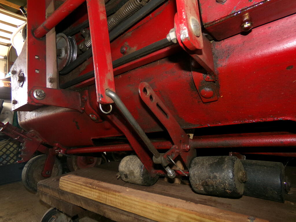

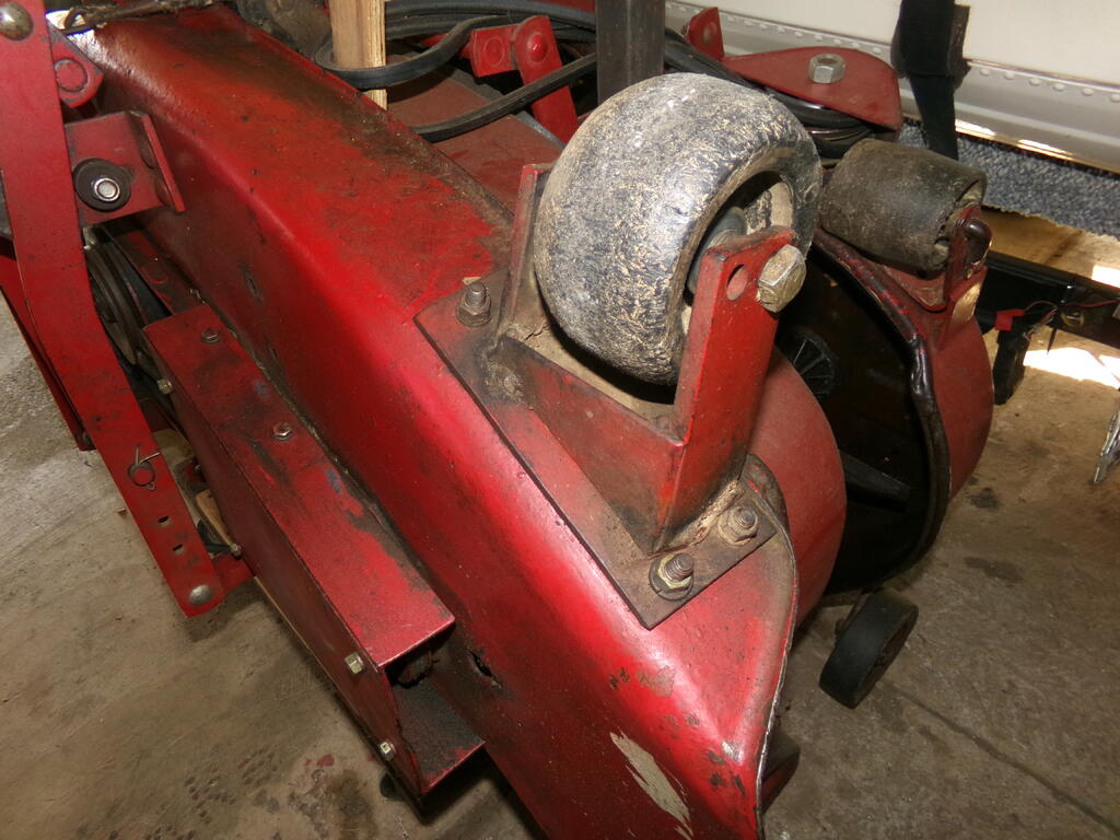

Ed Kennell 40,455 #2 Posted September 20, 2024 I converted several decks including this 48" SD. Simple, just attach the support frame to the attach-a-matic and the lift bar. Then position the deck under the support frame and drilll the holes. Here is a pic of how I attached the front to rear leveling rod. I also added two more anti scalp rollers as this deck only had one centered roller. 7 Share this post Link to post Share on other sites

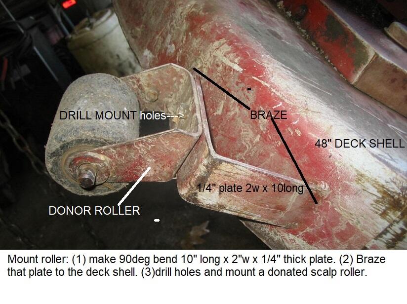

daveoman1966 3,807 #3 Posted September 20, 2024 This is what I did to mount a side Anti-Scalp roller. You could do this on both sides. 1 Share this post Link to post Share on other sites
