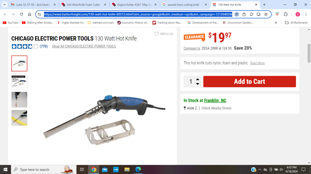

953 nut 63,003 #5 Posted September 18, 2024 Harbor Freight has what you need for $ 20.00 https://www.harborfreight.com/130-watt-hot-knife-60313.html?utm_source=google&utm_medium=cpc&utm_campaign=12126402660&campaignid=12126402660&utm_content=118355012153&adsetid=118355012153&product=60313&store=3234&gad_source=1&gclid=Cj0KCQjw9Km3BhDjARIsAGUb4nwDgAaCc2ft3A9StZjFMSGqqrWReKHVzerruF8JI9s7iL9pOJcWZmsaAvJ7EALw_wcB 2 Share this post Link to post Share on other sites
