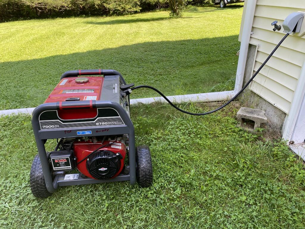

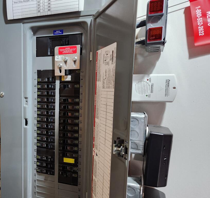

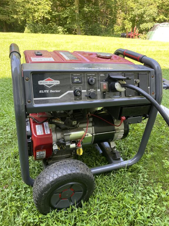

Sparky-(Admin) 22,036 #4 Posted September 18, 2024 I have a Briggs & Stratton brand that’s about 13 years old that has treated me well. Tank is always full or close to it with E-free fuel. Electric and pull start. Mine feeds a 200amp whole house transfer switch so I have everything in a power outage. Share this post Link to post Share on other sites

8ntruck 7,375 #10 Posted September 18, 2024 My wife's parents had a set up installed quitesome time ago. They were using g a portable manual start generator - which my brother in law now has. There was an outlet (inlet?) Installed outside the house that back fed through a 2 pole 30 amp breaker. No interlock to prevent back feeding into the power line to the house - had to throw the main breaker before connecting the generator. This system probably is not up to current code. Later, after my mother in law went onto an oxygen concentrator, they installed a Generac whole house, propane powered unit with an automatic transfer switch. Runs the whole house, but the central air conditioner sure makes the V twin in it grunt when it turns on. I'll typically turn the air off when the Generac is running. The old generator connection point is now an outlet for my welder. 1 Share this post Link to post Share on other sites
