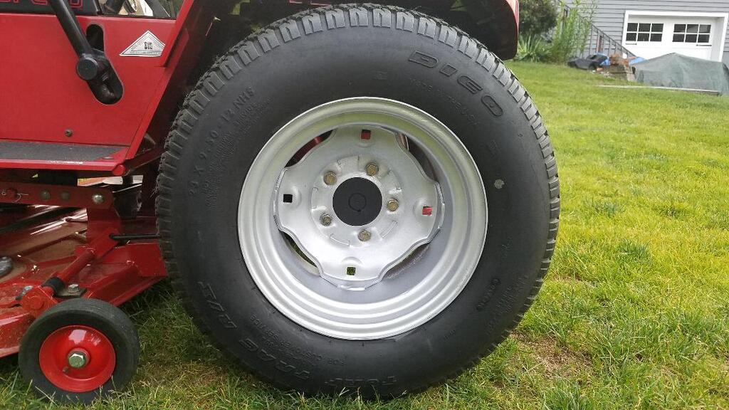

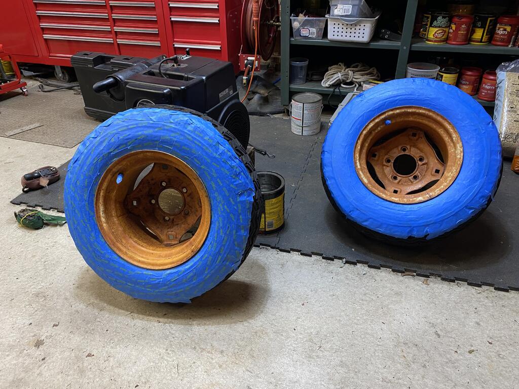

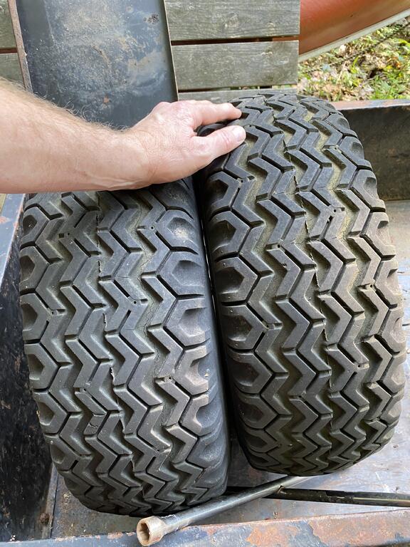

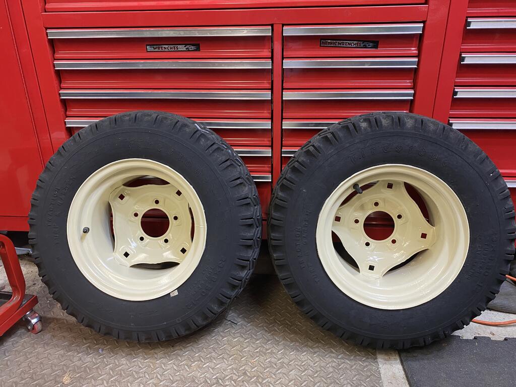

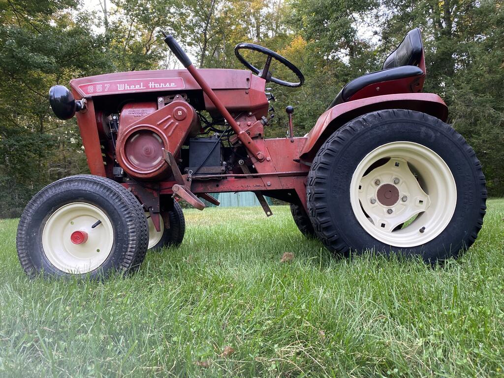

Sparky-(Admin) 22,002 #1 Posted September 17, 2024 The 857 I picked up this summer had 23x10.5 rear rubber that just looked to wide to me. Got these from my neighbors collection (thanks @Docwheelhorse) in a 23x8.5x12 size. Primed and painted . Used Rustoleum “rattle can” Cottage White 8 6 Share this post Link to post Share on other sites

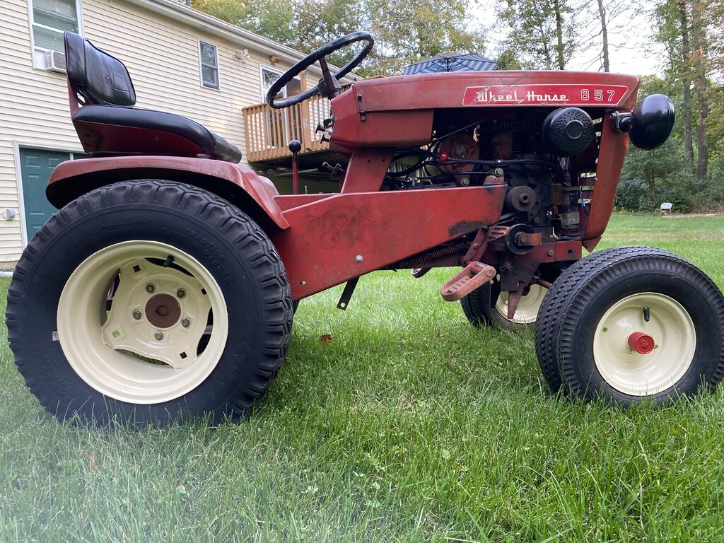

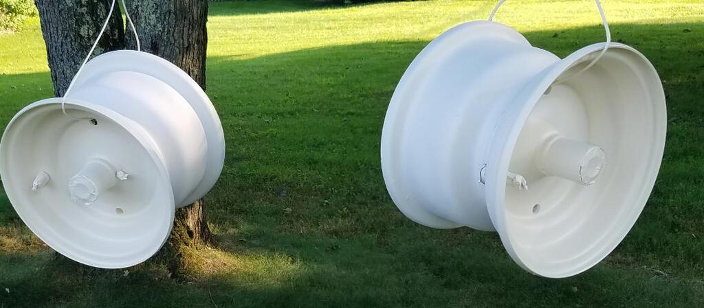

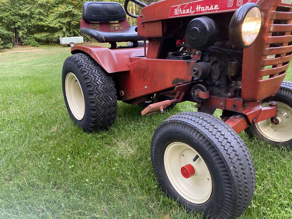

Sparky-(Admin) 22,002 #2 Posted September 17, 2024 And mounted up. 4 9 Share this post Link to post Share on other sites
ebinmaine 70,537 #3 Posted September 17, 2024 Niiiiice!!! 1 Share this post Link to post Share on other sites
ri702bill 8,940 #4 Posted September 17, 2024 What about the paint prep?? The results look great... 1 1 Share this post Link to post Share on other sites
kpinnc 13,656 #5 Posted September 18, 2024 3 hours ago, Sparky said: And mounted up. Amazing how much painting your wheels spruces up these little tractors. Looks great Mike! 1 1 Share this post Link to post Share on other sites
JimSraj 479 #6 Posted September 18, 2024 3 hours ago, ri702bill said: What about the paint prep?? The results look great... Yeah that! 1 Share this post Link to post Share on other sites

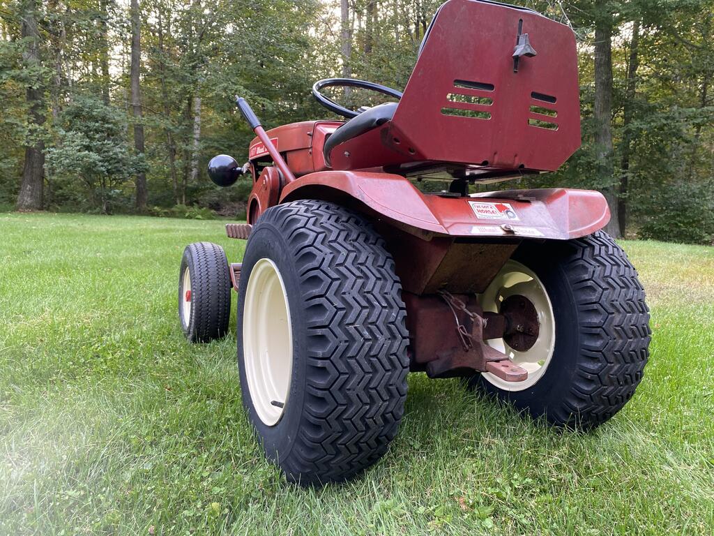

Brockport Bill 1,821 #7 Posted September 18, 2024 Your rims look great !!!! Painting rims makes the look of tractor 100 percent better 6 1 Share this post Link to post Share on other sites

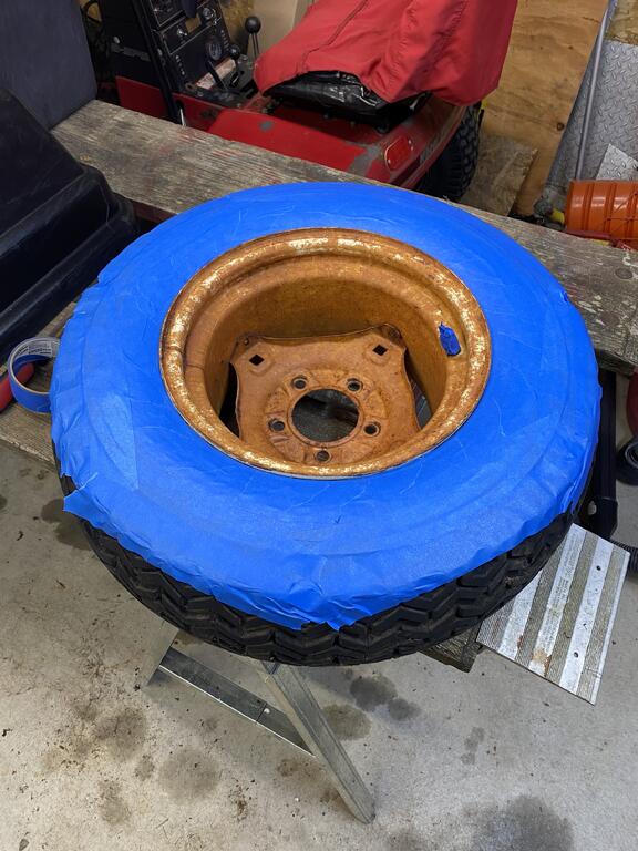

ri702bill 8,940 #9 Posted September 18, 2024 6 hours ago, JimSraj said: Yeah that! I saw the masked wheels, what about the surface & chemical prep used?? 1 Share this post Link to post Share on other sites

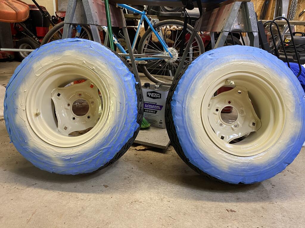

Pullstart 64,435 #10 Posted September 18, 2024 Ain’t nothing fourteen rolls of masking tape and three rattle cans can’t fix Looks great! 2 4 Share this post Link to post Share on other sites

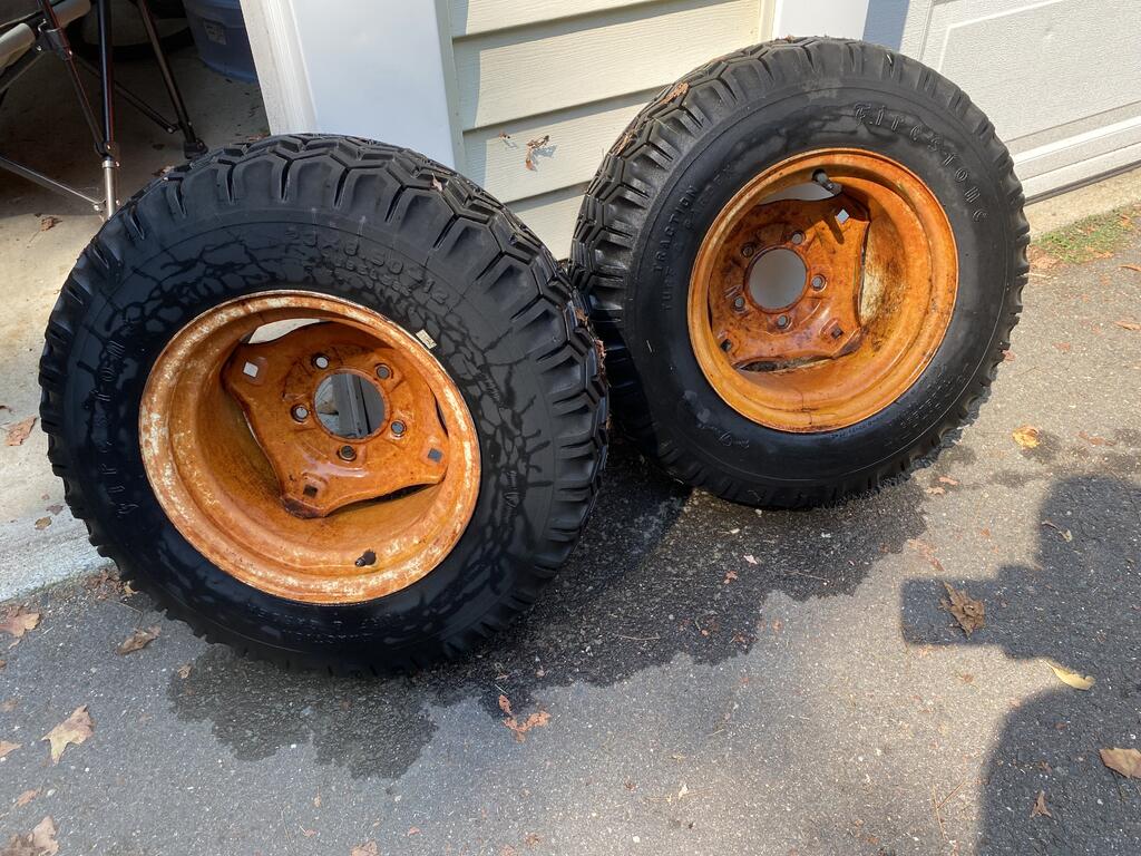

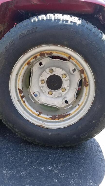

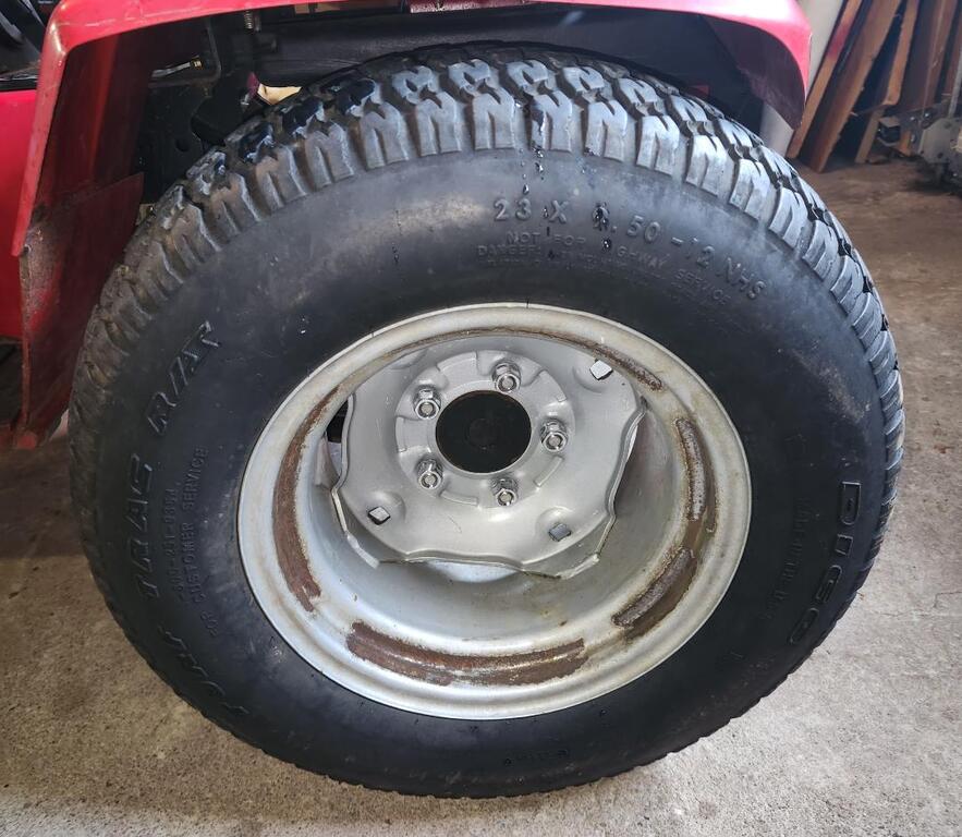

Sparky-(Admin) 22,002 #11 Posted September 18, 2024 Paint prep was fairly easy. Hard scrubbing to get em clean and grease free. Then a light sanding…that’s it! Don’t be fooled by the before pics, these were not as rusty as they appear in the pics. No scaly rust and no pitting to deal with. 4 1 Share this post Link to post Share on other sites
Brockport Bill 1,821 #12 Posted September 18, 2024 3 hours ago, Sparky said: Paint prep was fairly easy. Hard scrubbing to get em clean and grease free. Then a light sanding…that’s it! Don’t be fooled by the before pics, these were not as rusty as they appear in the pics. No scaly rust and no pitting to deal with. when I have done larger rear rims to clean i have used the 90 degree angle grinder with 4 1/2 inch sanding sponge pad but of course due to size its limited manuverability - - so then i use the mini ingersol air grinder with the small 2 inch pads - - then also to get into the creases of rims i use the air Needle scaler which is nice for hard to reach joint creases that get the rust - - then naturally revert to hand sanding as necessary --- the combo of tools does the job to get rims pretty rust clean -- then prime and paint with cans -- overall they usuually look pretty good when done 2 Share this post Link to post Share on other sites

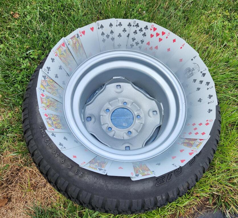

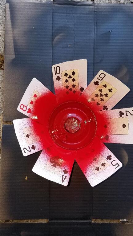

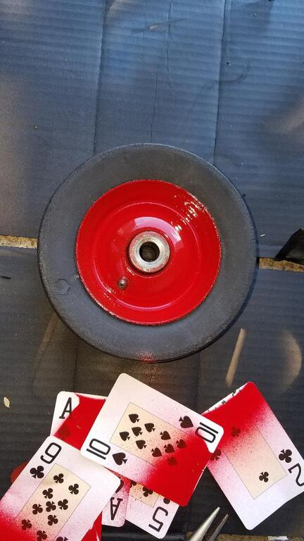

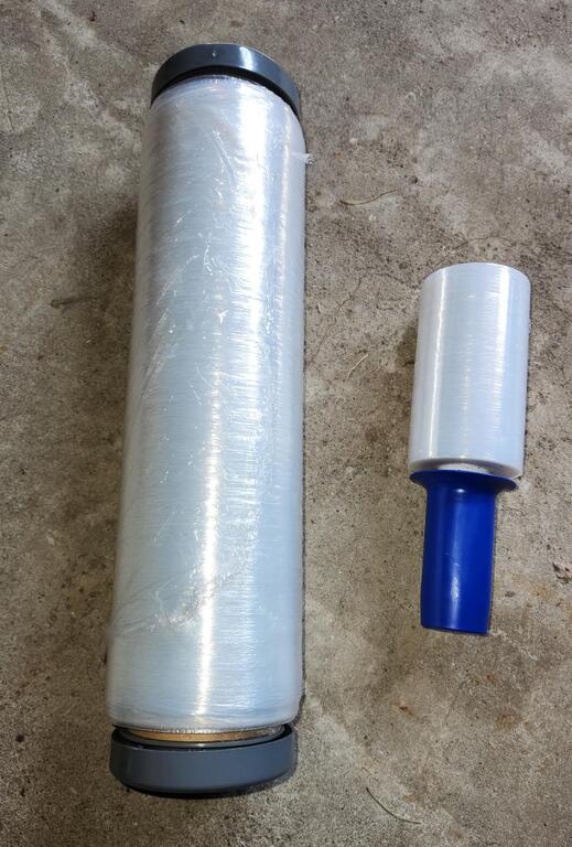

Brockport Bill 1,821 #13 Posted September 18, 2024 using the player cards has worked well generally to protect the tires from over spray -- i have used the blue tape, or even the stick on saran type wrapping material a couple times, but overall just deflating the tire and sticking in the playing cards is pretty efficient - - of course the easiest painting is when the tires are off the rims -- haha 2 1 Share this post Link to post Share on other sites
squonk 42,450 #14 Posted September 18, 2024 11 hours ago, Pullstart said: Ain’t nothing fourteen rolls of masking tape and three rattle cans can’t fix Looks great! Lowes closed the store and had a party for the employees with the profit margin they made after Sparks left the store. 5 Share this post Link to post Share on other sites

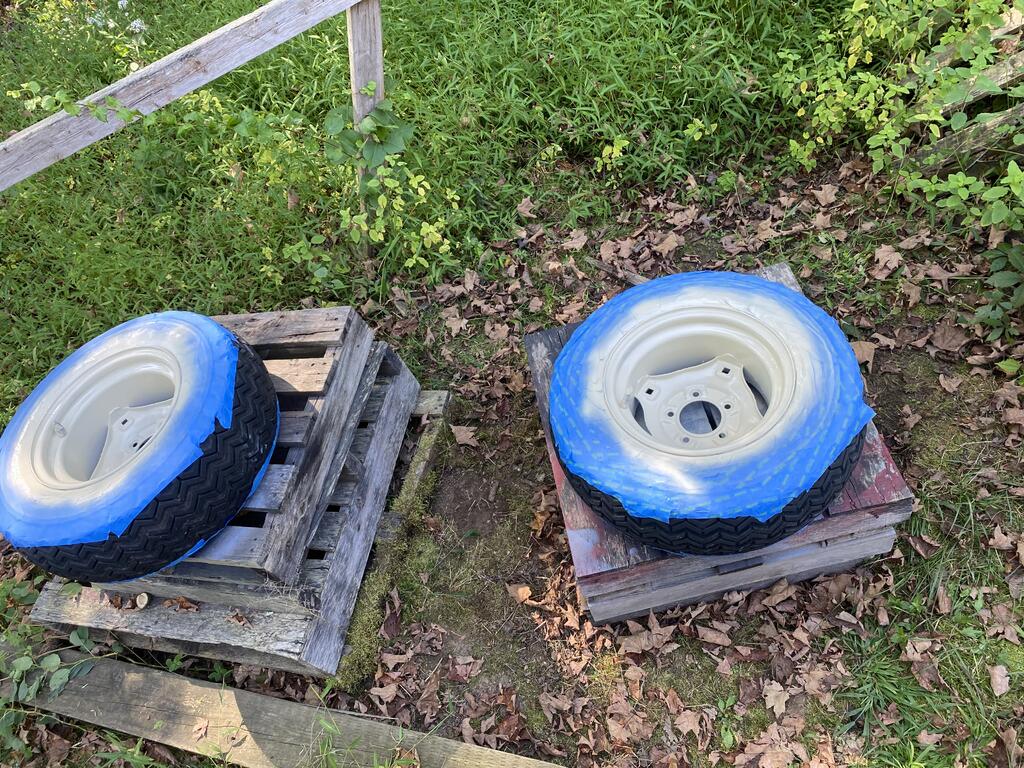

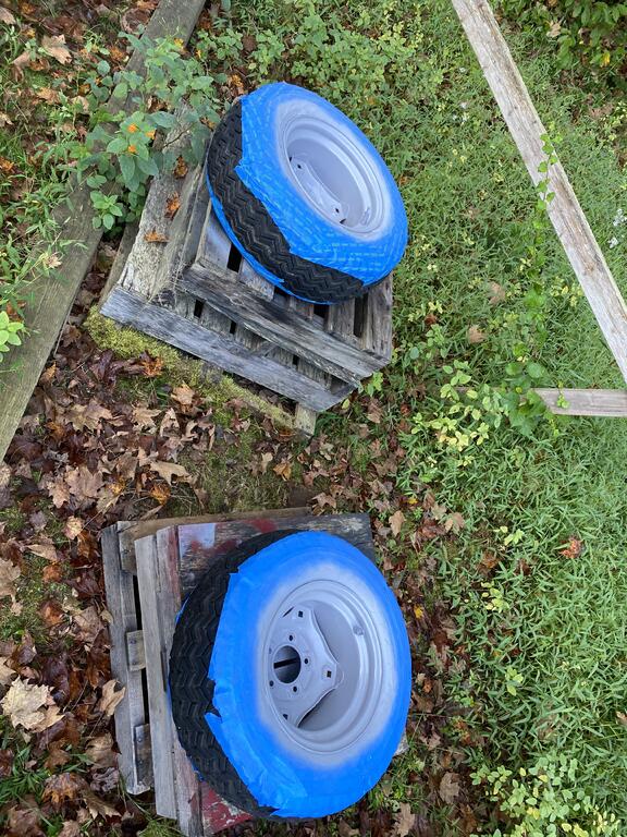

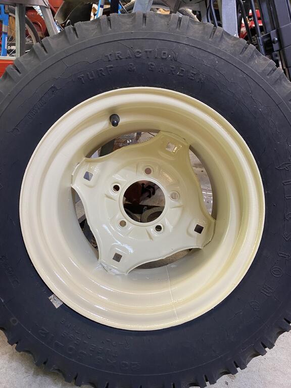

Sparky-(Admin) 22,002 #15 Posted September 19, 2024 I don’t think the playing card method would work for me. I mask off the front and back and then flip the wheel over on a pallet painting both the inside and outside in primer and then after I do a couple coats of the finish paint, flipping the wheel/tire over each time. The cards stick up and would have to be removed and installed numerous times whereas I mask off once and away I go priming and painting. 1 1 Share this post Link to post Share on other sites

Brockport Bill 1,821 #18 Posted September 19, 2024 Sparky: Your masking tape approach makes lots of sense for the efficiency of time for flipping tires for the primer and the top coat --- I've used various methods -- one thing i did discover when i do the tape method is to buy the wider tape because i used to buy the narrow role but the wider certainly covers more surface with less labor applying it 1 1 Share this post Link to post Share on other sites
Brockport Bill 1,821 #19 Posted September 19, 2024 as an alternative to using masking painters tape for the tire/rim painting projects, here are some of the rolls of the sticky "saran" wrap type packing material that can be used -- easy to apply and fit onto tires - different widths can cover lots of surface 2 Share this post Link to post Share on other sites
