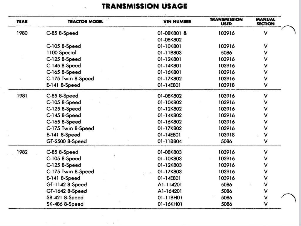

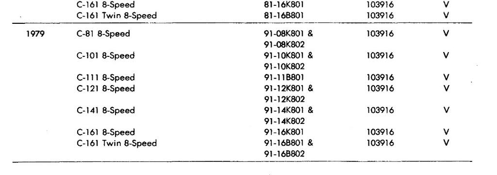

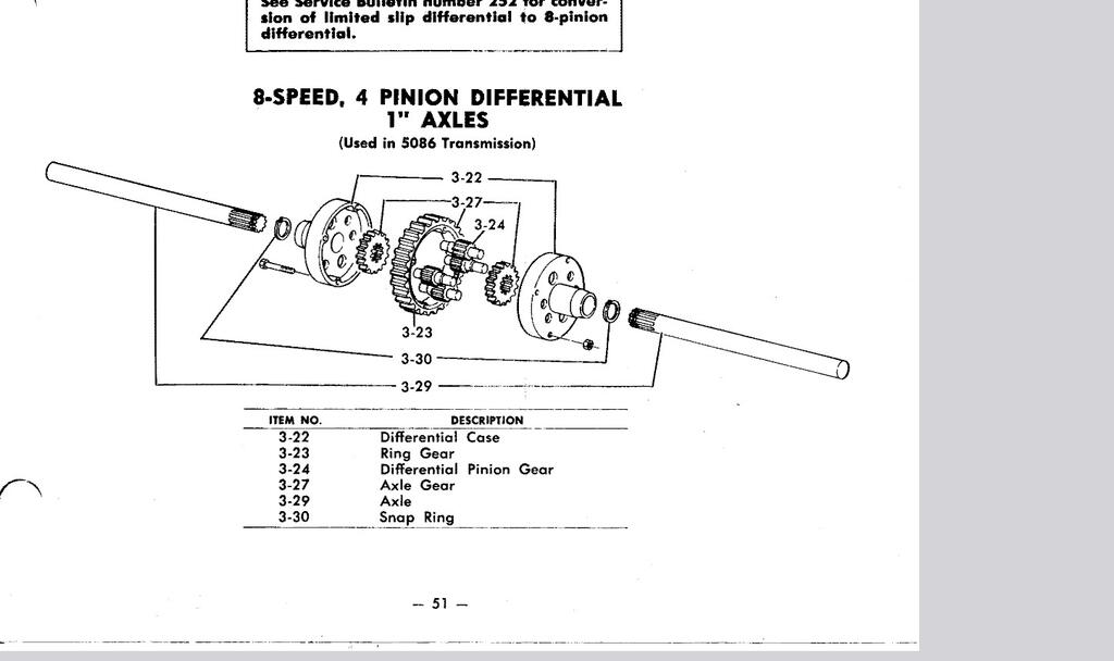

Inrteresting engine may not have been the only thing swapped out.  Tranny manual shows 103916 for a c-161 Briggs twin.  (1-1/8" 8 pinion)
5086 is 1" 4 pinion used in several other models...
  I have never broken any WH gear tranny...
Measure you axles....
