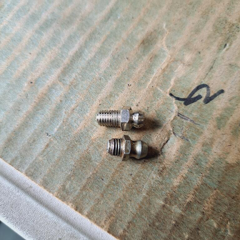

hotajax 225 #1 Posted September 13, 2024 On my OEM wheels, a straight zerk is threaded into the hub. Just curious - how is the drill and tap held at a 45-degree angle during the drill and tap process? Share this post Link to post Share on other sites

hotajax 225 #4 Posted September 13, 2024 Yeah, I know about the 45-degree and 68--degree elbows. But I wanted to know how to hold that angle while drilling and tapping. 1 Share this post Link to post Share on other sites

WHX?? 49,847 #8 Posted September 13, 2024 I know what He's talkin about. I think he's tryin to put them in rims that don't have zerks. Had to re-tap many and yes you can't get a tap wrench or drill in there. I just use a small wrench and a 1/4 turn or so is all you get so slow but works. Learned not to take them out unless absolutely necessary. If you are using rims that don't' have them just use sealed bearings. Many of use have just gone to not greasing. Re-grease per greasy pete tho. 1/4-28 is the tap size. 1 hour ago, wallfish said: the threads on them aren't very long. They are available in long thread. Share this post Link to post Share on other sites

953 nut 56,685 #10 Posted September 13, 2024 If you have a drill press I would suggest you start a pilot hole at ninety degrees to center the bit then clamp the wheel to your drill's bed, tilt it to forty-five degrees and drill into the pilot hole. Share this post Link to post Share on other sites
wallfish 17,163 #11 Posted September 14, 2024 2 hours ago, WHX?? said: If you are using rims that don't' have them just use sealed bearings. Absolutely !!! This is the solution even with grease zerks in place. 2 hours ago, WHX?? said: They are available in long thread. Do you still think you would want that thing on an angle into a 45 deg hole? Plus that rim metal is thin Share this post Link to post Share on other sites
hotajax 225 #12 Posted September 14, 2024 9 hours ago, wallfish said: Why would you want to drill and tap them on a 45 deg angle? It probably wouldn't work for a grease zerk anyway since the threads on them aren't very long. Plus it could easily get knocked off too That's the way the OEM wheel was configured. I thot about putting in a 45, but i can't get the clearance to drill and tap on that small wheel. Not much room to work. I can't even get in there with a grease gun on a straight zerk. Thanks Share this post Link to post Share on other sites

moe1965 750 #14 Posted September 14, 2024 If held in place at a 45 degree angle in a vice use a center drill to start your hole then you can drill with the correct drill for a tap. Can be done on a bridge port. Drill and power tap. A machine shop should be able to help you out. Share this post Link to post Share on other sites
wallfish 17,163 #15 Posted September 14, 2024 10 hours ago, hotajax said: That's the way the OEM wheel was configured. I thot about putting in a 45, but i can't get the clearance to drill and tap on that small wheel. Not much room to work. I can't even get in there with a grease gun on a straight zerk. Thanks Why isn't just using sealed bearings an option? No greasing and no zerks. All of that extra grease in there does is make a big mess if the wheel ever needs to be removed. Yes it's simple to give the bearings a quick squirt with zerks in place but then again you don't need to do anything with sealed bearings. Share this post Link to post Share on other sites
